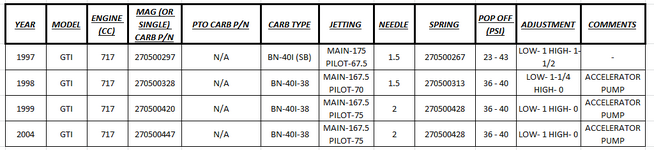

I have a 97 GTI and it had the same exact issue. I never got the issue fixed before the top airbox lug broke due to the carb to head support not fitting well. To me it looks like SeaDoo knew there was a problem and they worked on in subsequent years. In 98 they went with a bigger pilot, more low speed screw and an accelerator pump. I bought a replacement carb and it is the 99 version. I also corrected the bend angles on the support bracket. Runs flawlessly.
Turned the low speed screw 1/8 turn in. Idles a little different but idles fine. Runs like a scalded dog.,! Thanks guys you are nothing short of awesome!!! I would have torn back into the carb
