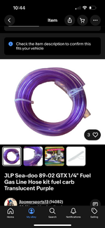

Delrin wear ring from OSD marine. You don’t need a Solas unless yours is damaged. Curious what type of fuel like you ordered?
You don't want that fuel like as it will get hard and brittle quickly.
Just get standard 1/4" black automotive fuel hose, Gates is a good brand.
I was going to mention that, but then had decided not to, I did a little research on that fuel hose. It’s made of polypropylene which according to AI is even worse than polyurethane fuel hose. Besides possibly leaning out the machine due to leaking fittings I wouldn’t want to the expense of changing those out annually or the worry of fumes in the hull.

Buying fuel line to get a particular color is not necessarily a good Idea. The Moderators know what they are talking about when they are talking about fuel line quality. Translucent lines are not as good as solid color lines. But I wouldn't let that stop you from using it. Clear lines are a diagnostic gold mine. You can literally rule out everything from the carb inlet to the fuel tank in about 10 seconds when you are chasing a lean condition....just watch for bubbles entering the carb. If you have bubbles you have a problem. If you do use it, here is what you need to know. They will likely get hard and cloudy. Always clip the ends before reusing them. Use 2 zip ties per fitting that are specifically made for fuel line, I always watch the line going into the carb on cold start ups...it will show you if and/or where the system is leaking even if it is the lines. You can't do that with black lines.
