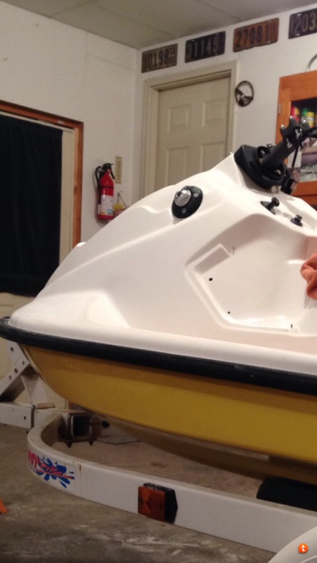

Just be very careful, I couldn't believe what I was about to do. Use it wet, I use a home depot spray bottle and was constantly spraying. Just for instance if you look under the storage cover(hood), you'll sell some letters that are raised, on the HX they're under the seat near the shock boot. I sanded mine out, so be very careful. Just go to the poor where the staining is just gone. The hull should just buff out without sanding. Oh, very light pressure cause you don't want to dig an edge in. Be careful.

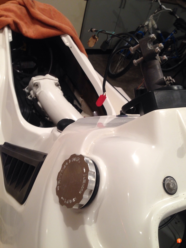

Here's a few billet goodies that will be going on once the hulls all wetsanded and buffed out: billet fuel selector, and billet triton gas cap
That gas cap is sick!!! Looks good on that white....If u don't mind me asking where did u get it and how much? Lol I gotta have one.

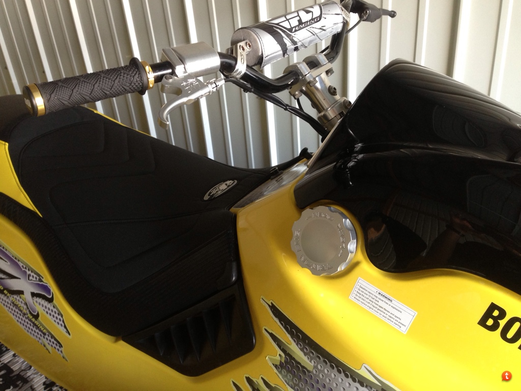

I actually have 2 of the tritons and one hot products and I found all of them all on eBay. They don't pop up too much so you kinda just have to see it at the right time lol. Here's the other triton on my 99spx
Ah I got ya, that's what I was afraid of.... That looks nice on that spx, I've seen a few on eBay as of late, but none of them look as good as that triton IMO... Just gonna have to keep my eyes peeled
Ha well here's what we'll do,I'll shoot ya a message if I find more than one and you do the same....Maybe between the both of us we can get lucky? lol

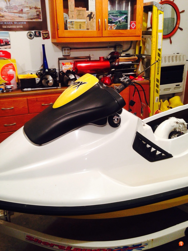

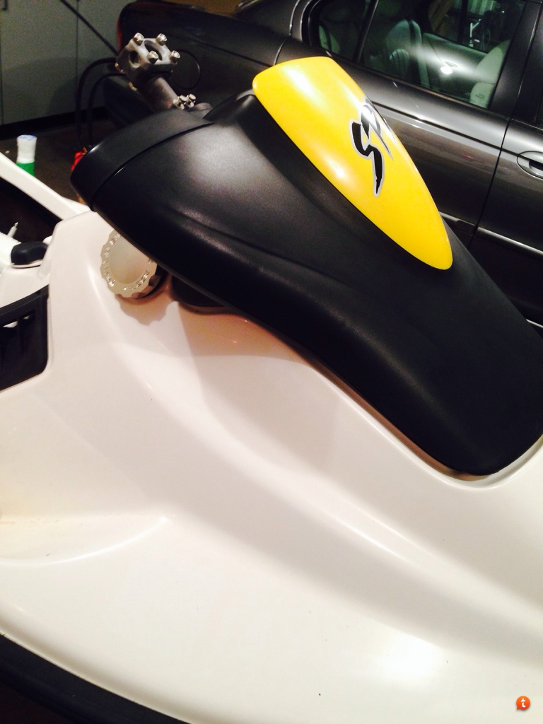

Well here's the hood that I will be running on my 97spx, this is an original off my 99spx. Some of you are probaly wondering why I took it off the 99, well I have 2 99's so I kept one orignal and put the single gauge hood on the other one. So now the 97 gets it :)

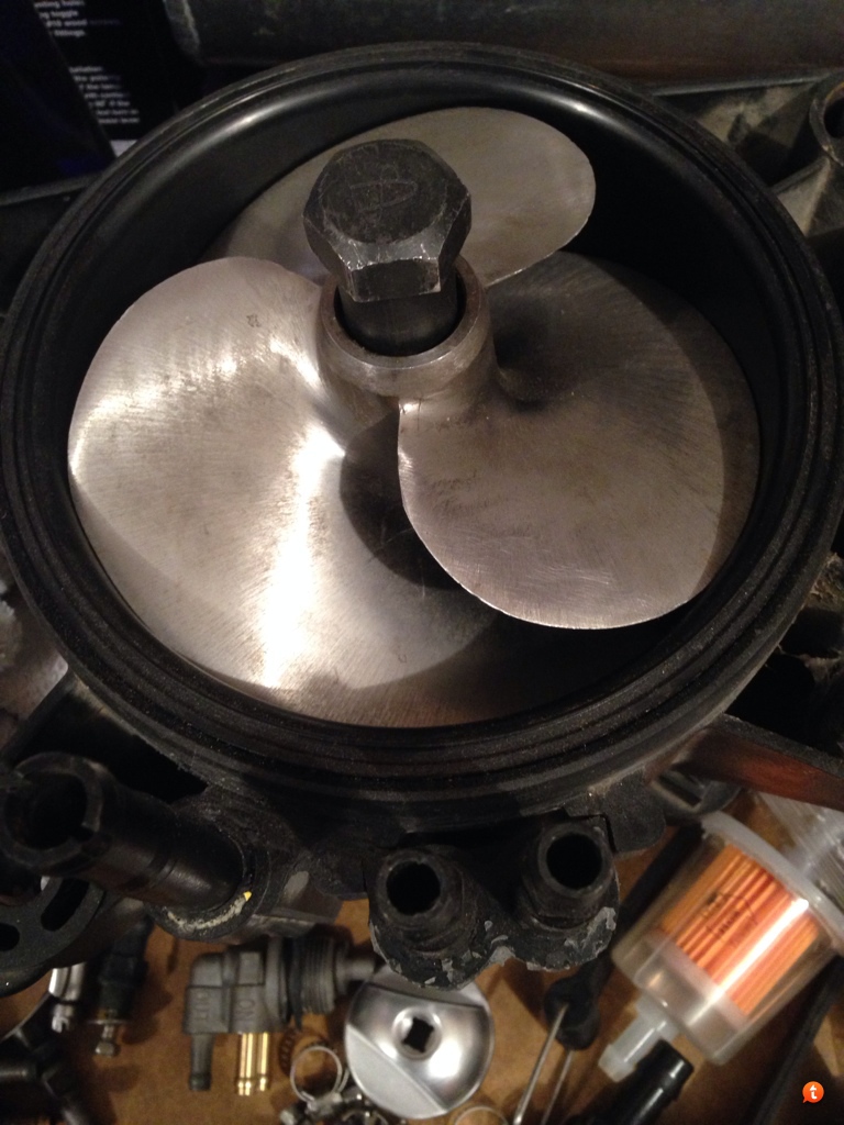

Decided to go through the pump last night: installed all new bearings, new oem wear ring, new nose cone, fresh Amsoil, and a skat 17/22 swirl. I got to use my new pop off tester to test for leaks in the pump. Pumped it up to 10psi and let it sit for 10-15 minutes and the psi didn't drop, good to go!
Next I will be going through the driveline and then the fuel system. I'll be sure to post lots of pics to show everything up close.

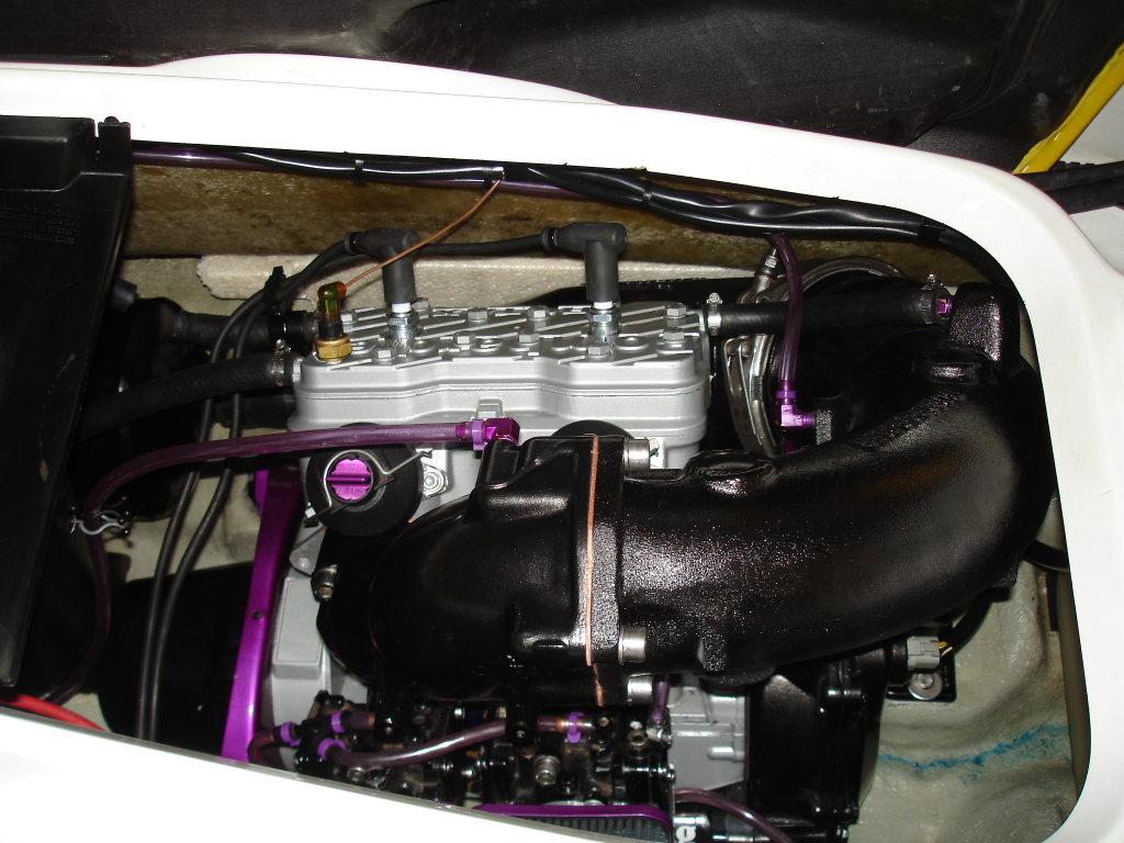

you should flip that thing and paint the bottom black. Threads like this make me seriously look for a 98/99 X4. I miss my 97 SPX, especially how pretty the motor was:
