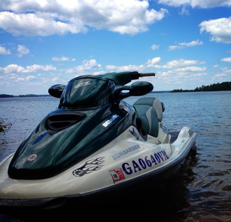

I started on this ski last week. I pulled motor and sent it off for rebuild. I had a local shop clean the carbs at the start of the season, I don't believe they did anything at all. When the motor was out the pto piston was all ate up, running lean. Pulled the carbs apart for rebuild and pto side internal filter completely clogged. While the hull is empty i cleaned the under side of the hull today and as you can see there is a lot of damage, time to read up on the best way to insure the damage doesn't get worse you can see a lot of fiberglass.
