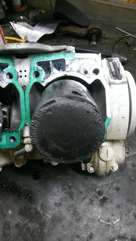

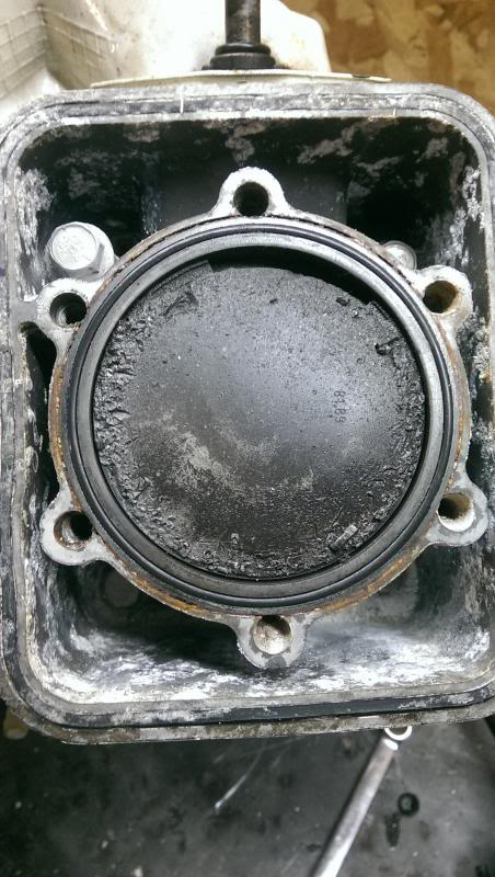

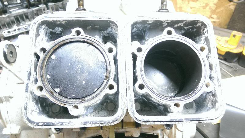

Well I'm glad I decided to pull the engine. The rear piston and cylinder are toast. I can see through the piston next to the exhaust port! I wish I could figure out how to upload pictures

It was only hydrolocked with oil. It was free once I pulled the plugs. most of the oil squirted out the front cylinder, I guess it's because the oil just went through the other piston haha. I got your message so I'll try again to get pics up when I get in the house
Possibly the ring caught the exhaust port and tore it up. From the picture it does not look like a burn hole, but more from mechanical damage.
My guess is it started burning up and the pin fell out letting the ring spin and catch on the port. It looks like a little bit o f both happened
And that's why you always check compression before you biy
I checked it on the machine he advertised as running. The one I'm working on was advertised as a parts machine so I wasn't too worried. It wasn't till I got it home that I thought of getting it running
This certainly didn't happen b/c there was too much oil. It does sorta look like maybe the ring snagged in the exhaust port judging by what looks like a broken ring land, especially if the ring is bent. The end of the ring shouldn't be exposed to the port where it can snag in the opening, the ring may have rotated if the locating pin failed.
Other things that can overheat the piston and cause it to melt is low octane from crummy or stale fuel or a lean air/fuel mixture (piston burning detonation occurs when combustion stops too early).
If the piston overheats(too much heat causes piston to expand), the oil film is in jeopardy of failing as the flash point is exceeded. Once the oil film fails, it's all over with.
Pre-ignition can break a piston or ring land as well, it's the most destructive force that can occur in a cylinder. This occurs if the fuel mixture is ignited before it's compressed, a spark plug of too hot of range can cause this or even an overheated piston.
edit: To add a little more, low compression means there will be too much blow-by. The clearance between the piston and cylinder wall plays an important part in transferring heat out of the piston crown through the rings and oil film into the cylinder wall. If there's too much clearance or the rings have collapsed, the piston temp can exceed "safe" levels and cause the oil film to fail. This is why every 2-stoke motor will eventually seize if at some point it's not rebuilt first, to compensate for normal wear, so monitor your compression often enough to catch a worn cylinder before the piston overheats.
