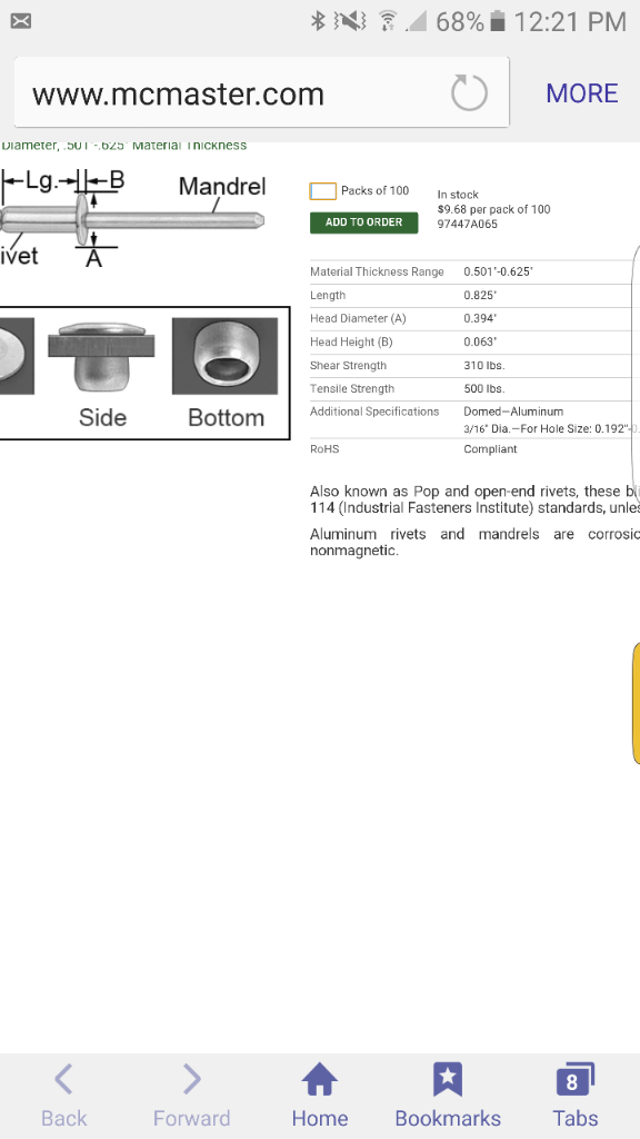

When you removed the bumper trim you had to drill out the rivets so when you reinstall will you be attaching the same way? Does anyone know the size and length of the factory rivets? Do you apply any sealer on them as well? Always wondered about that.

when you removed the bumper trim you had to drill out the rivets so when you reinstall will you be attaching the same way? Does anyone know the size and length of the factory rivets? Do you apply any sealer on them as well? Always wondered about that.
yes you drill the rivets out. You can pick them up from menards. Let me look tonight. Dont use any sealer. On the corners and the front bumper i use bolts though.
Not to de-rail the thread but could you post the part # on those as well? Very useful information!
They are both on my work bench. I will post a picture as soon as I get home tonight.
The ones I got for the trim were a little longer than the ones Ankenyou posted and for a couple of mine I wouldn't want to go any shorter. I did have to get creative on the front bumper because the hole is so small and recessed the pop rivet gun wouldn't fit in so I had to make a spacer to get the rivet in and allow the gun to actually clamp down.
Direct from McMaster Carr
The trim ones are..
0.876"-1" 1.2" 0.394" 0.063" 310 500 50 97447A072 $6.74
The little knee plastic cover ones are...
0.501"-0.625" 0.775" 0.262" 0.04" 120 150 250 97447A145 $10.07
