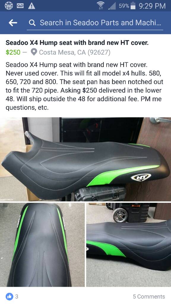

Saw this and thought of your color scheme.
Yeah, the problem is that's a hump seat with a regular non-hump cover. Wouldn't be a horrible deal of the cover was the correct one. Also not many people would have a green x4.

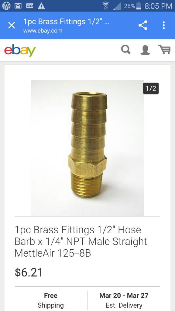

20170314_231424.jpgwhere do I get the fittings that go in my novi head...menards doesn't have them. Looks like I need 1/4 to 1/2 hose fitting
I rob them out of stock pipes. Yes I think it's 1/4" NPT to the 1/2" barb. Someone on here probably knows a reasonable source(I hope).
Just go to home depot, plumbing section they have a board with brass fittings on it. That's 1/4 npt
