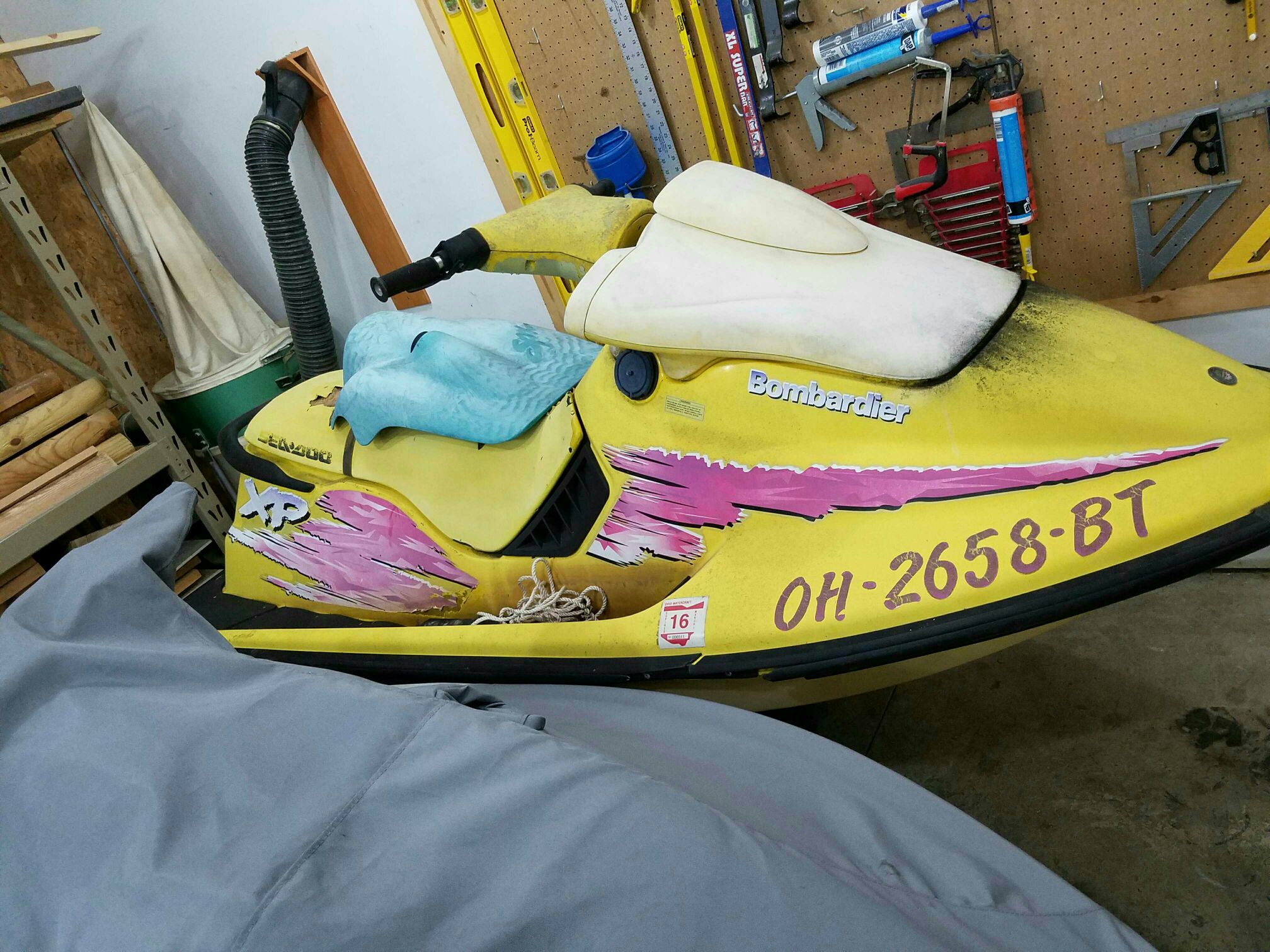

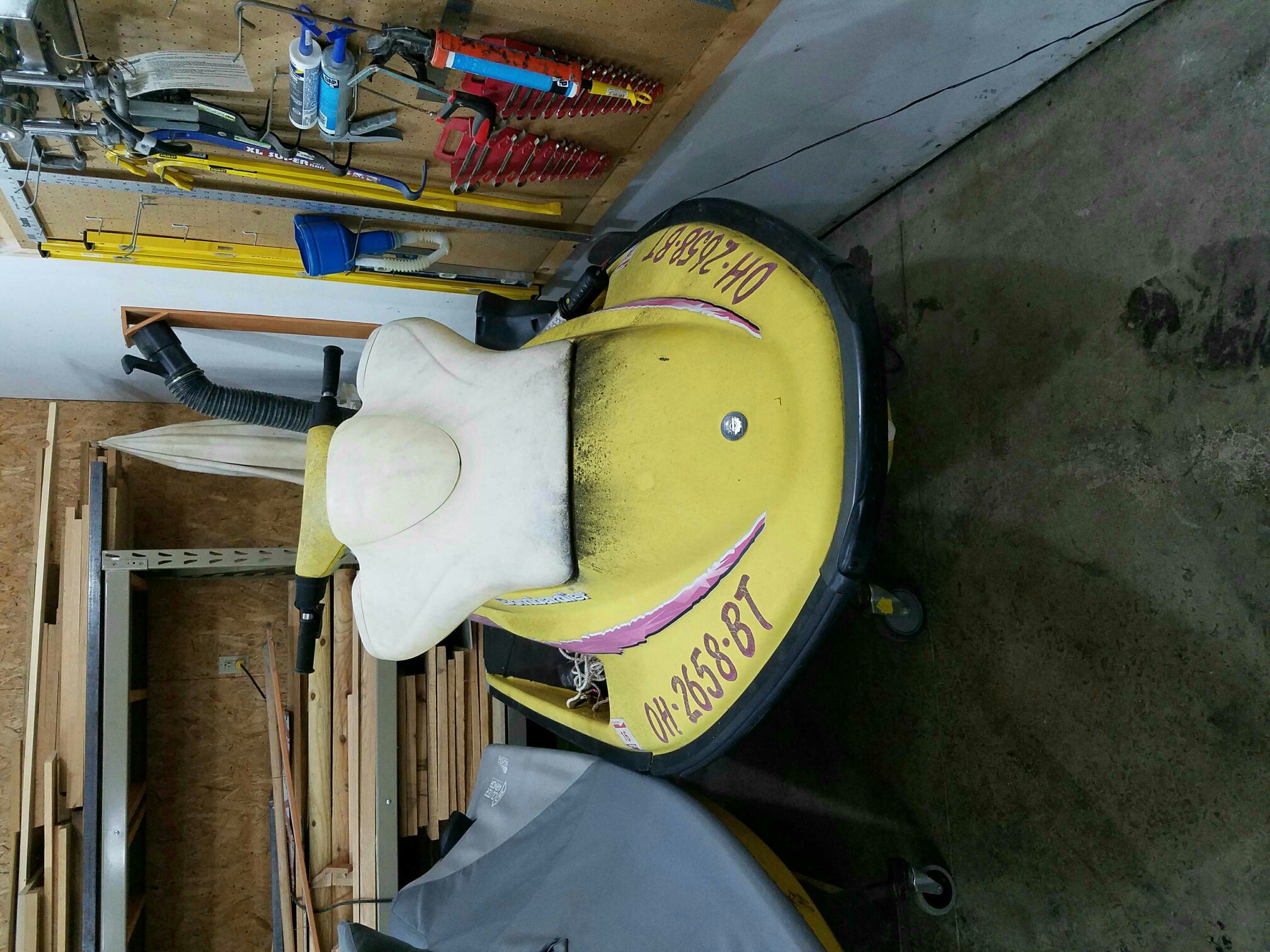

Well it's that time of year and I feel like I have so many parts sitting around I'm going to build another killer x4 I hope! I'm open for ideas but this is what I'm thinking.
Hump seat, with jet trim
Umi
Keeping VTS with umi holder
Finger throttle
Egt temp sensors
GPS speed
Black tip mats
Single gauge hood
44 west coast carbs.
R d nozzle
Solas prop
Factory spec 2 pipe
West side power sports hose kits
Need a intake gate...
Going to make sponsons
Gel coating the bottom black and paint the top silver
I'm sure I'm missing stuff lol...I'll post some pics tonight. So here's to some seadoo fun over winter!!

Well I know this has started out slow, but it will pick up here. Im working on my "hunny do list" right now lol. As far as the ski goes i should have some work done this weekend. I'm still looking for some parts though. What kinda intake gate would you guys run? I'm not 100% on what way to do.
worx in my opinion they fit nice. I used a cheap solace one on a hx I built it fit like crap it left a big edge wher it bolted to the pump. those are the only brands I have used. so I think anything but a solace I wouldn't waist my money on one again.
