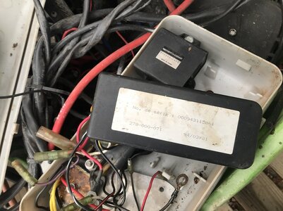

I have a 1995 GTS with some weird issue. bought it as a project cheap got it running took it out to test it and ran great for 15 minutes then started stalling with 2 beeps after 5-8 seconds. I did some testing and found found it will run great with the black and red wire unhooked. had a spare MPEM similar issue but it came with it so I ordered a new one. put the new one in and shortly after same issue. Cylinder head temp sensor checks out okay. Tried a known good voltage regulator because I had a spare. Kill switch operates as it should. have the black/red wire on a toggle switch just to test it and had it out for 3 hours of riding and sometimes going to start it i have to pull the 5amp fuse and reinstall otherwise i have no power anywhere. Is there anything i am missing before i throw a stator in it?
