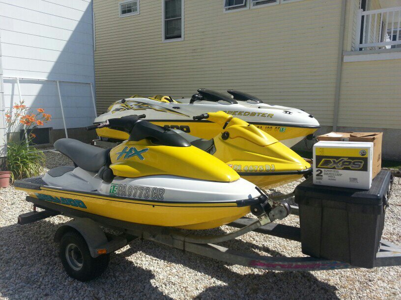

Dan - Amazing as expected :). It looks like you have a fleet at the homestead....how many skis do you have? Also, are the rub rails original? If so what's the secret? Mine have a few minor scratches plus fading on the stern corner rails.
Thanks buddy. It's really cool putting it together, I feel like I'm assembling the first one it's just wicked cool. I have 6 skis plus my Speedster here, plus my very first 2 skis at my parents place. I actually should have answered that with "Too many". I also have 2 sleds and another 2 disassembled and stored up stairs in the attic, LOL--I have way to much crap.

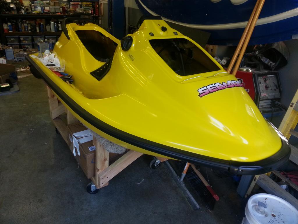

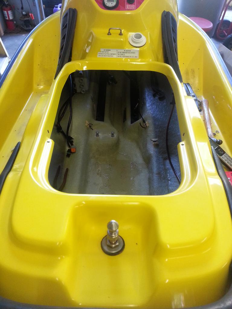

Yes those rub rails are original and they felt like 100 grit sand paper. The secret is paper towels and lacquer thinner. It will just melt the "crust" off them and make em' smooth as glass. The you can hit them with peanut butter to polish them up a little bit. The corner is new old stock and I have another one coming if I remember correctly--I've ordered a bunch in the last week I can't even remember.

WARNING DO NOT USE THE CROWN BRAND LACQUER THINNER
I just touched up a rub rail and it turned gray, it's ruined. Have to clean an entirely new strip. I was at Lowes the other day and knew I was low on LT so I bought their Crown brand. Glad to know I just pissed away $18. Back to the Home Depot where you can buy decent supplies. ONLY USE KLEAN STRIP Lacquer thinner. Mother F'er I'm pissed.

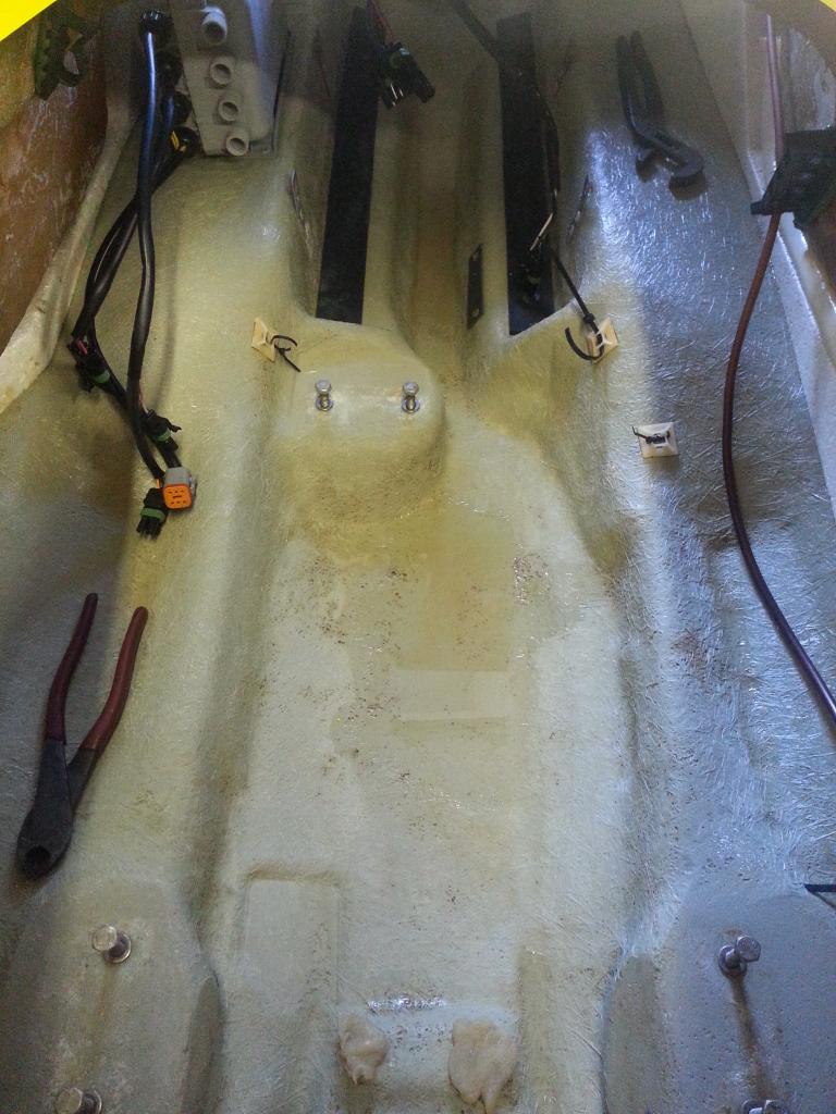

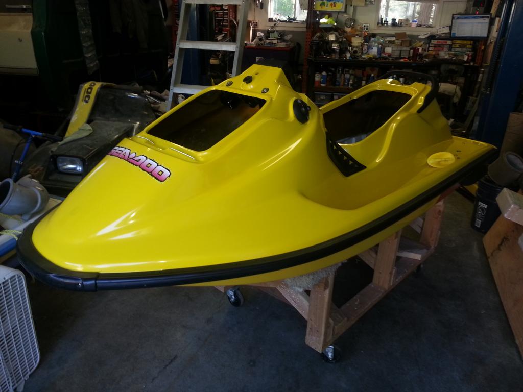

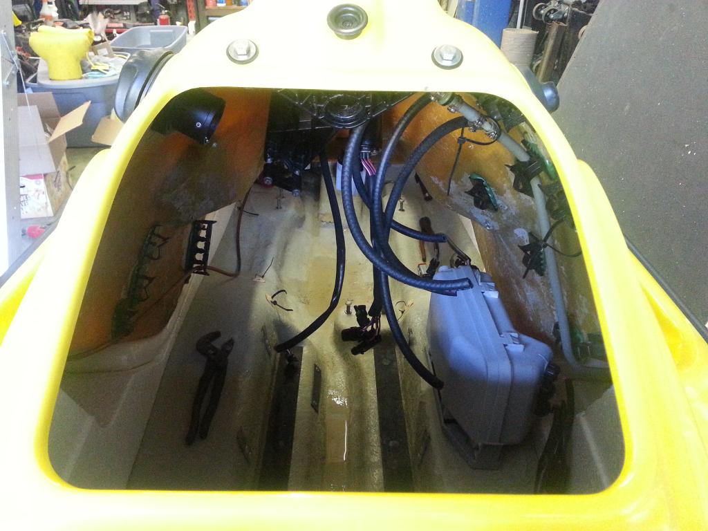

Rub rails are on except one corner. Fuel filler, fuel selector is on, new fuel separator, some of the fuel line, front e-box. steering is partially installed. Got an NOS correct steering cable coming in, cost $10 more than SBT's BEFORE shipping. Mine shipped in for free--osdparts.com is the hook up. My cable was a bit jerky and the end was a little wadded out. I actually had to cut it on the inside of the hull with bolt cutters, then break it down, then drill it out so it was close to the transom, then beat it out with a drift and a 3# sledge. What a mother. I had another one in one of my other 95 limited hulls but figured that wouldn't go much better.
Still haven't touched the engine or carbs yet.
Sorry for the grainy pics, I forgot to wipe the lens off on my phone.
This is more good'r now!
All of this work and you're going to cheese out and not replace the gray vent line with black line so it matches?!?! Ha bustin your balls, but seriously lol
I probably will, but I need the vent grommet by the latch and the one for the side of the hull before I can do it.
If you go factory graphics you MIGHT rival mpower with this one.
Yes, factory graphics are going back on. I secured NOS decals and hand traced (with a little help from Falksland) the rear to get the sizing 100% for Mike to perfect the graphics for the 95 XP800's and the coloring will be dead on and the sizing too. Mpower's ski was very inspirational for my ski and a supurb resto.

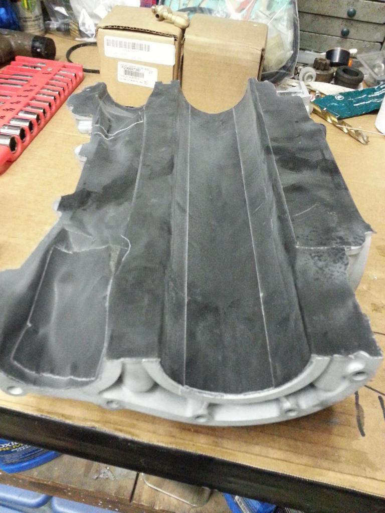

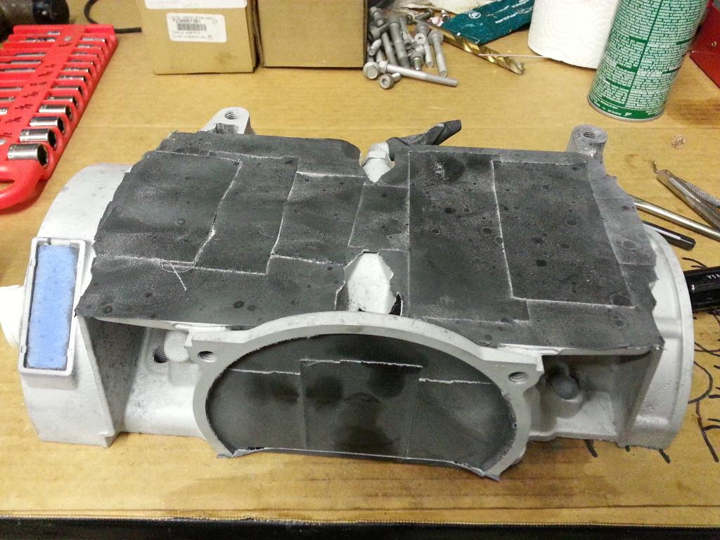

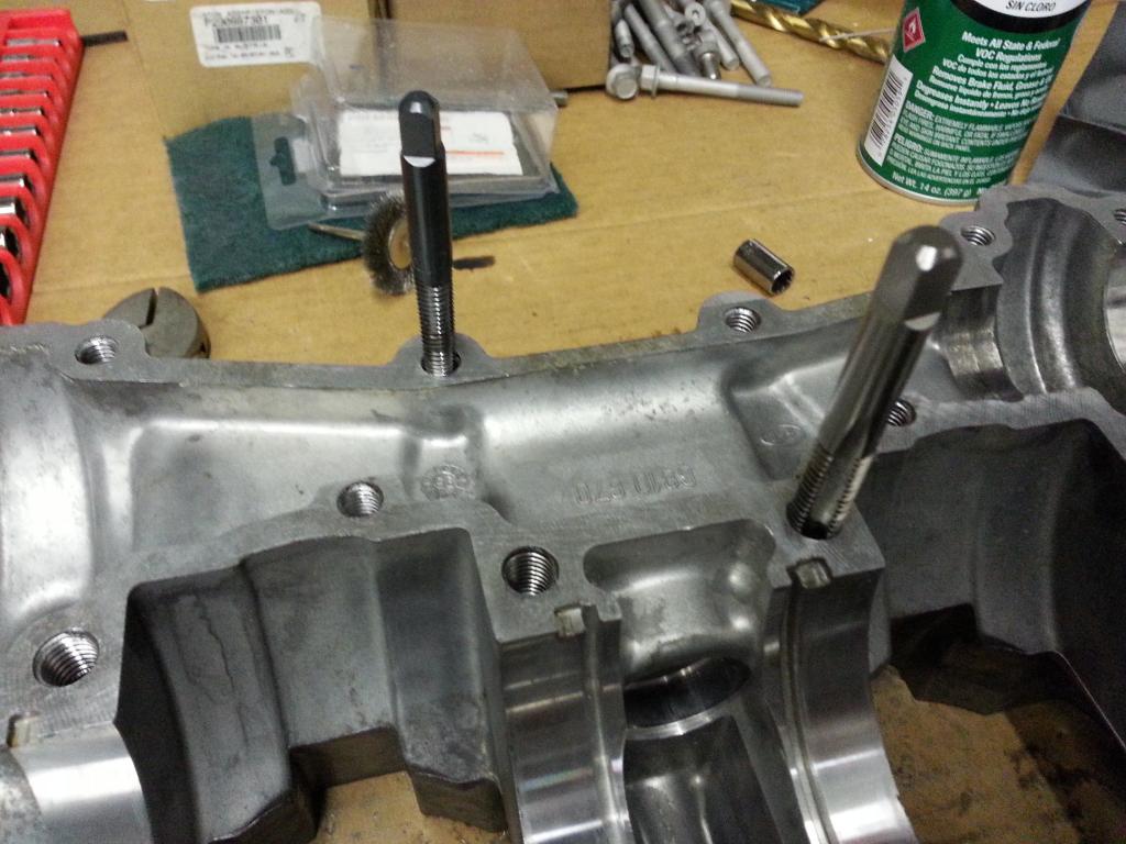

Here's the start of the rebuild. Now for the boring part---chasing the threads. You want to make sure you get out any old Loctite so when you thread in your fasteners they don't bind, clean threads will allow for a proper torque on each and ever fastener. After I finished that I will wash the cases with dish soap and water several time to make sure they are free from contaminates and blow them off with compressed air. Then once dried I can start the build. But for right now this is all I have, gotta work today.
Here's how I like to clean the case halves, I use a straight blade on edge and just flick it back and forth keeping it square to the case and NEVER digging under like you would a shovel. I like to keep the machined finish, I know guys swear by the 3M cookie cutter on a die grinder but I feel like those round the edges too much. I will then follow up acetone on a clean rag to remove the rest of the Loctite from the case halves.

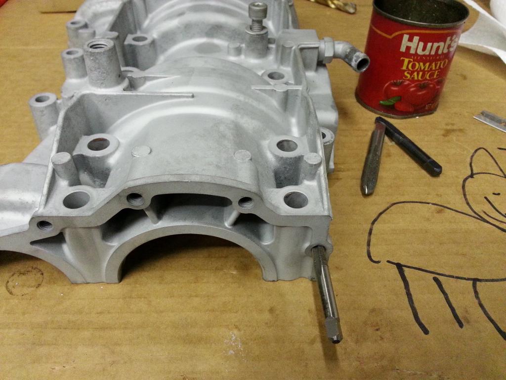

Here is the one half of the case that I managed to get a pic of right after blasting and still had it taped up. I don't like to blast the entire case.
Now for tapping. I do EVERY hole and the cylinders are done too, just no pics. No there is no tomato sauce in there, that is my tapping oil jar with an acid brush.
