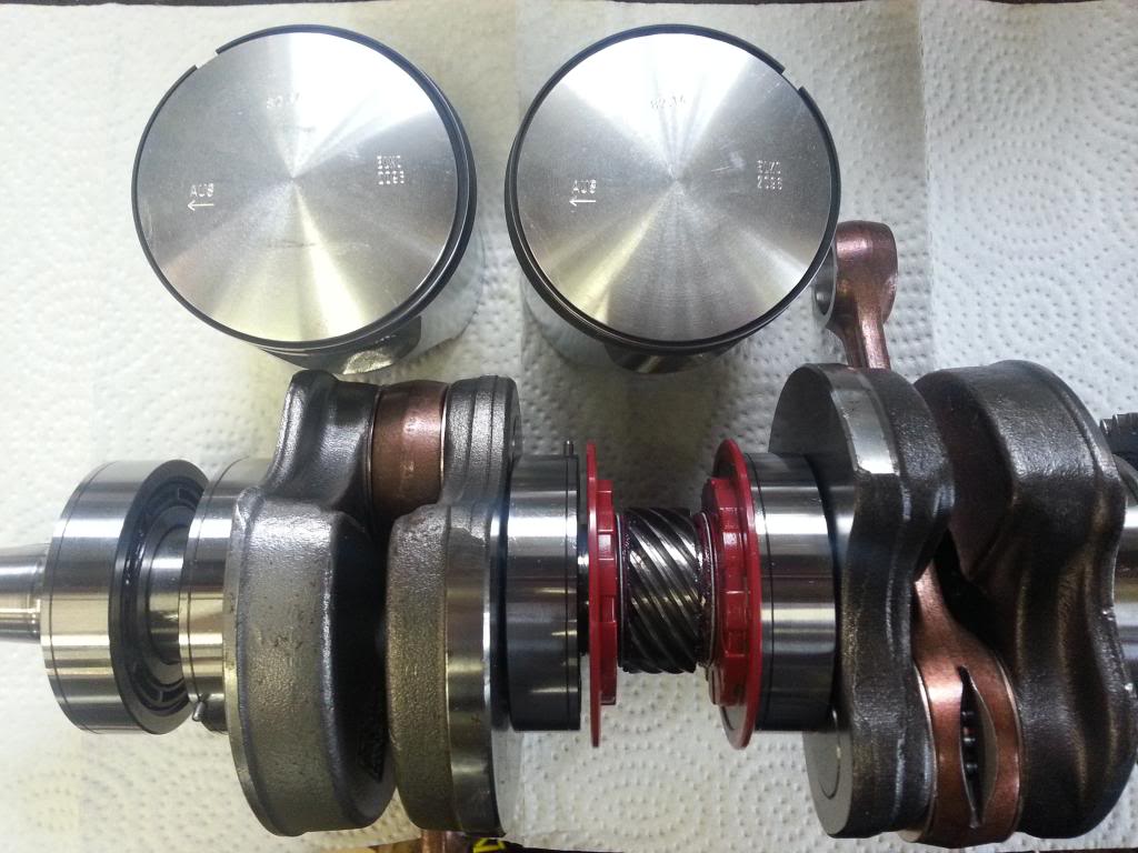

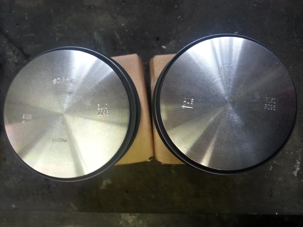

Some more goods just rolled in. Brand new 1st over (82.14mm) OEM pistons, I wasn't going to bore this one but one bore was a little weird. I guess from where the ring was parked it rusted a little and after I honed it I could still kinda see it faintly so I figured I'd just do it right. Had to post a pic of the rotating assembly!

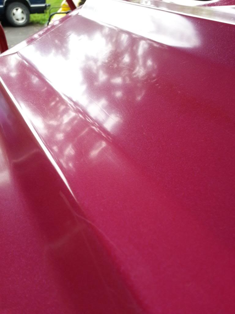

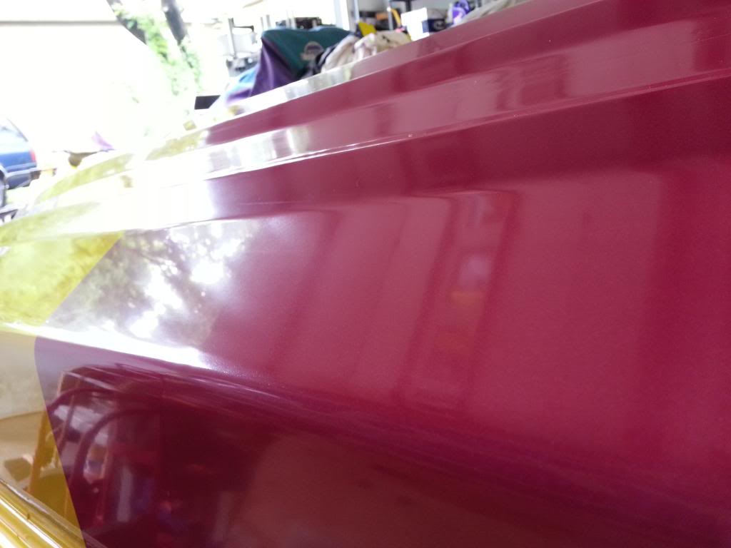

This pink is the new white, it's a MOFO! It looks flat but you look at it at an angle and BAM all you get is reflection. It really messes with your eyes.

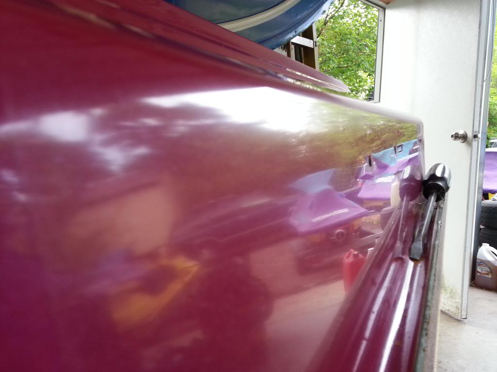

I like how you can see the hull and deck seam reflection on the side of the hull

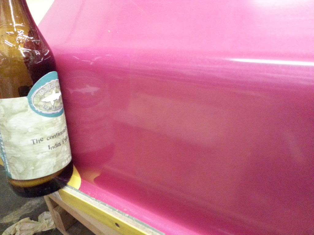

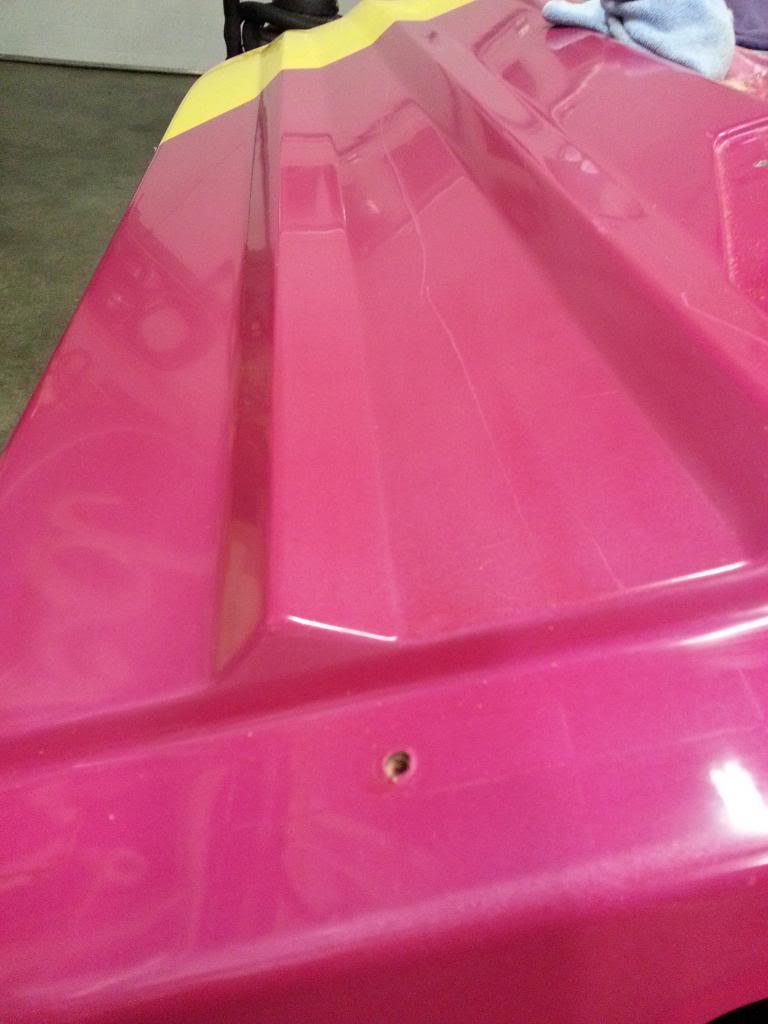

There's a nice scratch for ya'. This thing must have been trailered on wood bunks without carpet cause it's just dug into where the bunks would be.

Did you get them on e-bay? I am looking for a set.
Looking great!! The pink looks real sharp.
Yes, but right now I can go to the dealer and pay what guys are asking for them on ebay shipped and there are no pairs which sux. So really there is no price savings. I can buy an OEM piston for $95.59, SBT is $99.95.

Is this wet sanding EVER gonna stop! I just want to be done with the bottom already. Today was a good day to "reflect" on my work so far. As nice as this hull is there are so many little scratches that are just not going to come out. They must have been beaching in very fine rocks. I only hope I can make the deck just as nice or nicer.

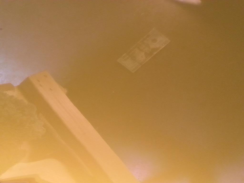

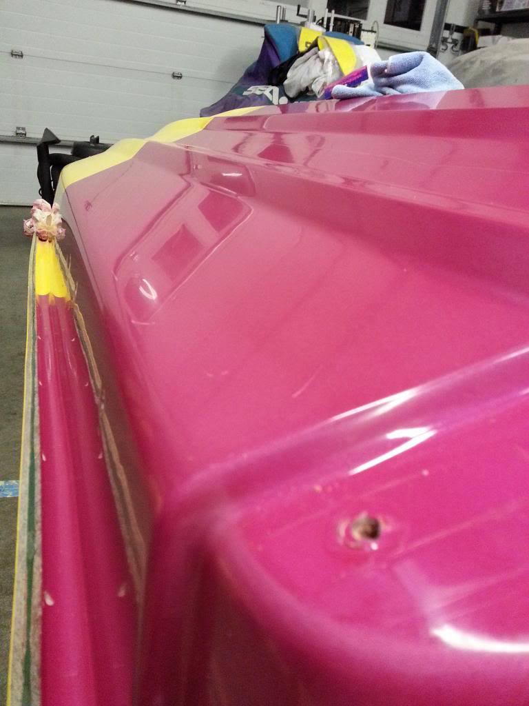

This is looking at the hull and the bill is 20" away on the ground. I'm glad the bottom is finally done, now onto the deck.

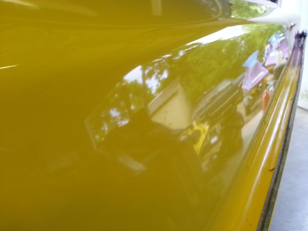

The big dig in the yellow, but it you look close you can see all the little rock scratches that would just look so weird filled because they just would never match.
This pink has ZERO depth.
