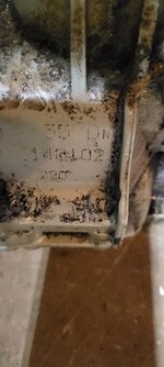

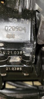

Hi all, new to forum . Bought winter project, 2002 gtx di with bad cyl came with 2004 di low hr long block / no injection parts ( was told came out of 04 and seems to match what block stamp shows ) My problem is,
the cyl heads are different the bolt holes for fuel rail don't line up on 04 head using org 2002 rail. They seem to be 1/8 inch off . I'm told they changed heads in 02 at some point , org engine has cast water inlet port and 04 has screw in Is there a specific fuel rail part # for the 04 I should be looking for ? org rail looks to be a 275 500 510 ( scratch marring last 3 # ) I have had 3 carb sea doo's ,this is my first journey into fuel injected. Any help will be appreciated
