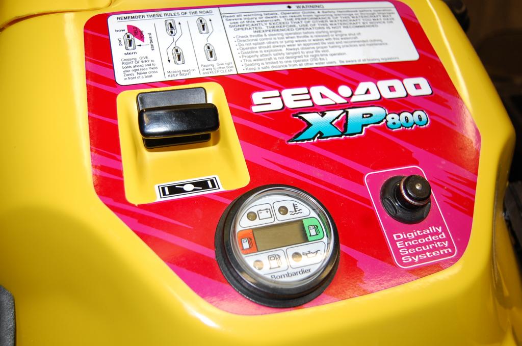

you're talking about the black plastic on the underside of the seat, right?
Speaking of your choke cable...
when I was a novice and before I knew what to look for, that black plate came loose from where the pull handle is on the console, so not knowing any better at the time, I epoxied it with like rock solid marine epoxy... Then I saw afterwards (when redoing the gas lines) that there was a plastic nut behind there that unthreaded and slid down the length of the cable.
What would you guys use to remove that epoxy? like a hard resin epoxy? is there any specific liquid or do I have to use a dremel and just be extremely careful?
and that seat is so clean, I'd be nervous to sit on it!
Yes, the black plastic pan on the bottom. The exhaust for the 720 VS. 787 is molded in a different location.
Yep, a nut from the back side. Nothing that I know of the would get rid of the epoxy, perhaps a dremel. Easier yet, just leave it be. I can't stress enough, look at the microfiche online before any repairs. An explosion drawing of the parts will help you determine what your plan of attack should be.

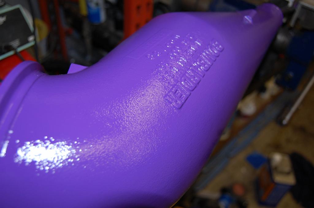

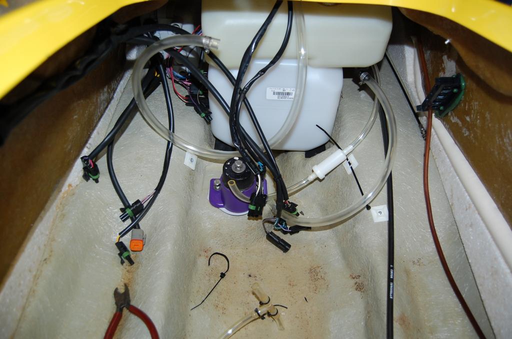

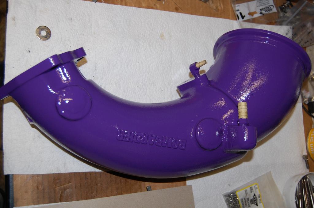

One day at a time really. I finally painted the exhaust. It's like the third time I blasted it. I always like to paint right after I blast the parts. So I did that and I guess I need to paint the carbs now. Installed the NOS choke cable and trim plate. It's getting there. I really want the decals, so there is no drive to finish it. I still need to paint the engine yet, once I do that it will move faster, maybe. Oh, and I finished up all the cooling and oil lines, all OEM tubing.
Looking good Dan! Curious where did you come about the clear tubing for the oil reservoir? I've look at the local Lowes but their tubing is not the same quality as OEM.
Thanks. The smaller tubing for the cooling and oil pump supply (same tubing) I scored on eBay. The larger rv oil line I got on eBay to, but didn't score. I could have got it from the dealer for less since I had to pay shipping. I think it's sold by the meter, I had 2 meters. The smaller stuff I got a ton, I think it was mis marked.

LOL, would you think I'm crazy if I said yes?
No, it's the original one cleaned with lacquer thinner.
Cmon dan, of course not....... I would only think you were crazy if you pressure tested the oil tank. LOL

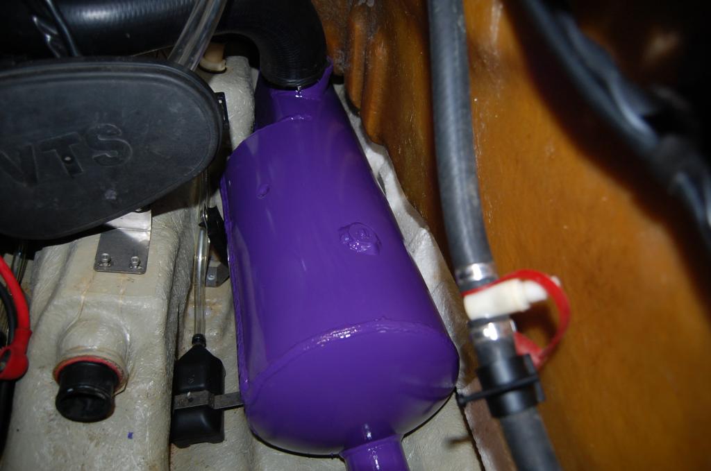

wait.......do you not have a water control valve?
Yep, that will go on next to last. That is a pipe plug so when I bead blast the water box I don't fill it up with glass. LOL, don't worry this is all stock less the hydro mats. I'm even putting the correct 95 only WCV on it.
