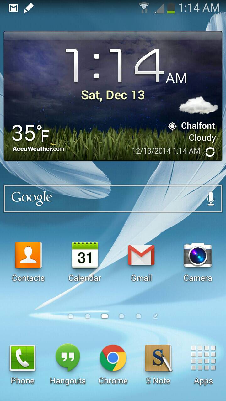

I'd have to go back through my thread to see what grit I started with. Oh, wait, I don't want to do that my fingers are already cramping thinks about it. Temps can't be that cold down south. My shop is 68 right now.

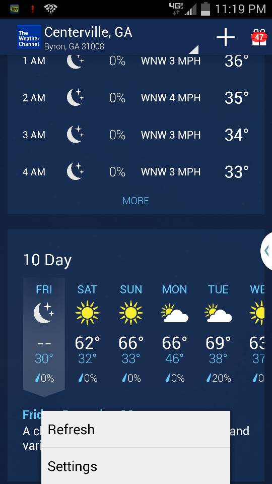

this is our temp swing

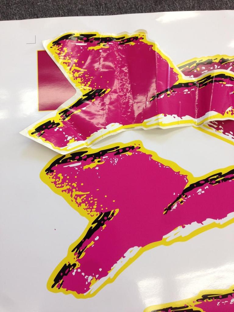

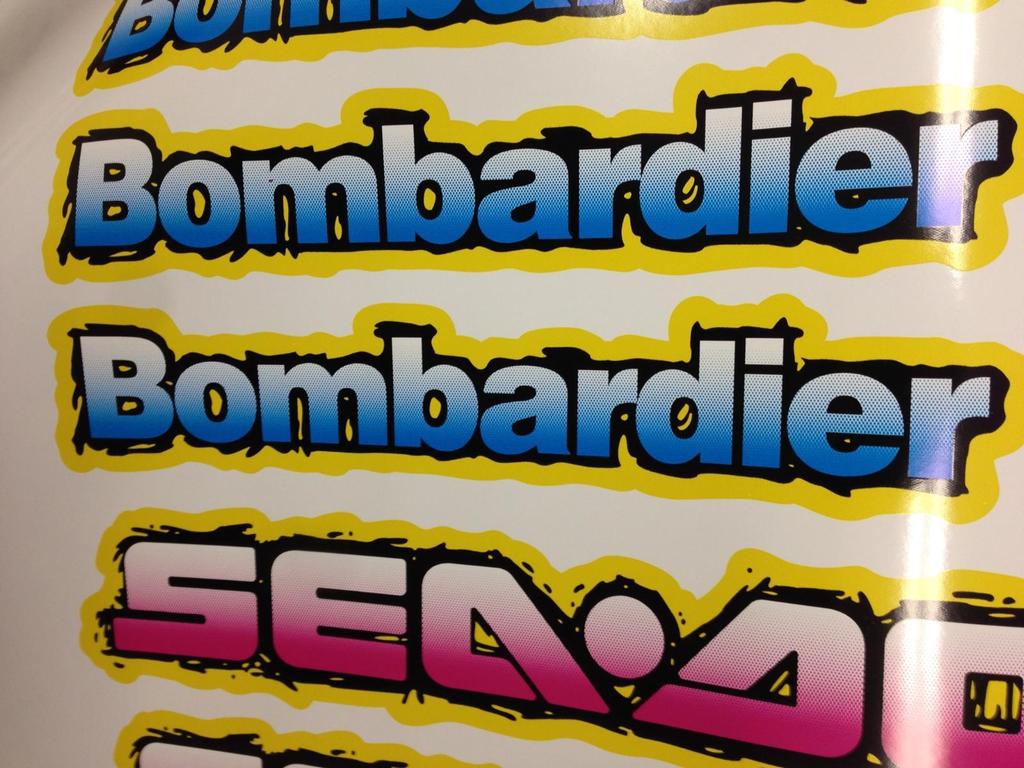

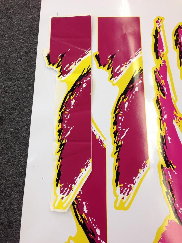

OK, here we go.
The one on the left is the NOS lower, on the right is Mike's reproduction.
Upper is the NOS lower is the Reproduction.

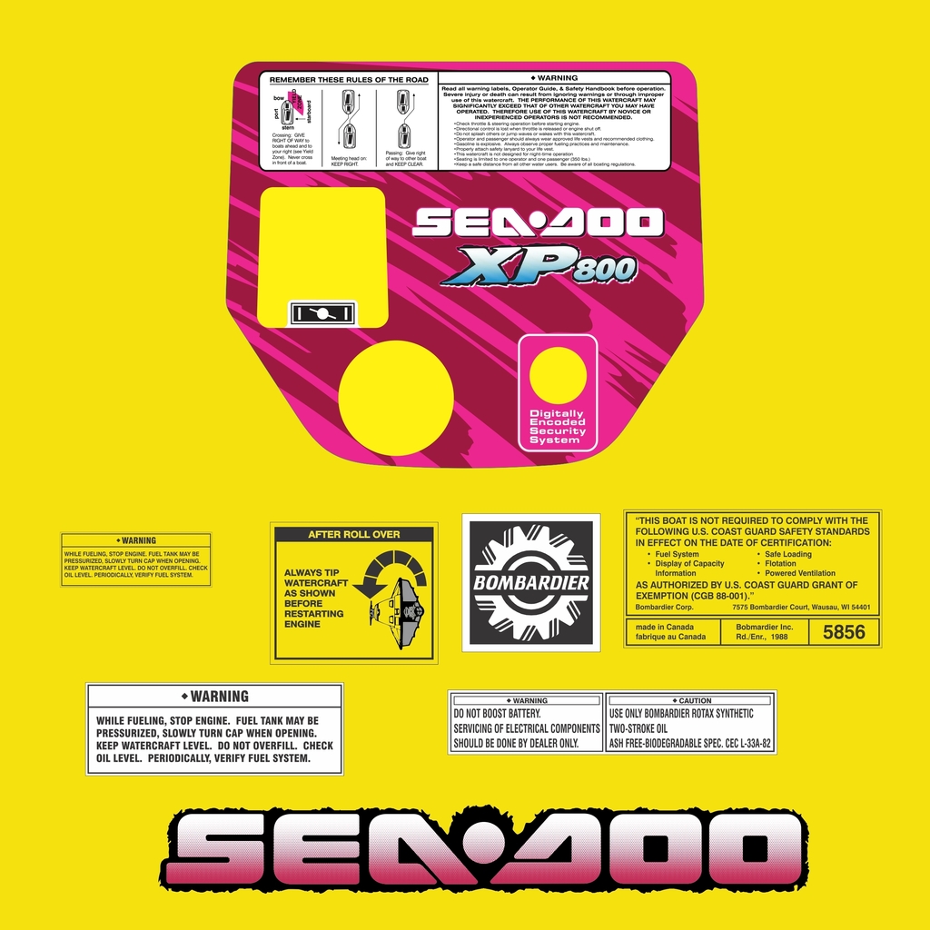

Now here is the dash decal and the warning placards. The warning placards are additional cost above the kit. The kit is just the dash decal, the front and rear seadoo, the hood side seadoo decals and the and obviously both sides of front and back decals. I think it's a total of 9 decals in the standard kit. If you want the "extras" you gotta pay the man. There are a few other decals I had printed but the images aren't big enough to post so y'all gonna have to wait to see those. The SEADOO decals in this rendering has been corrected, the dot between sea and doo was made the correct size.
