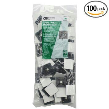

I'll take that as a compliment, kinda. I just want it to look as new as it can under the seat. If you want I'll ship you some, I have 94 left. They were $12 for a bag of 100, the dealer wants $3 each. They even have the double sided foam tape like they should. They call them 1"X1" but in reality they measure 1.100"X1.100" which is the exact size seadoo used.

They're just like this bag, but natural color. At my hd they're right with the wire nuts. Marketed by Commercial Electric.

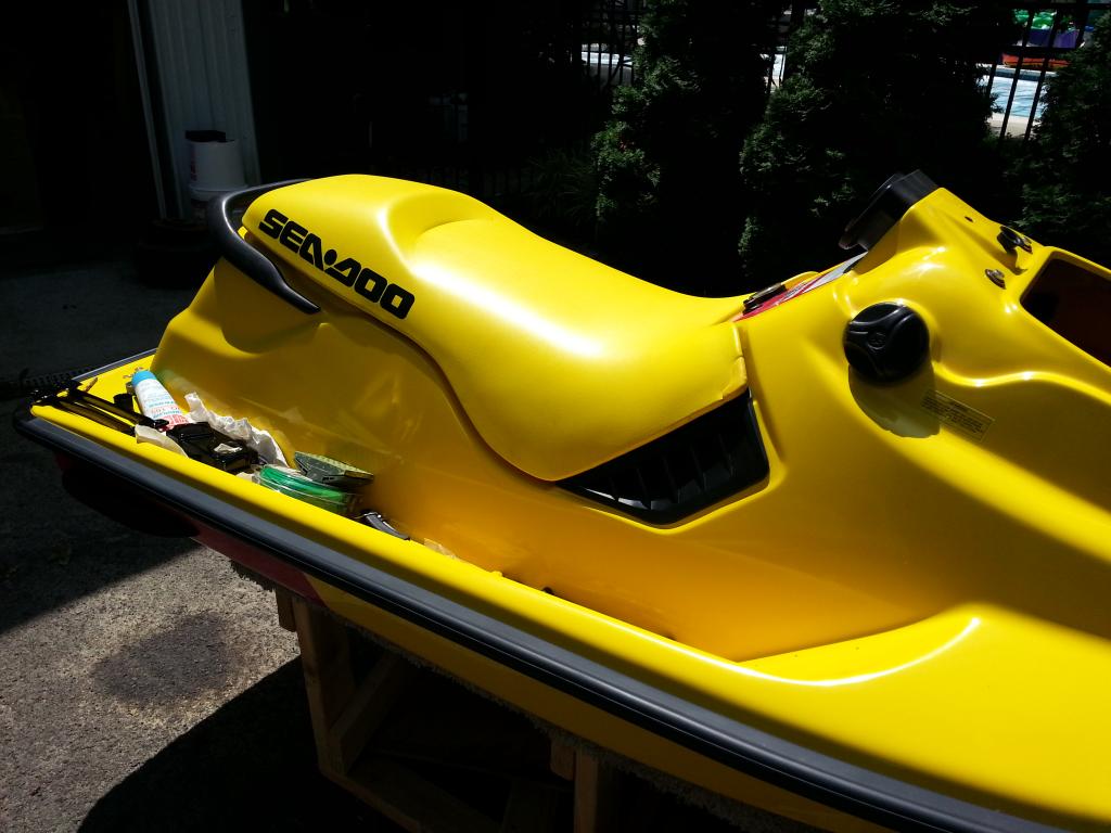

The guy that owns a cycle/Seadoo shop up the street from me lives a few streets down, he has a minty minty fresh 95 xp800 and a mint spare 95 xp800 hump seat with original seat cover. I can see if he's willing to let it go if you want.
It must be a take off from 95, I don't think it ever saw water, and if it did, it was very,very little.

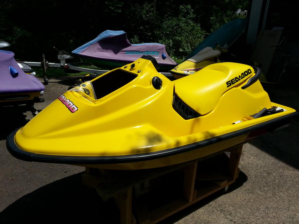

As far as where it came from [MENTION=43106]CReynoldsMIZ[/MENTION] knows a guy who knows a guy and he brokered the deal for me months ago. It's been sitting here, just eating me alive. Chris (under my hyper guidance) packed it and shipped it from Missouri to me. There is $25 in boxes, bubble wrap and a full roll of packing tape on that. Oh, and some old styrofoam from a TV box. It made it's journey to me safely. So that is straight from 1995 to 2014! It's to die for, the seal on the seat pan is so thick I had to adjust the seat post.
Winding down on new parts, just picked up an NOS choke cable and the small black plastic outer choke plate and a fuel switch nut. I think I'm down to a new cover and the decals. Probably missed something small.
Geezus that thing is pretty!

yup, i would say that seat definitely looks familiar! Glad you finally spilled the beans. I really hope the graphics turn out nice.
also, you better do the swimsuit check before anyone gets on there to ride! It would be a damn shame to see a black stain from a bikini bottom on there
It was tough holding back, you know. Now the only big reveal will be the finished product. I think I will run this seat a few times and just put it away...maybe. I'll make sure my kids wear yellow suits when we go out and ride.

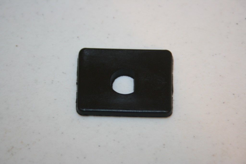

Speaking of your choke cable...
when I was a novice and before I knew what to look for, that black plate came loose from where the pull handle is on the console, so not knowing any better at the time, I epoxied it with like rock solid marine epoxy... Then I saw afterwards (when redoing the gas lines) that there was a plastic nut behind there that unthreaded and slid down the length of the cable.
What would you guys use to remove that epoxy? like a hard resin epoxy? is there any specific liquid or do I have to use a dremel and just be extremely careful?
