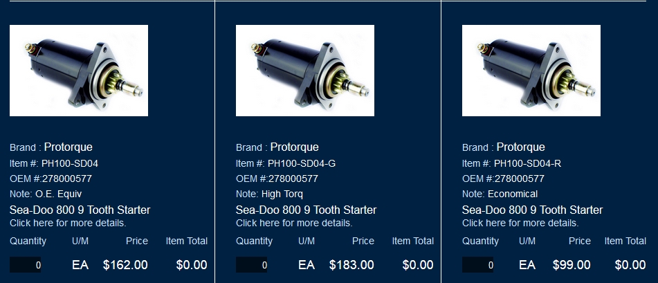

We sell the WSM starters here are the prices for the 800.
