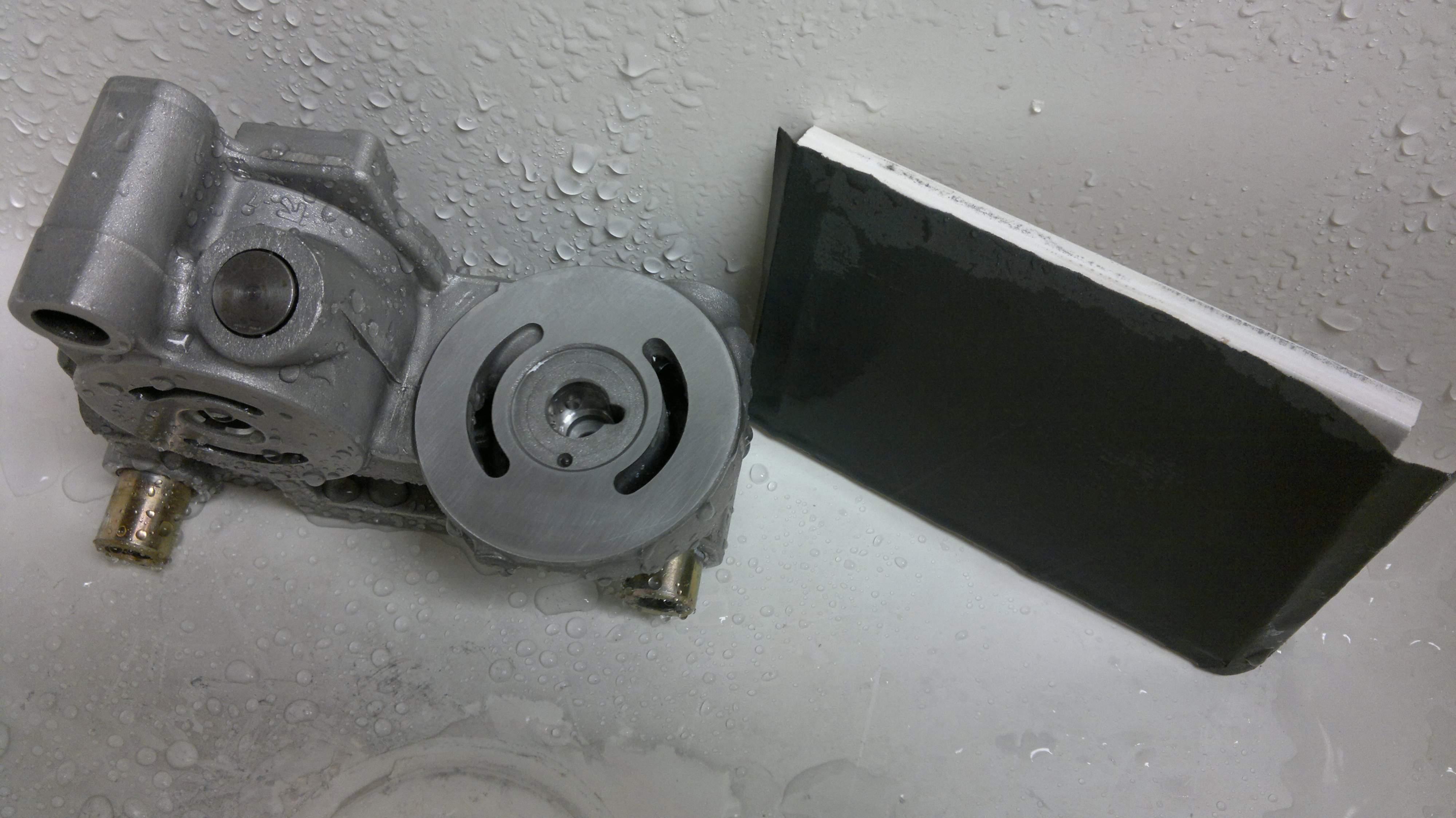

So I finally started getting into it and first things first....both oil pumps were chewed up. That is my first question....is any dings unacceptable? The covers also had gouges from one opening to the other...I would think thats worse than the actual pump, but Id like to hear the experts opinions on this. The SBT literature made it sound like one little ding is going to cause failure and I dont want this thing coming apart on a customer so I just bought them...but Id really like to hear from the experts.
