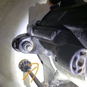

poetbruce Member Aug 7, 2023 #1 Hello folks, just finished an install of wear ring and carbon seal kit and neoprene seal to pump. When I reinstalled the pump, it looks like there is space between the pump housing and the boat. Is this space normal Attachments 20230807_055452.jpg 441 KB · Views: 5 20230807_055528.jpg 316.3 KB · Views: 5
S Spider4real Active Member Aug 7, 2023 #2 That is normal. The pump seals at the front against the neoprene seal. You are good to go.
