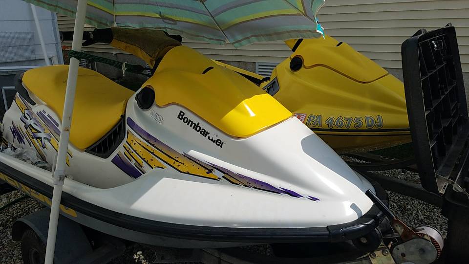

So I bought the 99 SPX $2400 with 130 Hours on it and its in pristine condition ( brand new seat cover too) I brought a compression tester and both cylinders were 145ish (not more than 5% out from each other) climbed under and looked in the pump and the wear ring was brand new looking, I asked about the wear ring and they said they didnt know they just knew that they had it serviced at the dealer and the bill was always around 300$ so the wear ring was replaced at some point and the caulking around the pump was not OEM black it was clear so someone has had the pump off (dealer). I asked what oil have you used for the ten years you have owned this? he said he didn't know and he would go get the bottle and wouldn't you know he brought a BRP full synthetic 2 stroke bottle and said thats what we have always used the dealer sells it to us for $25 a quart and we just keep the oil tank full. So I was pretty happy.
It does have the old grey tempo lines so I have an oil block off kit the small Ski-Doo vented oil reservoir for rotary valve gear (thanks Chris Watercraft Magic for introducing me to that nifty little tank) 25ft of yellow Tygon F4040A two genuine Mikuni carb kits w/ N/S and a spare rectifier in case this one craps out at the lake. Oh and a fuel selector valve. All that for the premix conversion and preventative maintenance and I think this ski should be GTG am I missing anything? Ill be using Klotz R50 for premix.
