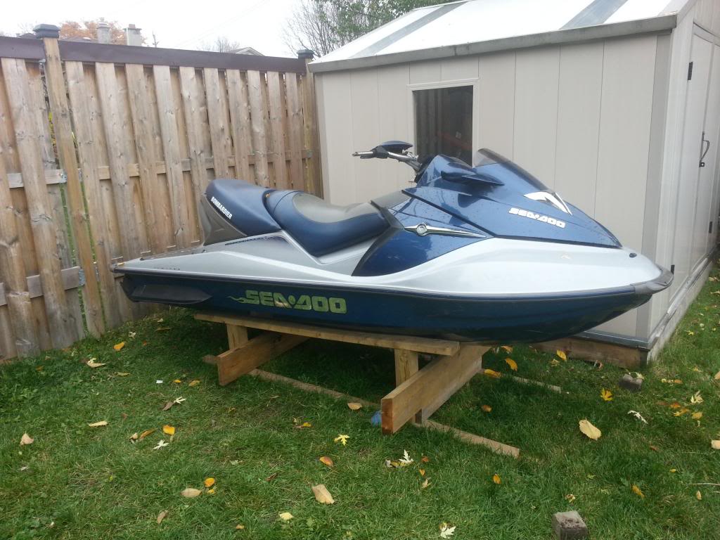

Here is the womans new couch. 04' GTX I have the full rebuilt longblock to drop in. Just needs a pump and a dash and a dess post. And maybe a new seat cover.

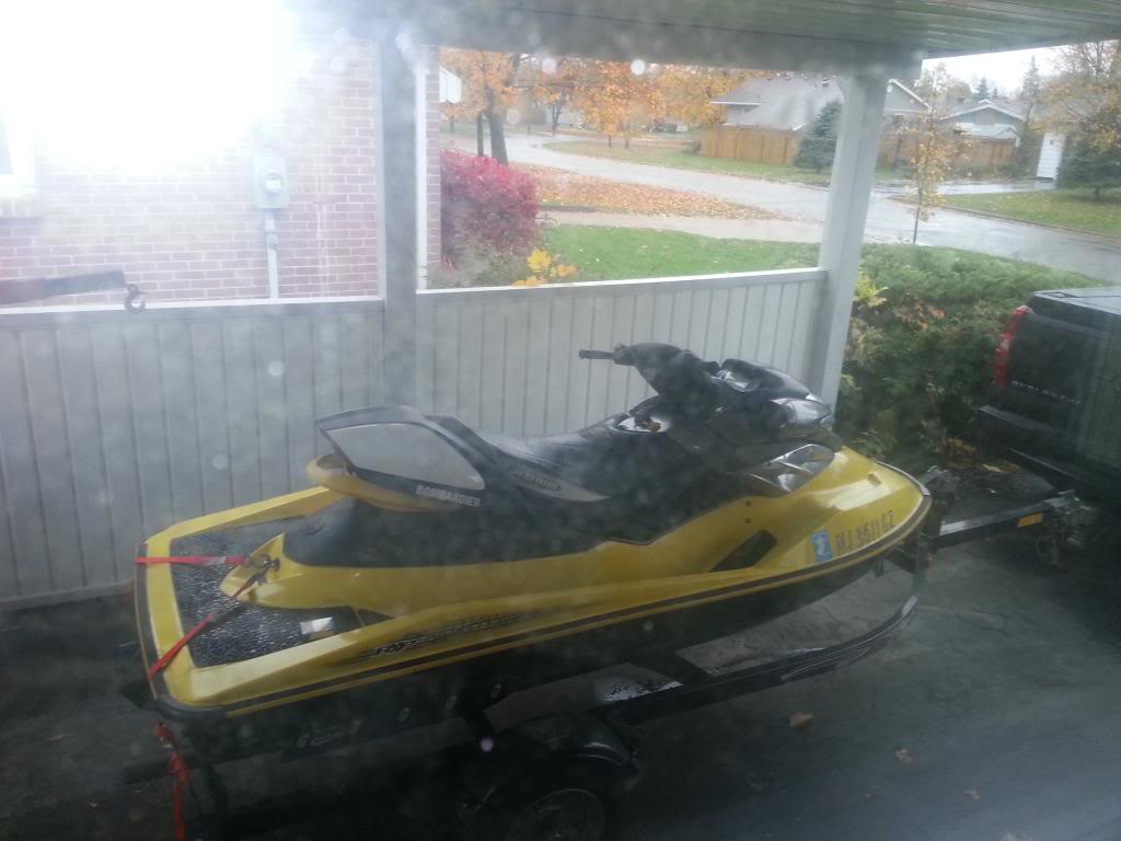

And this is an 04' RXP. Engine needs to come out and get the updated 06' valves new timing chain and updated flywheel bolts. I will probably throw new bearings in the bottom and hone the cylinders with a new ring set.
