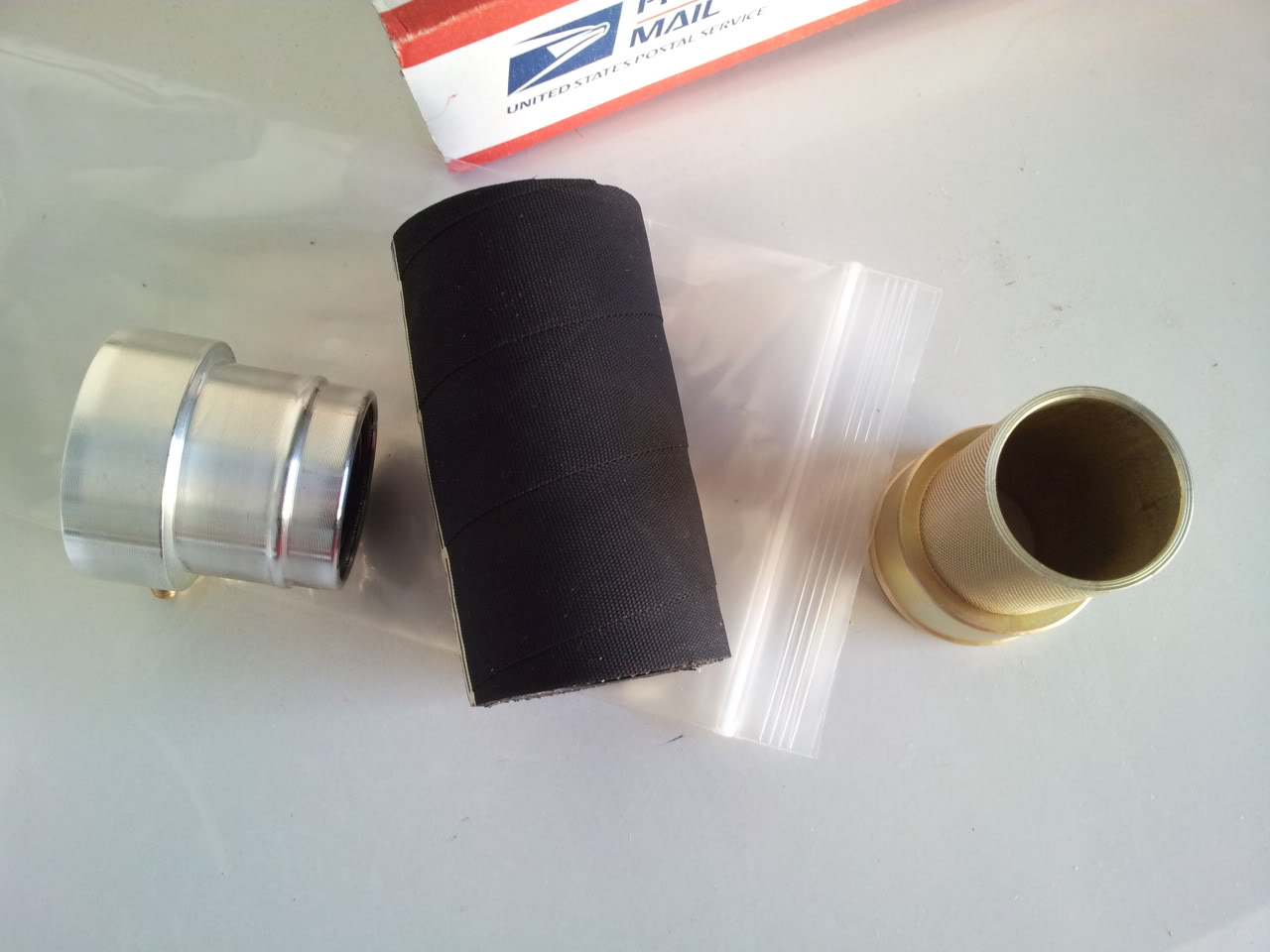

Here's the kit for the carrier bearing.

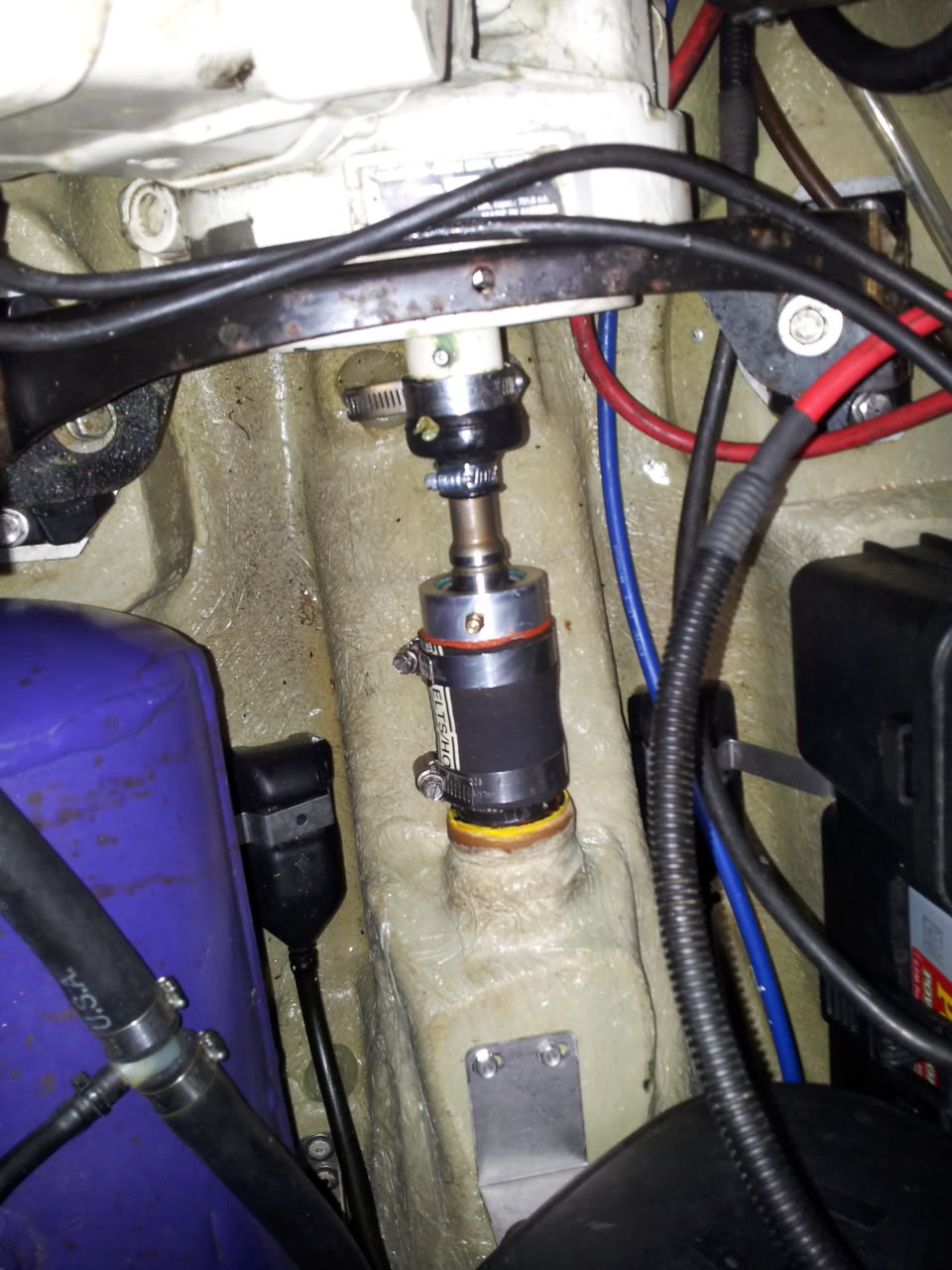

here's it all in.
It definitely gets warm, granted doesn't seem to get any hotter than running the carbon seal out of the water. Think I may have cut too much of the hose, although it's no big deal as I can just buy a new one if I have to.
