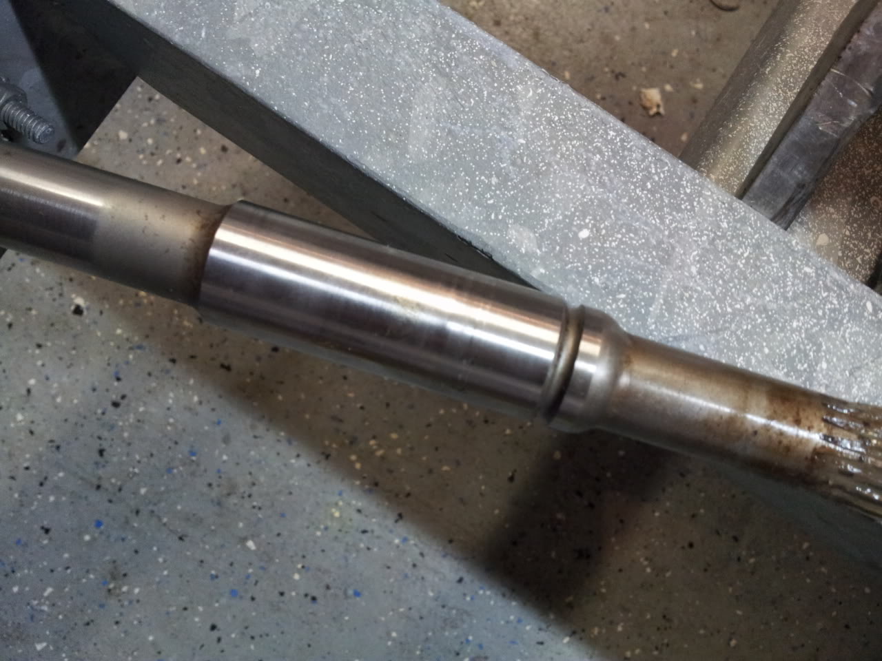

Pulled my pump and driveshaft tonight. Looks like it'll be perfectly fine for a carrier seal. Pretty clean and no real grooves or anything. Should be a good candidate for the conversion.

PS Not to sound fruity, but that's a clean driveshaft! Should have no issues with the carrier seal on that baby.
