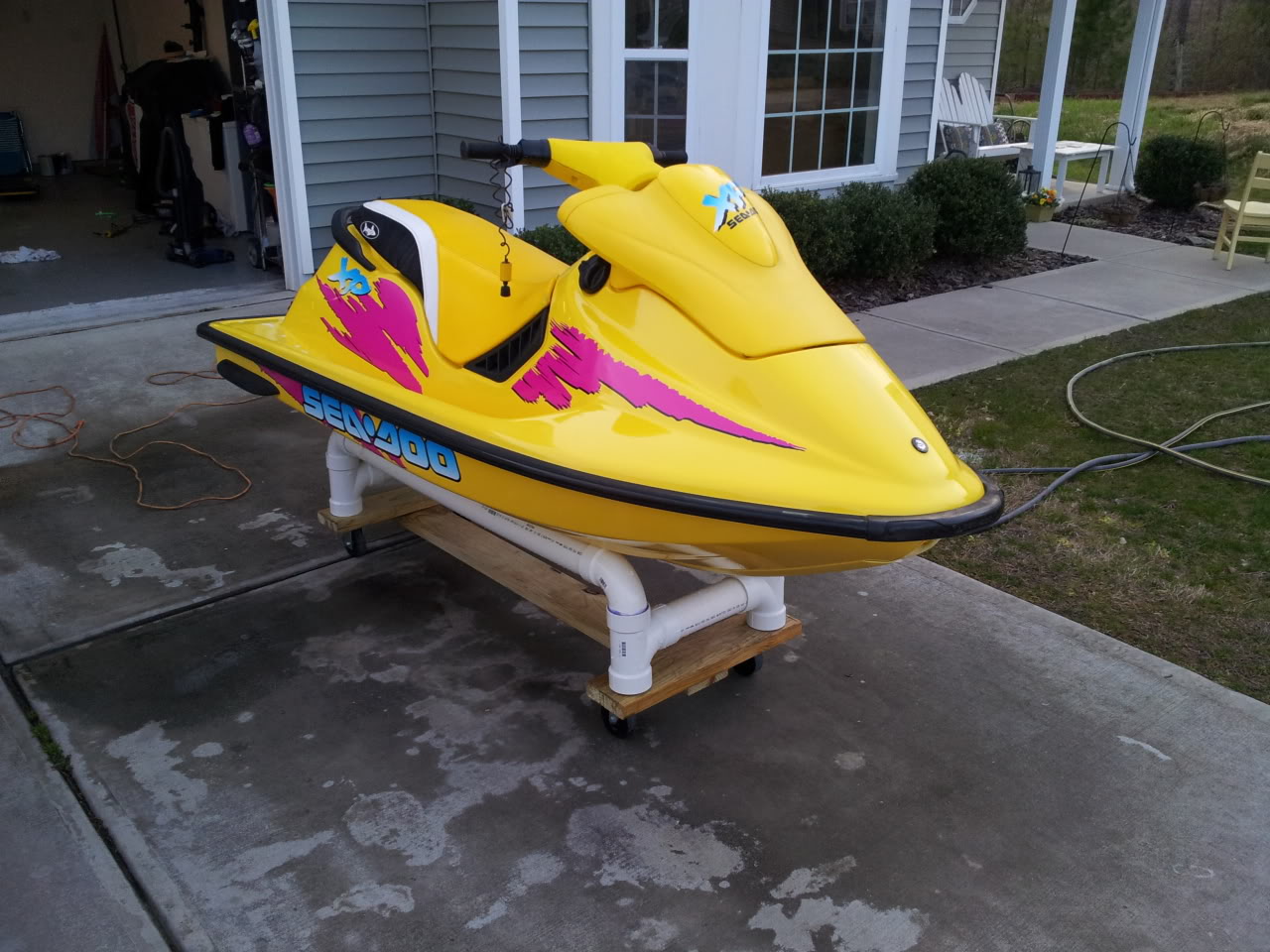

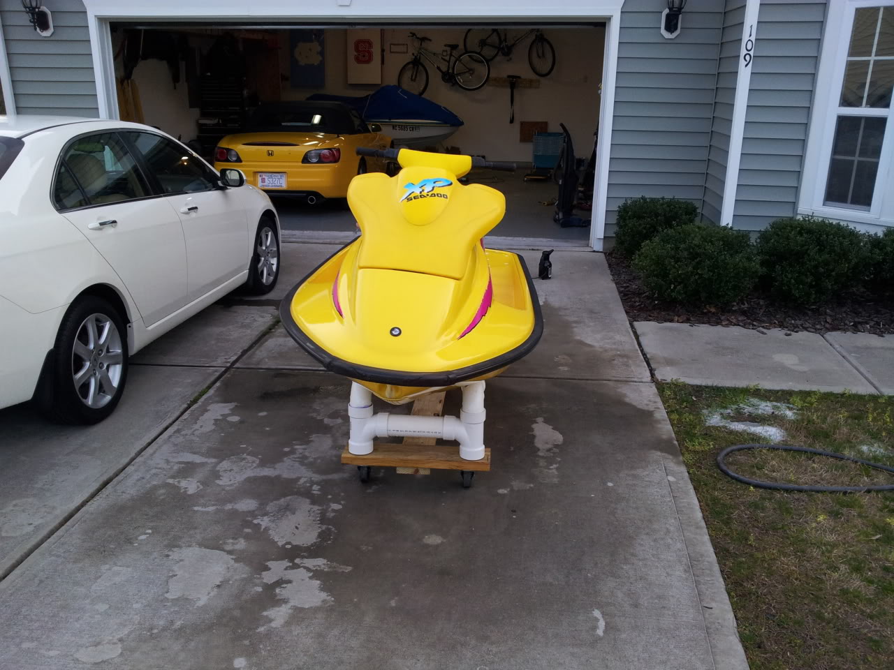

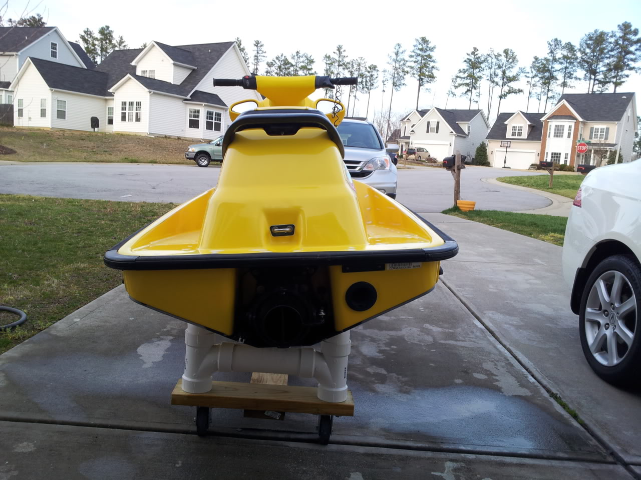

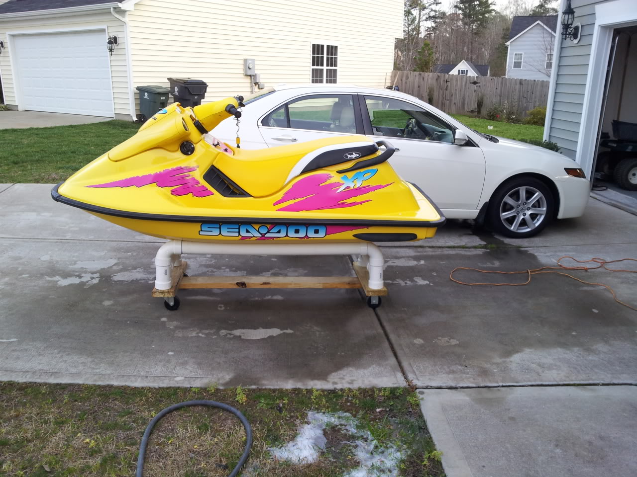

After hooking it up to the hose it needed a bath to wash off all the dust and grease from my dirty hands. Tomorrow should be putting the mats down. Then just water testing it.
All done, now just need to water test it.

DAYUMMMM! Looking mighty clean there ol Suke. What happened to your hand tho, lookin mighty blistery
lol this happened
I managed to griswold myself. So I was putting some rubber moulding around the storage bin. Figured I'd use the 3m 4200 I had. Wellll long story short I got the bright idea to spread it with my finger. Then attempted to wipe it off with a paper towel. Which immediately turned in to plaster and got on both my hands. DAMMIT! In the vid I managed to pull a lot of it off.

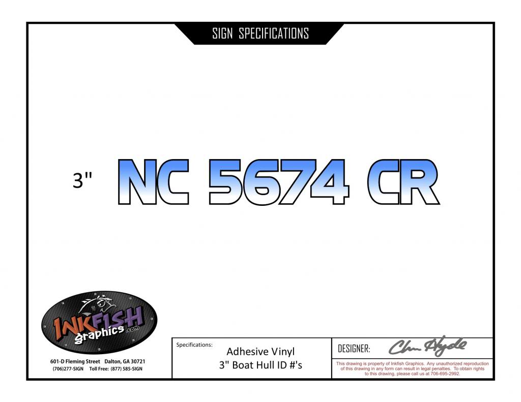

Im thinking you need some baby blue registration numbers to match up to the lettering on the rest of the ski....Suke the ski looks INSANELY clean. Great Job!
So as much as I hate to say it, cause I hate "carolina" blue, I think I'm heading that route for the numbers. Was just going to go plain black and my buddy freaked. Said no way I could do that to this ski, it looks too good. I thought....wellllll it's just black numbers what's the big deal? Then looked at his ski. It does make a difference. Dammit!
So now I have to find someone that can print decals with a blue to white fade with black outlines in a decent font. Gah!

$40 which isn't too bad considering some I priced on the internet and from exotic signs to be $70+. That's just retarded for registration numbers.
