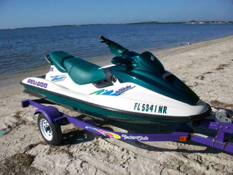

I use the conditioning sauce for my seats. My boat sat all winter in one of my garages here is the pics from last week after i took the boat out and got it all cleaned up

Thanks for all this info guys ... super appreciated!! WOOSAB thats a really nice boat! Somedays I wish I had a windshield like that to get outta the wind ... Just don't let my wifey see pics of that boat .... LoL :cheers:

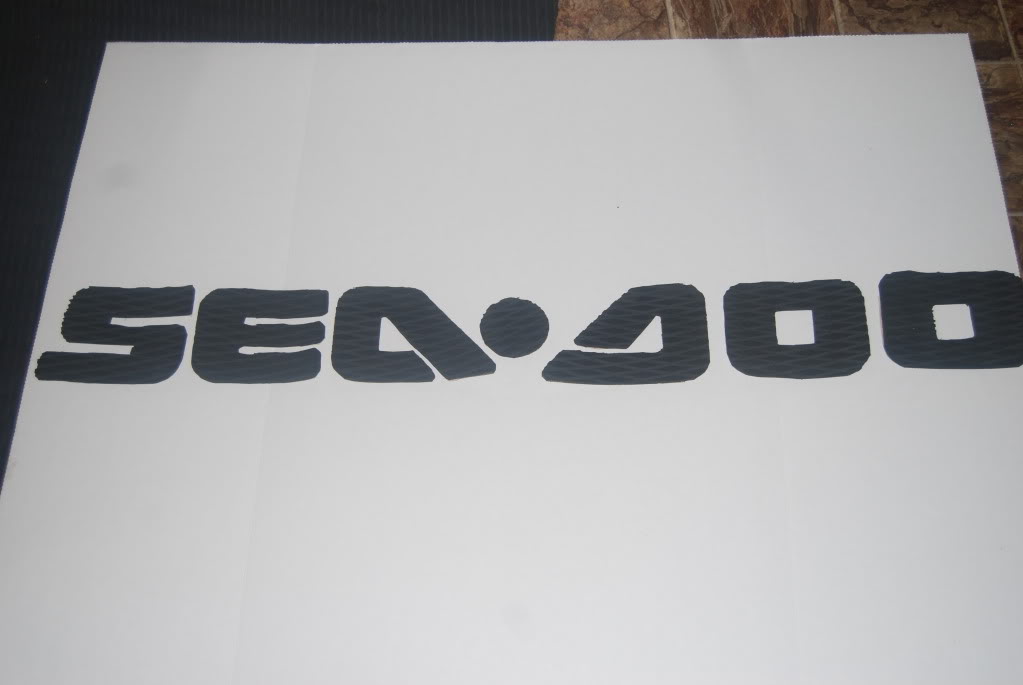

First try on getting the hatch emblem cut out in hydro turf. Still a little rough around edges ... Maybe a couple more tries ...
Looks like a good start. What did you use for the pattern? I was thinking something like a thin board or something hard and like a 1/4 thick. Then hold it down good and use a really sharp exacto type razor. I am excited for the progress.
One morning it was around -8C so I untarped the boat and was able to easily get the old decals off cause they were froze. I placed them on a 3" thick piece of dense foam and cut them out. The exacto knife really does a crappy job tried that first and the edges get really jagged. I found a set of tin snips to work the best :confused:. Excellent point on direction of Diamonds!!! Good thing I can get about 9 sets out this sheet !!
Ya know I posted that about the direction of the diamonds, but then went and looked at pics of my boat and you have it right so far. so i deletd the comment. But glad it was a good reminder for you.
Is that dark grey? I am kinda color blind, so it is hard to tell. I thought you had used black. If it is the dark grey, I might just have you make me a set if you have enough. The cut diamond is close enough that it may look ok. I could try it and if I dont like it, then buy the molded diamond and have you make them for me. Thanks for all your work so far. I am not very handy when it comes to this part of stuff. glad you can get it.
