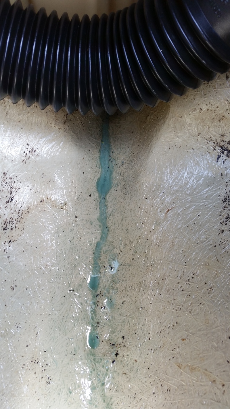

There's some oil in the bottom of the hull. It looks to be new oil since its kind of a seafoam green color mixed with a little water. I noticed the lid on top of the oil tank is very loose and there's some oil on top of the tank. The tank is completely full, so it could have spilled from the lid.

Green oil

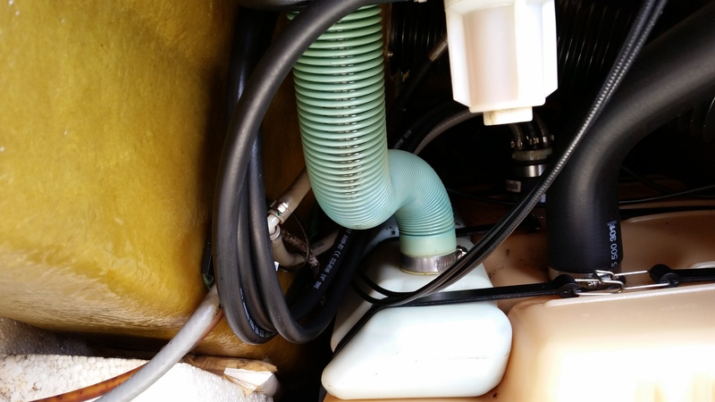

It looks like I have a few fuel lines to replace also. Everything besides the three in this picture have been replaced. Not sure why they left those. Any trick to getting those clamps off?
that oil tank is one piece so probably the grommet on the bottom leaking and as advised, drain that oil lol! flush it and use api-tc oil. while your at it may as well replace the inline oil filter and check the small oil lines pump to rotary cover and replace if not pliable.

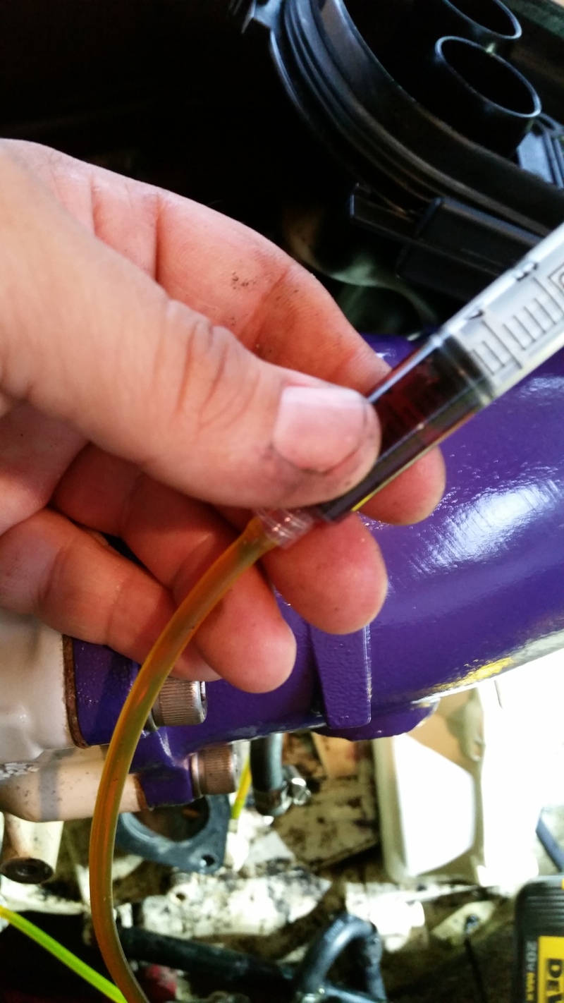

I filled the injection hoses so it wouldnt take as long to prime.

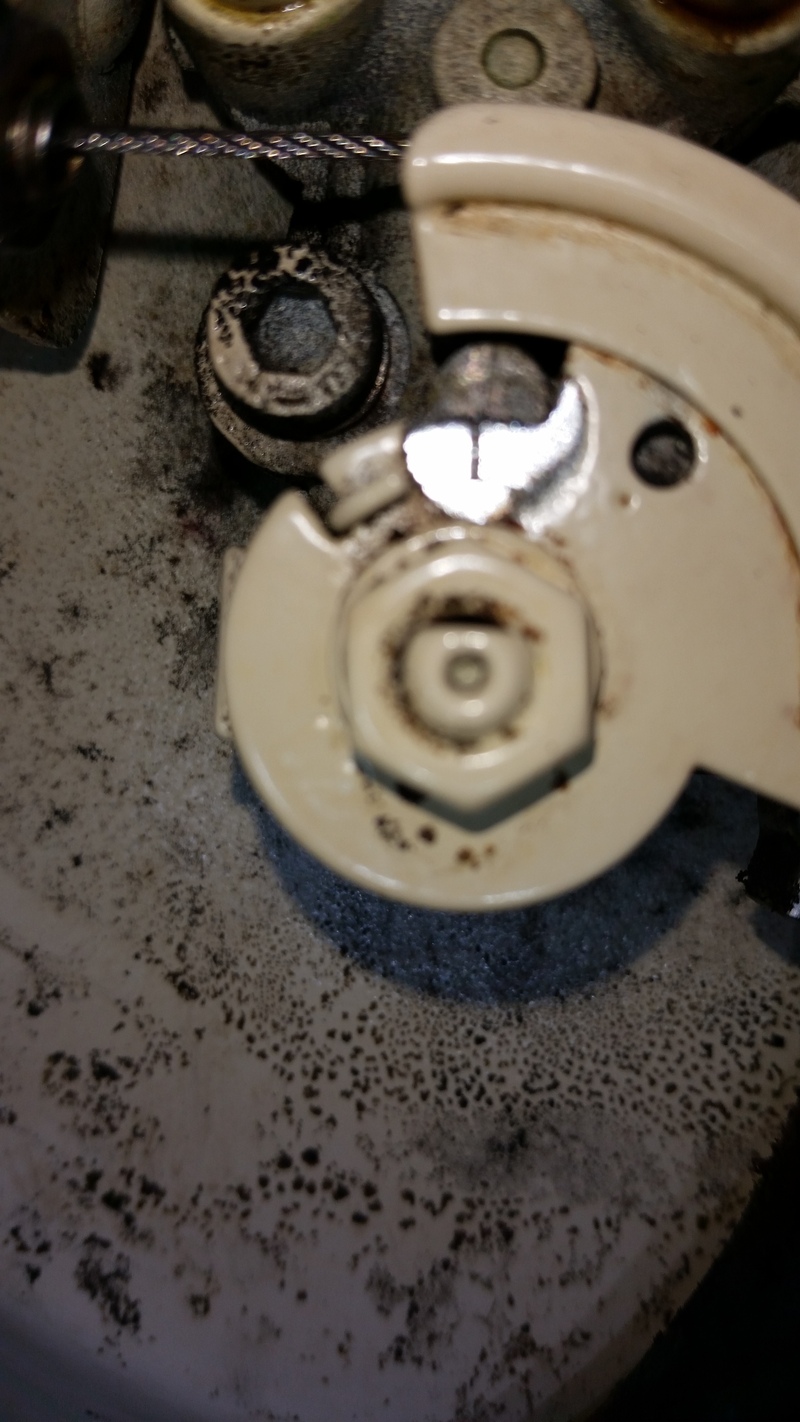

This is the oil pump alignment. Is that close enough or should I get it perfect?

The oil pump marks need to be aligned and the way you have it is a little rich.
The gray fuel line in the picture is the return line and needs to be replaced. The only ones that are ok to leave gray are the vent hoses from the tank out the hull.
