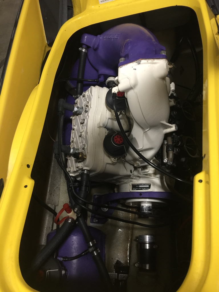

It's out, these are from yesterday. The grime in that engine was killing me. I had to clean it up a bit first.

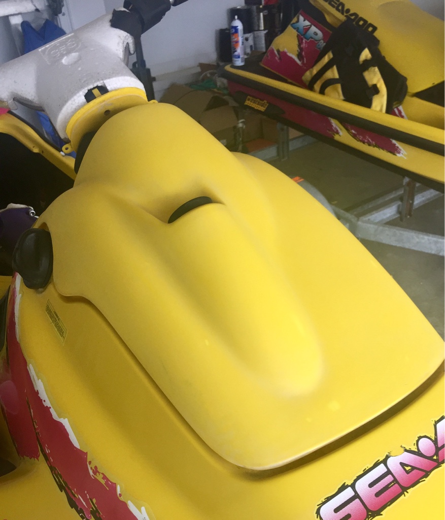

Hood cleaning up. Should be able to get it pretty minty
