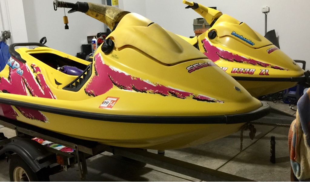

RESTO Another 95 XP800
Nice pickup. I'm still trying to decide what to do with my 95 as well. I won't get to it this winter with too many projects so contemplating selling to another restorer. Hate seeing it hiding in a barn lol.
Yeah I'm in the same boat. I offered the one I have to a member for $800 as is because he was considering restoring it. I just end up repairing them and selling on a trailer for 1500ish as a "working jetski" to someone who doesn't realize or appreciate the rarity or heritage. If I had two on a double trailer running that would be a sweet package the right guy might drive for.

Y'all know I want to keep it, buttttt the wife is not pleased with the current garage situation lol
Can't you just store the other 95 at the lake house while restoring this one?
Does it run? I'm not far from you. Pm me pics!

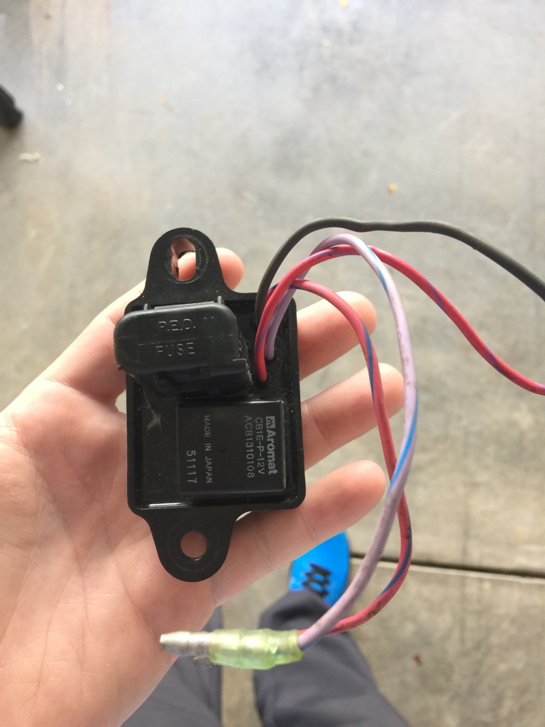

The mpem on this 95 was supposedly bad. After some reading and parts swapping it's as good as new. This relay here was bad. It powers on the cdi
And great troubleshooting. Many people would just start throwing parts at it and opening the wallet. THAT is why we can ride skis for much less than others. Or spend money on the upgrades....
Here was my original post that I couldn't get to go through
Well I thought the VTS was taking out the mpem. Previous owner said the mpem was bad. The gauges would light up when hitting start button with no key. Put the key on and temp sensor would flash and I assume 4 beeps(beeper bad). This would indicate mpem can not communicate with cdi. After some research and listening(I couldn't hear the click in mpem when turning on) I replaced the relay. This part. Everything works as it should now. Woohooo
