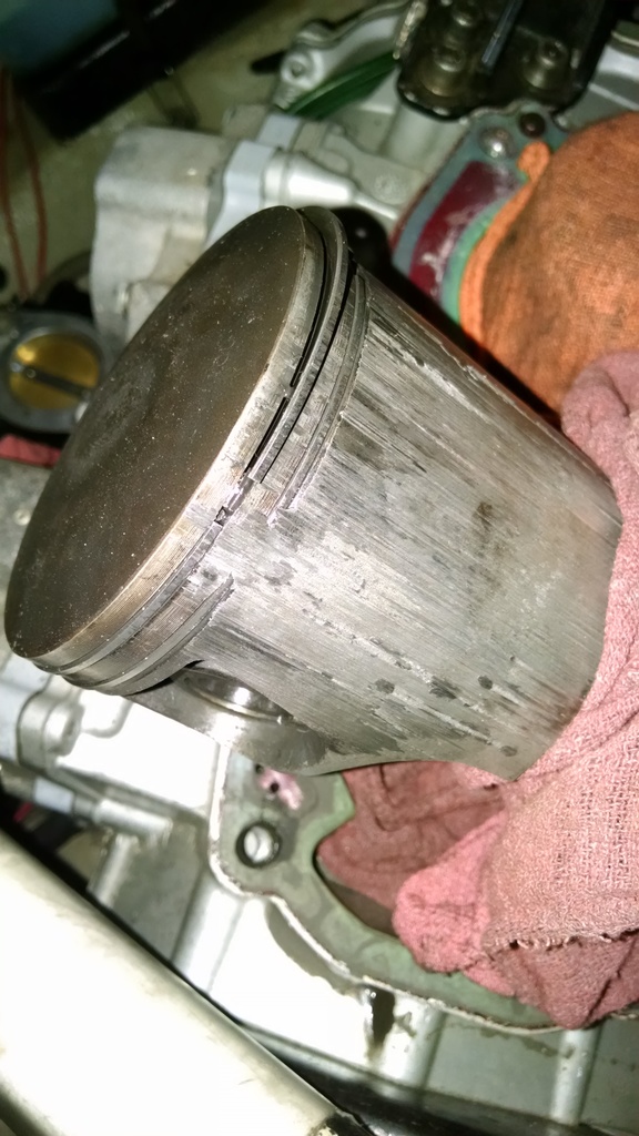

98xpl,flipped it,sucked water ,blew engine.

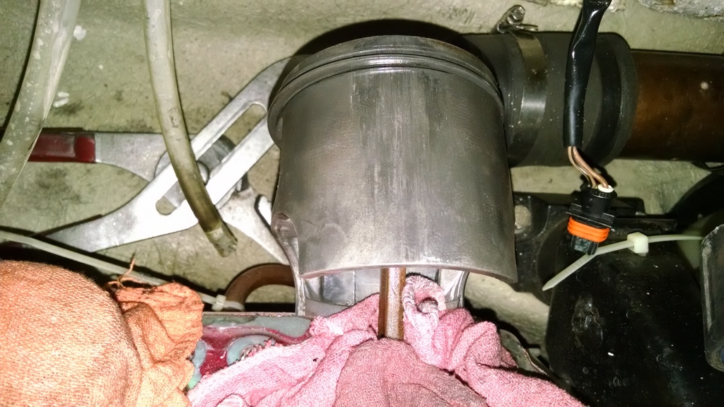

i see that the crank is welded,maybe an sbt ?only an arrow on top of the pistons and a 1.00, if it was sbt,i have to say that it ran great for almost 3 years till it got filled with water,then lack of lube while the water was blowin around did this.i added a bunch of oil while we were gettin the water out,but maybe not enough,dont know for sure.

If you just need it to run... Welll....
First... don't yell at me.
Second... take a small jeweler's file, and clean the burrs, and get the ring free. (Do not damage the ring with the file) Then remove the rings, and clean the ringlands. THEN... lightly hone the bad cyl... and put it back together.
I've cold seized dirt bikes in the desert, (using sandpaper) and I've repaired worse than that to get me though a weekend.

I pulled the plugs,and it was totally full of water.hours later I got it to run,went to dry it out on the water and it seized. my buddy is payin for all costs.oh,,he aint happy bout it,lol.
doc,,ur right on the filing the piston trick,we have done that a few time to get by on the dirtbikes.

I think im goin sbt.for quickness. I do think the engine was an sbt based on the piston size,and welded crank.
btw,,i use lucas oil,and the other piston and cylinder walls look great,as well as the raves,,ill post piks tonight.

Funny thing, but I'm not even sure sbt will take one of their own engines as a core seeing how they max out the cylinders and weld the crank. Might wanna check that out

talked to jessika at sbt today,,i told her i thought it was an sbt engine and she didnt say anything bout it bein a bad core.but ill call tomoro n check. i should have an engine thursday if it shipped today.
