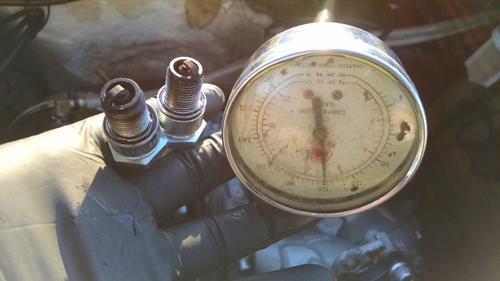

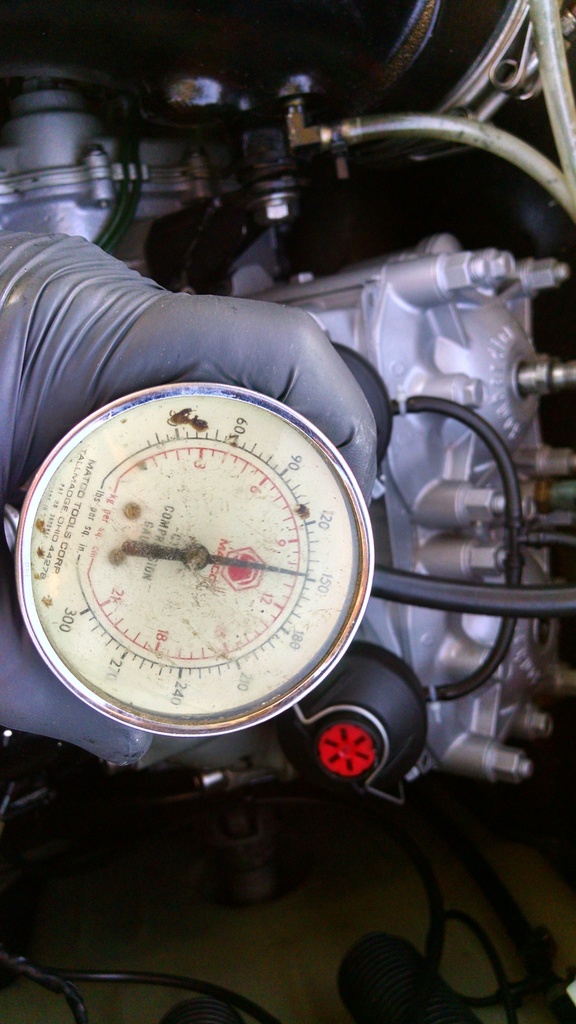

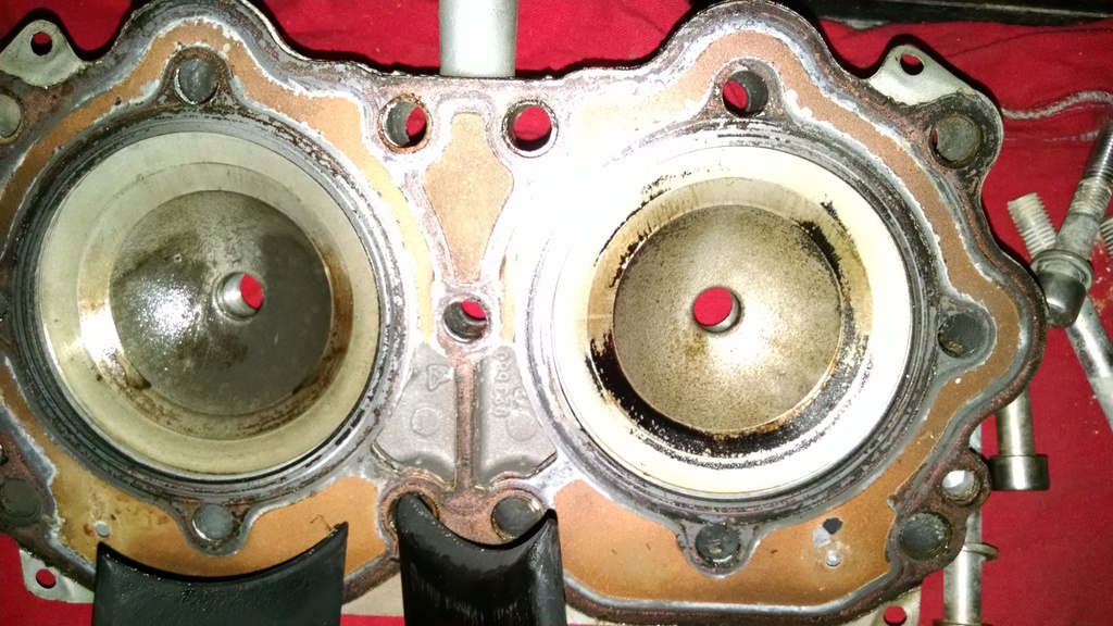

well i got the engine friday,put it all together friday night n hauled *ss to parker for a super boring breakin period.first tank totally sucked,second tank not as horrible.we ran 3 full tanks thru it,the last one tank was ridden as normal.idles perfect,smooth acceleration,but it will not rev past 6700/6750 ish.plug color was great,have not checked comp yet,will report tomoro.

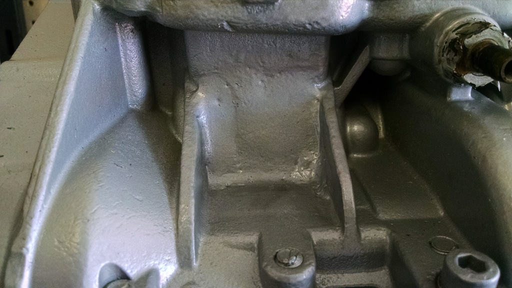

im not real happy bout the welded cases i got,since the cases im sending them are perfect!!

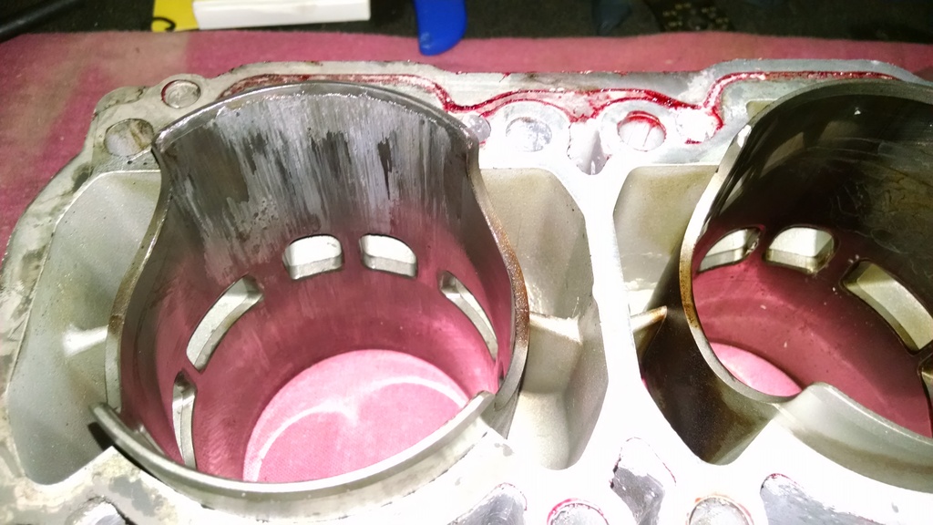

AND,i took a peek in the cylinders,what a horrible job they did when they pressed in the sleeves! some of the transfer port windows are off by 3/32 ish! my old cylinders are perfectly installed. cruddy machine work.

top pik is pto
bottom,mag
the light doesnt do justice as to how rich/oily the plugs look. ill throw new plugs in and report back next weekend on that lost 300 rpm.
