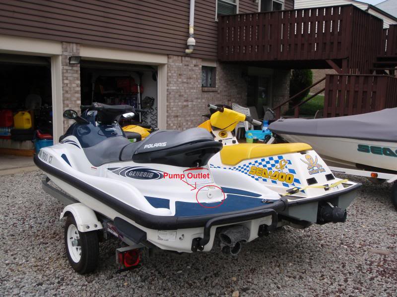

where do you guys usually route the output to on models not equipped with it from the factory? (I assume you would use one of the bailer tubes or something) I was thinking about grabbing a few for mine as a supplement to the bailers.
On my Polaris... it goes right out the back. It's easy to drill a hole there, and it's above the water line. (so water doesn't drain back into it)
Mine had a factory hose. it loops way up inside it under the seat, then goes back below the water line and exits near where the exhaust exits... that way water can't get back in, but you can't see it...
if I were to add a pump, you'd want the shortest run, and to have it exit above the water line... which on an XP is prolly the front 1/2 of the ski lol.
I would not go into the balers as they pull a siphon and it would screw all sorts of stuff up.... you need to make a new hole...
Purchased a bilge pump kit with a separate float switch. I'm having a hard time determining where to drill the flush hole. There doesn't seem to be an ideal location on the XP 800. I would be interested to hear from someone who has installed a pump on an XP. I'm thinking of bundling a section of tubing inside the back hatch. Connecting the pump to a manual switch instead of the float switch. When I need to flush water out of the hull due to capsizing, I just reach into the hatch and pull out the tubing and toggle the switch. When enough water has been pumped out to allow me to re-board a little easier, just toggle the pump off, close the hatch and board. This is dangerous because if the ski capsizes again due to a wave while the hatch is open, then your in real trouble. I prefer to properly install the pump. Any ideas?

ski-d00, were does the bilge pump exit on your 2001 XP?
The newer XPs with factory bilge pumps exit through the pump shoe, your pump shoe should have the same spot but it will not have a through hole in it, you could drill this out and use it easy enough. The 99 GSXL exits near the exhaust exit by the pump which you could do as well. The only thing you have to be careful about having an exit below or near the water line is to make sure you loop the line high enough so that water doesn't constantly enter the hull. Above the water line is safer but usually doesn't look as nice.
Thanks Sea-D00. I can see a spot that looks like a garden hose fitting and its not cut through. The hull is drilled out but the jet pump plate (I think that's what you're calling the shoe) is not drilled. I'll be sure to loop the hose high enough to avoid water coming into the hull. I will also add a simple check value that came with the pump.
