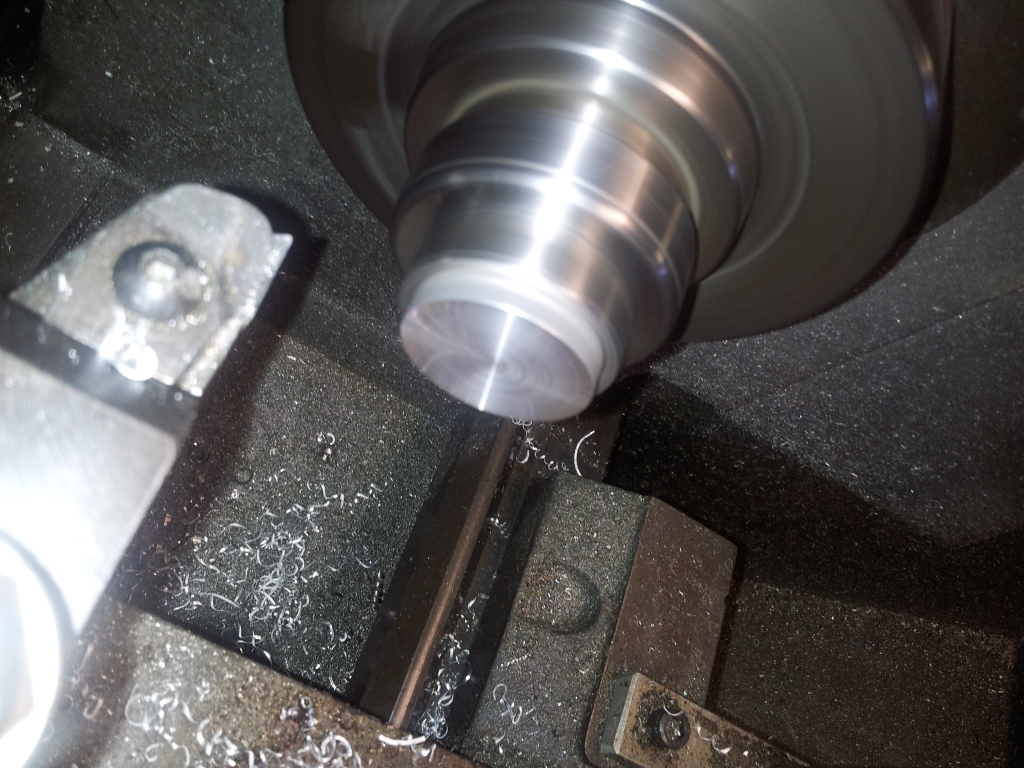

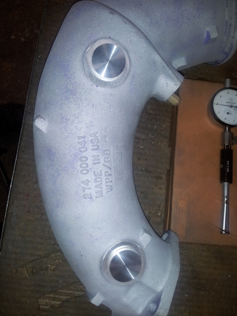

Well I made the plugs, I finally got some lathe time--work is always getting in the way. They're being welded over the next few days.

Your The Man !!!! Thanks for the Info because for my rebuild thread I am going to do this. On that link you sent me, is this the color (SATIN SUMPTUOS PURPLE 85025?) Also when you did the caps on the exhaust, was it fora particular reason ? fro the previous owner on mine part of where it is tac welded.....I guess te exhause started to break, but it looks like they used Jb Weld and its been holding up for far.
