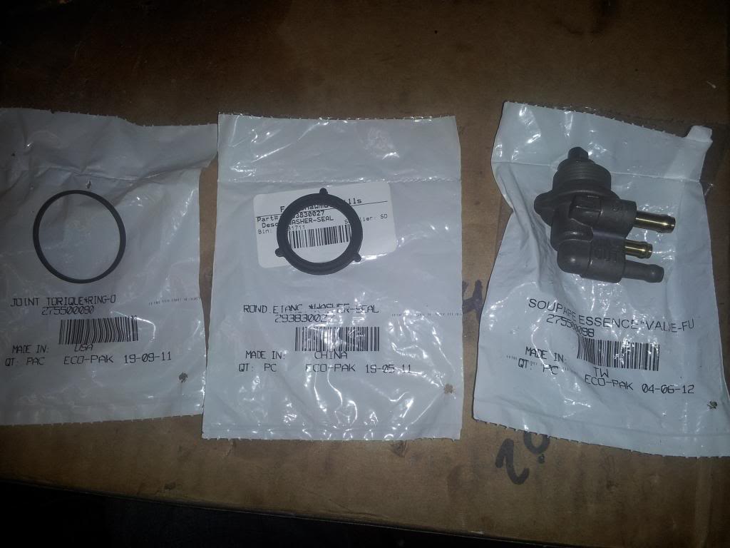

Last few parts are trickling in. Got the OEM shutoff vavle, VTS seal and the fuel filter o-ring. The OEM red start/stop button cover should be in tomorrow, dollar cheaper then the aftermarket ones, got it for $4.99 with free shipping. If I ever get to the machine shop to bead blast the carbs I can rebuild them got the rebuild kits and needle and seats. Then all that is left is a bit more clean up, final assembly, possibly a new fuel tank and recover the seat.

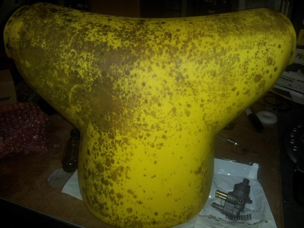

Having a heck of a time cleaning the handle bar cover. I know guys use the Ronsonol Lighter fluid, so I took the alternative which is -- Naphtha, and Ronsonol is supposedly pure naphtha. But knowing I would need way more than a few ounces to clean this pig I hit Lowe's and got a quart for $8.00. That would have gotten me one 8 oz bottle, so this was like buy one get 3 free! It did help but this thing is bad, I'm ready to bead blast it, it has seemed to work on every other part I wanted to clean up so far:D The right side use to look like the left. I have tried, gas, 99.9% Isopropol-Alcohol (the good stuff from McMaster Carr, not your cheap Drugstore water), Acetone, WD-40, Brake-Clean, Starting fluid, bleach, Castrol Super Clean and the list goes on. Somebody help a brotha out. I'm half tempted to install it and go to a vinyl graphics shop around the corner and have them wrap the darn thing in yellow vinyl.
I don't know if this makes a difference but I use (per Dr Honda), Zippo lighter fluid, it's the only thing that seems to touch the mold or mildew, or what ever the hell it is. Have you looked at the Black Tip neoprene covers? I used one on my 95XP 800, sorry I don't have a picture and the ski is put up for the winter.

From my research, Zippo is also Naphtha. I have looked at the BT covers, not available in yellow and to me personally the black just doesn't look right, I have a slight addiction to the color Yellow. If they had a yellow one, I'd be on it like stink on S... I was also thinking of buying a yellow wetsuit on Ebay and having my Mom stitch one up. Thanks for the suggestions Lou!

Might be a little far fetched but what about sanding it with about 1200-1600 grit paper then painting it.
Have you tried Lacquer thinner? It's pretty strong stuff.
Yea, I kinda like the yellow too, in fact since I couldn't match the blue on my 96GSX I painted the handle bar cover and gauge cover yellow, it's the one in my avatar, somewhere behind Sheridan.
I used the Black Tip on my XP because the OE really messed the cover up, he tried to paint it black and I just couldn't get it to look right. I also like things original so when I get serious about restoring the XP I'll see if I can get an original cover from Nick.

That yellow paint doesn't look too bad, there has to be something to nuke this mold.
I know you are going for the stock look but maybe you could do this
http://www.seadooforum.com/showthread.php?50393-My-handlebar-cover-fix-modification
But just paint it the same yellow, if you get one from a 97xp it doesnt have info buttons
I'd be down with that, there was just a super clean yellow one on Ebay---I mean CLEAN. Just trying to stay on a short leash with the ducketts right now. I spent a while on the thread the other day, it looks good! I need to sell some stuff to pump up my Paypal, that's like my disposable income, so I don't take from the house money.
