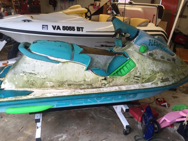

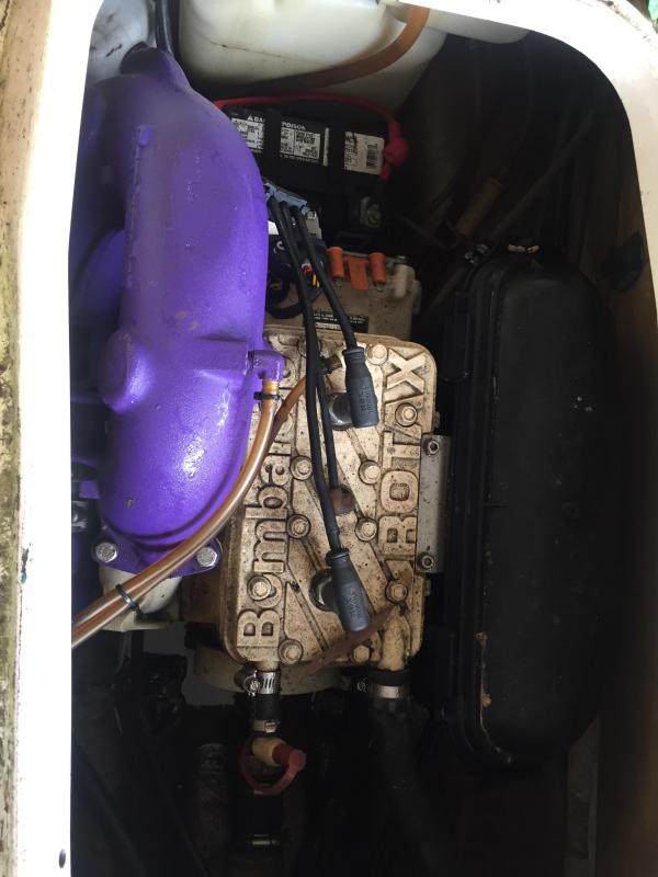

Well I picked it up the other week. Sorry I have been behind and haven't had a chance to update. I at least have it in the garage now and will hope to have some time to get into it a bit and see how good or bad she is. Looks rough but she will clean up. Not going to put the time into cleaning till I see if she is going to be worth fixing. (Notice the jet ski stand it is on....got off Craigslist yesterday. 2 for $100!!!! Guy bought them from a local Yamaha dealer that folded then sold his skis. Claims they were never outside.. They look brand new and are built solid and roll nice!)
