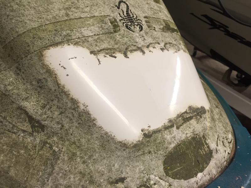

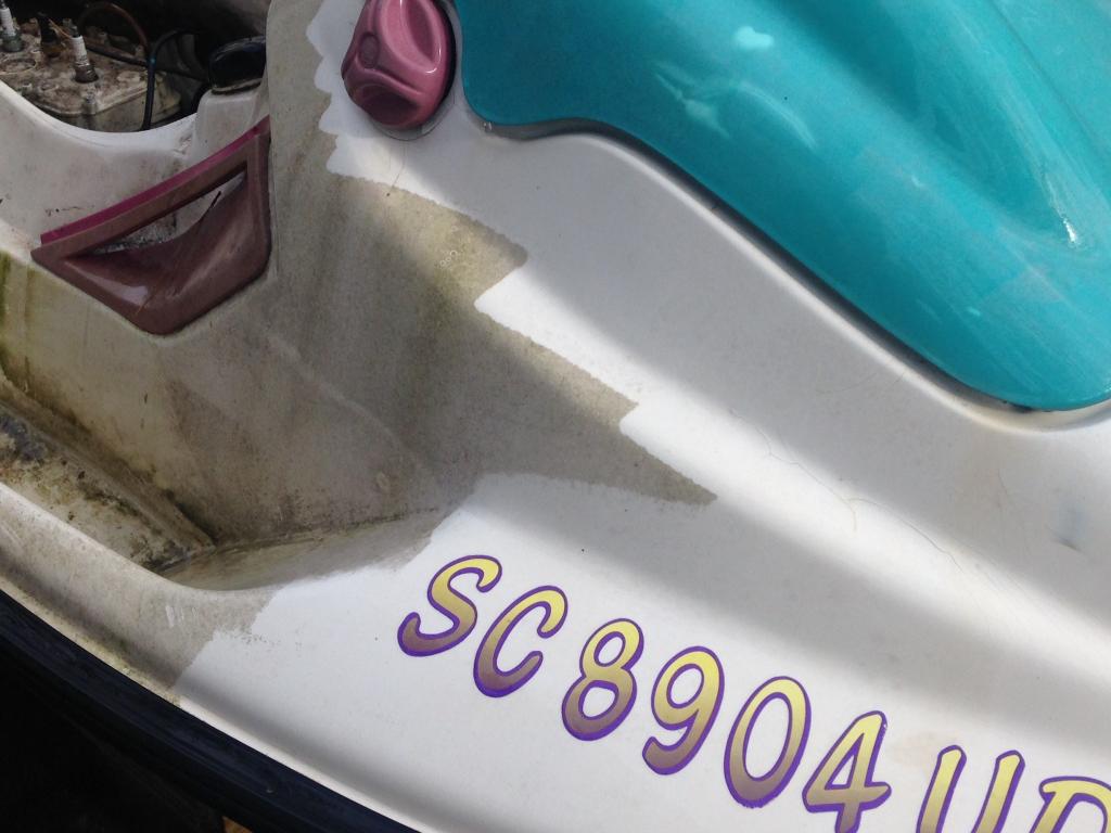

There is hope for all of them, it is just how much time and money you want to sink. Looks like mainly surface dirt, a powerwash does wonders lol.
Yeah I have seen power washers do wonders. Hope it will peel off a lot of the old stickers as well. A little chilly this week here to be power washing. Plus I want to make sure the ski is going to be worthy. Since I got it fired last night and comp was good and even I'm going to start on the basics when I get some time, fuel lines, tank drain and cleanings, oil filter, carb rebuilds.. Then once she runs well on her own I will move on to the rest of the restore. I will have to pull the pump to replace the wear ring. The driveshaft bearing is free. Is it recommended to replace the drive shaft through hull bearing? It was sitting for 6+ years. Hate to get on the water and it seize and rip that boot to shreds and start sinking lol.

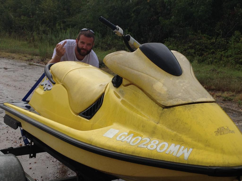

A buddy of mine bought a re-painted “95 xp” mystery ski with this setup I believe, it’s a 95 2 seater with no hole through the back for the exhaust, it is routed in through the pump area, however it has what looks like either a 657x or 717 looking engine in there but with the 657 pipe, Its all one piece with a rubber coupler holding the lower cone on. I’m enlisted to do the fuel lines/carbs/magic wand waving to get it going for this season so I’m interested to see how it goes…
This is the only pic of it i have at the moment.
It's likely a 93-94 xp if the exhaust goes sideways. If it came straight out the back it would be a 95.

the HIN has a 95 in it though, i suppose they could have just changed the tag over though... ill have to get some more pics on it next time im over there
