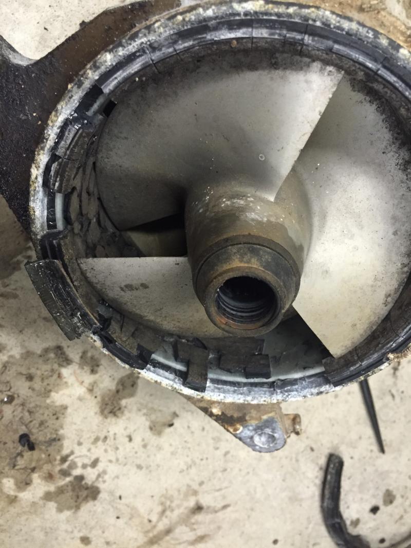

This wear ring should be ok to use right?
Rebuilt pump, new fluid, and wear ring last night. Ready to water test now before I put time and energy into the cosmetics of it. But with the high of 35 degrees today I think the test ride will be put off for a bit
