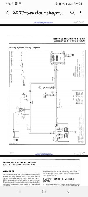

Base story- over the last year the ski has intermittently had starting issues which I thought was just the start/stop switch. If you pressed the switch a few times it would eventually start. Finally got around to replacing s/s switch and checking out old switch found it has seriously high resistance even when being pressed. So thought I was good to go - wrong. I was good for a few starts then suddenly it started happening more often. To which point the ski will never start now. Did some diagnostic (I'm a 20 year auto tech) found that if you jump the starter solenoid it runs fine. The start solenoid has 12v to it all the time and the ecu grounds the circuit. Tested the voltage at the solenoid and have good voltage. Tested the circuit from solenoid to ecu wiring has .03 ohms. I'm left with only thinking that the ecu is bad, BUT I'm worried there's possibly something else going on.
Can't find any info on any prerequisites the ski may have that would prevent it from starting. I know it checks the dess key but what else? Anything like in the auto world where you have a neutral safety switch, maybe a rollover switch or some sort of fail safe. That would tell the ecu its NOT allowed to crank. Don't wanna put a ecu in if the ecu is being told it can't start. (I have tried both keys).
Any info or help would be appreciated.

Jump start, low battery recently, or charge battery? check the output ground signal to the solenoid right at the ECU when the start button is pressed which is the B-31 position. Then check the ground circuit from the ECU to the bus bar on the small fuse box and the ground circtuit from the buss bar to the DESS post and back to the ECU, positions B-17 and B-26.
I suspect a connection problem in one of these circuits. The reed switch may be good on the post but is the ground circuit connecting?
