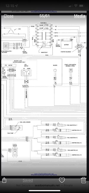

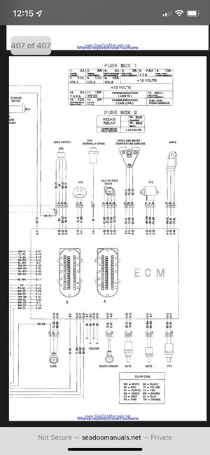

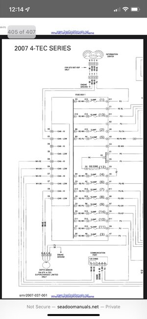

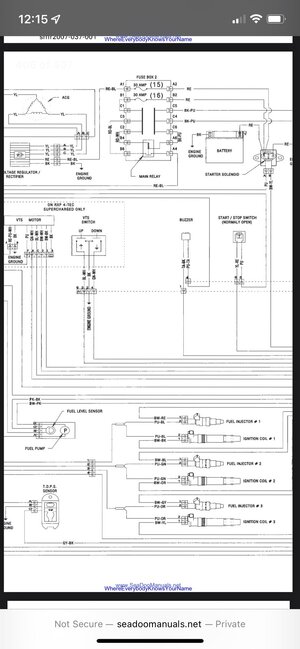

I have the 30amp relay in the fuse box both are working fine and the mpem was discontinued 2006 I believe, here are the wiring diagrams if it helps!

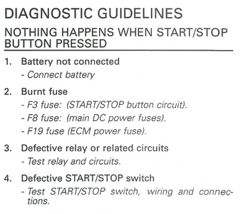

You need to test your relay circuits and make sure they are powered and grounded, also if the start/stop switch is stuck closed (normally open) it will act like what your sled is doing. Worst case scenario the ECM is not supplying the ground to the relay when it should.
