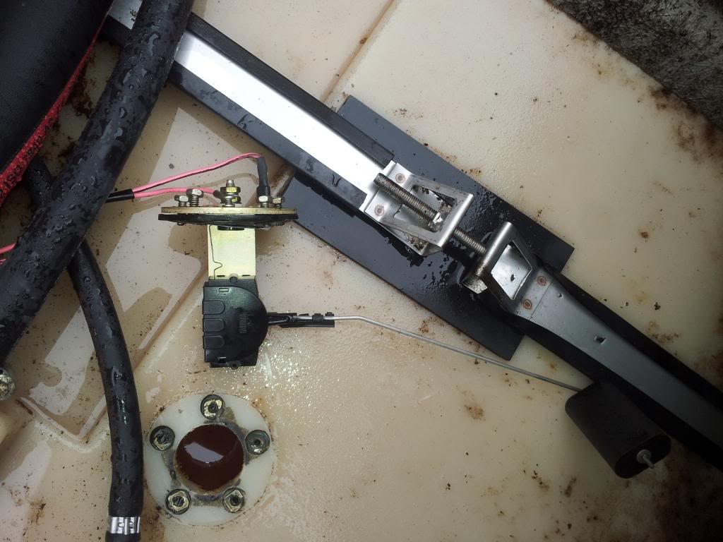

Here is what mine looks like:
but all of the ones I see are a tube.

That's not a sea doo float system. Can you post a pic of where the fuel lines connect?
****edit***
ok... I dug around, and that boat used a merc sender. Pull the wires, and put a meter on it, and see if the resistance changes.
That's almost just like the one in my Glastron Boat, except mine doesn't have the square black thing attached to the float rod.
****edit***
I want to make sure I am understanding what I think you are saying. Disconnect the 2 wires from the thing in the picture, then put a meter on what exactly?
The 2 wires should be on the center terminal, and the other is just a ground.
Take them off, and hook the meter to the terminal, and ground on the sender. Set the meter to some resistance value. (you may have to try a few to get the right range, if the meter isn't auto ranging)
Then, have a helper move the float arm up and down slow enough that you can watch the meter. It should go up and down with the movement of the float. If it doesn't, or the value on the meter jumps around... the sender is bad. If it checks out... then the gauge has gone bad. (but the probe is NORMALLY the sender)

I only have 2 wires. One was attached to the center terminal and one was connected to the blade connector on the side of the top of the float sending unit
Should I add a 3rd to the ground?
Here is what I accomplished today.
When I turn the key on, the red light on the gage comes on and teh needle moves a little, but jus sort of a "I have power now" kind of move like the speedo and tach do.
I used a multimeter and put 1 lead on the center connector and the other on the little blade connector. Moved it up and down and nothing.
Did the same thing with my new float unit and resistance goes from around 1 when the float is in the empty position to mid-90's at the full position.
Installed the new float unit and Hooked it up and still nothing on the gage.
I tested the 2 wires. One is a hot wire when the key is on, the other is not.
But I DID notice that with the amount of fuel I have in the tank tight now, the resistance on the float unit reads 74 when I connect the multimeter to the 2 terminals (one on the center and one on the blade connector on the side of the top of the sending unit). When I turn the key on, it drops to 1. That is with the hot wire on the center terminal and the other wire on blade connector. If I disconnect the one from the blade, the resistance goes back up to 74.
Is it hooked up wrong and missing a ground?
**EDIT
I went out and added a ground wire just to see if it would really be that simple. So both wires on the center terminal, and the blade connector connected to the ground. Still nothing.
