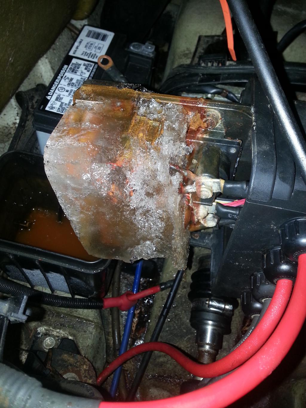

So I had to repair my neighbors snowblower tonight so I had the heat going. After I finished I took out the rear ice box, I mean e-box. I have a sneaking suspicion the engine is going to look the same. I already have a clean rear ebox in inventory. I put my battery in but before I hooked it up I popped the box open.

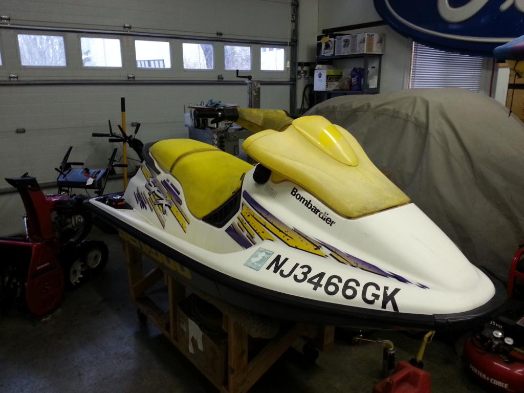

Also drug the SPX to the local car wash today before the bad weather hit and got it put in the shop.

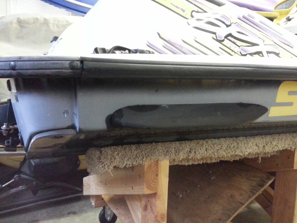

Black is faded pretty good but I don't see any major rash on the bottom, just some usual scratches.
That ebox! That is insane, hope the engine isn't the slushy to your already frozen treat
Oh, I can guarantee it is. I'm waiting for it to defrost to see if I can turn it over and it the carbs will work with the throttle, LOL.

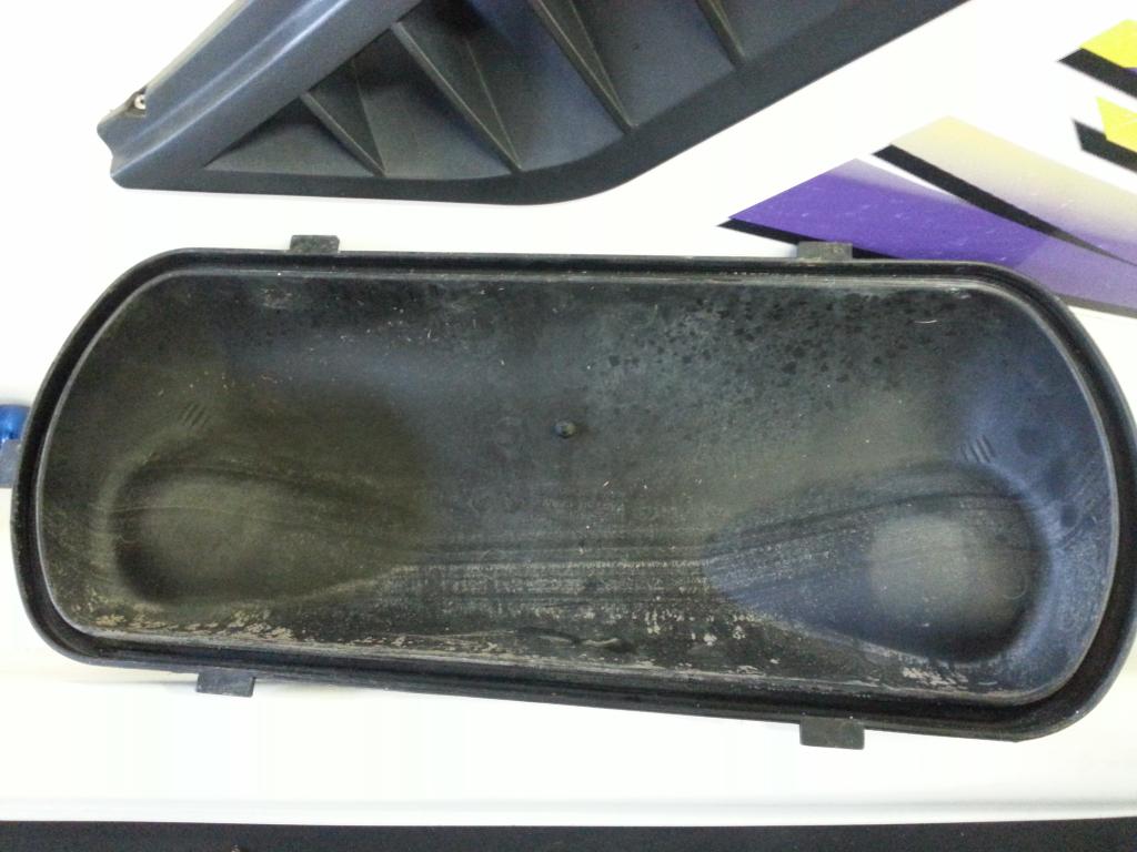

Tasty, sediment lines. That is the top of the air box. The bottom is closest to you so I think the water was pretty deep in there. I pulled the PTO RAVE and it looked half way decent for never being apart.

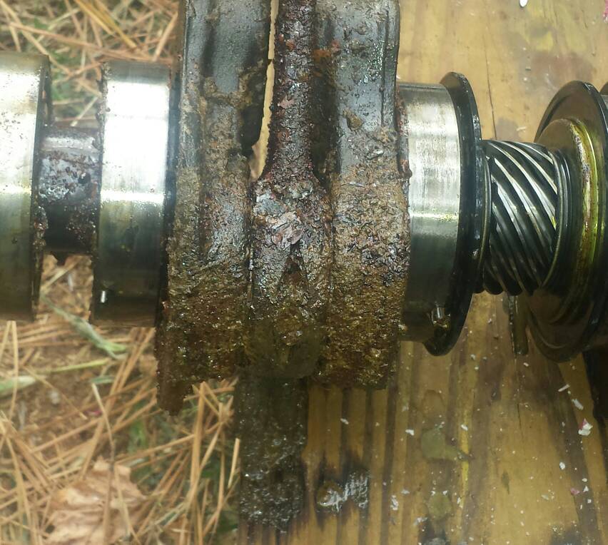

There was a half gallon of water in the cases of that first one I bought. Praying to the seadoo god's for you lol
If I know racerxxx it doesn't matter what that crank looks like.. It's getting an oem one

Did a little work tonight. Popped the air box off completely. She definitely is not healthy. Amazing what can hide behind the flame arrestor.
