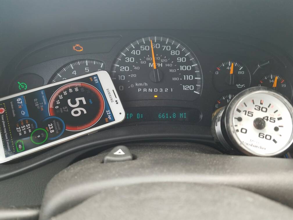

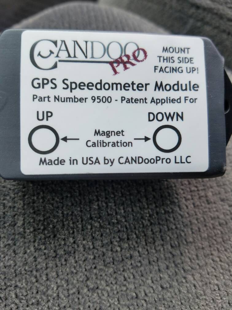

I calibrated and tested the Candoo today. Calibration takes all of about 10 seconds as the gauge should read 50 mph when you turn it on. If not, use the supplied magnet to increase or decrease the reading until its exactly 50 mph. The speedo goes to 0 mph to tell you the satellite signal is aquired.
I wanted to test the accuracy before install since the single gauge hood is kind of a pain to split. Happy to report it was dead on to 60 mph with both my truck speedometer and a gps phone app!

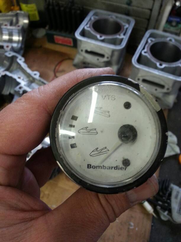

Thnx for the vts offer, i have a minty one of those on the ski.

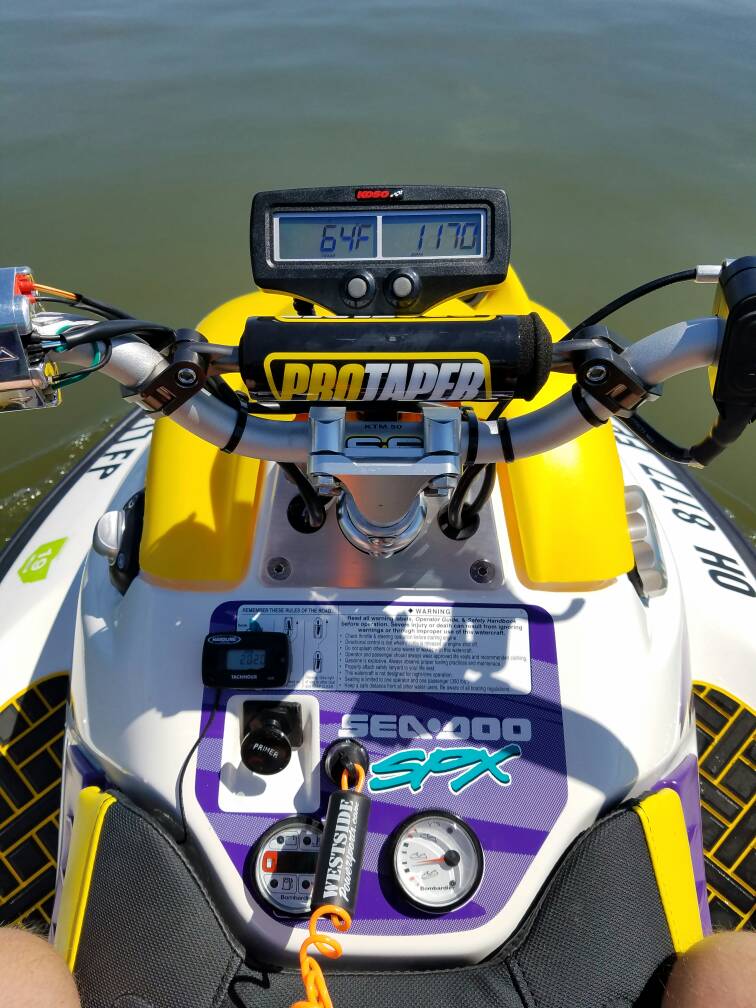

In this pic it was idling so was 1170 RPM. Had it switching back and forth from egt to water temp and rpm.
Oh, haha i forgot abt the Hardline tach and hour meter i temporarily threw on to see how close the two read. The hardline needed to be set to read correctly and i didn't bring the instructions so i just ignored it lol. It was reading 2x for rpm.
