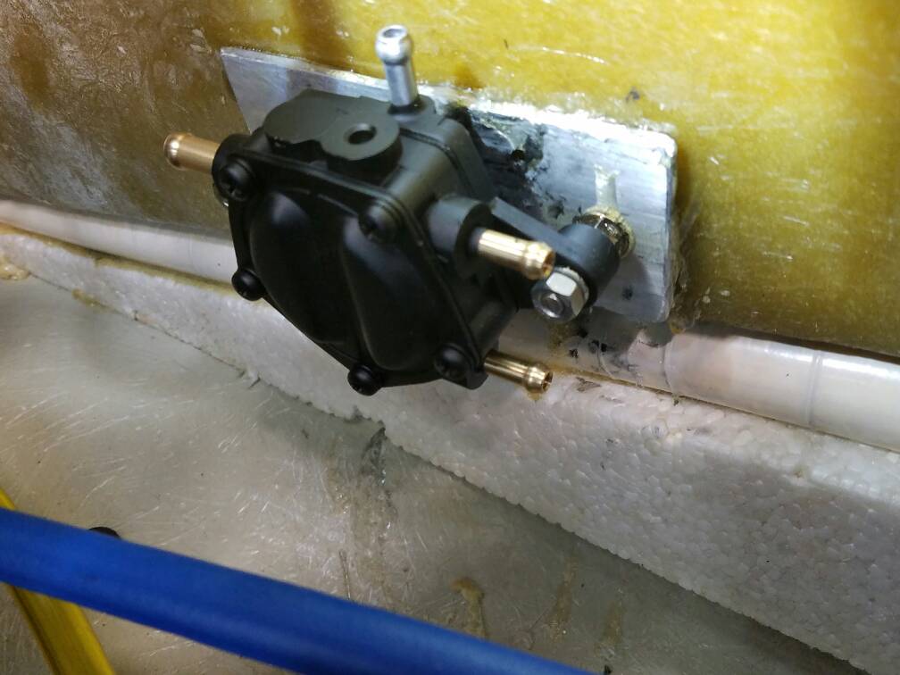

Thanks guys. I'm running 2 strainers. A larger coarse strainer that I made a mount for and then the FPP strainer.

Feeling like a plumber...
Still waiting on a new main strainer. Just realized I accidentally ordered the 3/4 size. I did get the mounting bracket made for it.

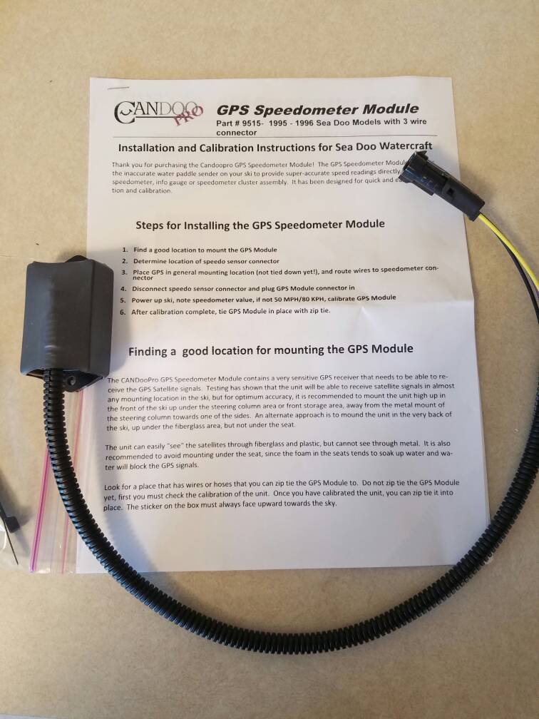

Got the candoo today. They had actually never had anyone ask for a 96 xp before so after some pictures of connections Jeff made up one that would work. Install should take about 5 minutes.
He even used one of my pics in the install guide, lol.
