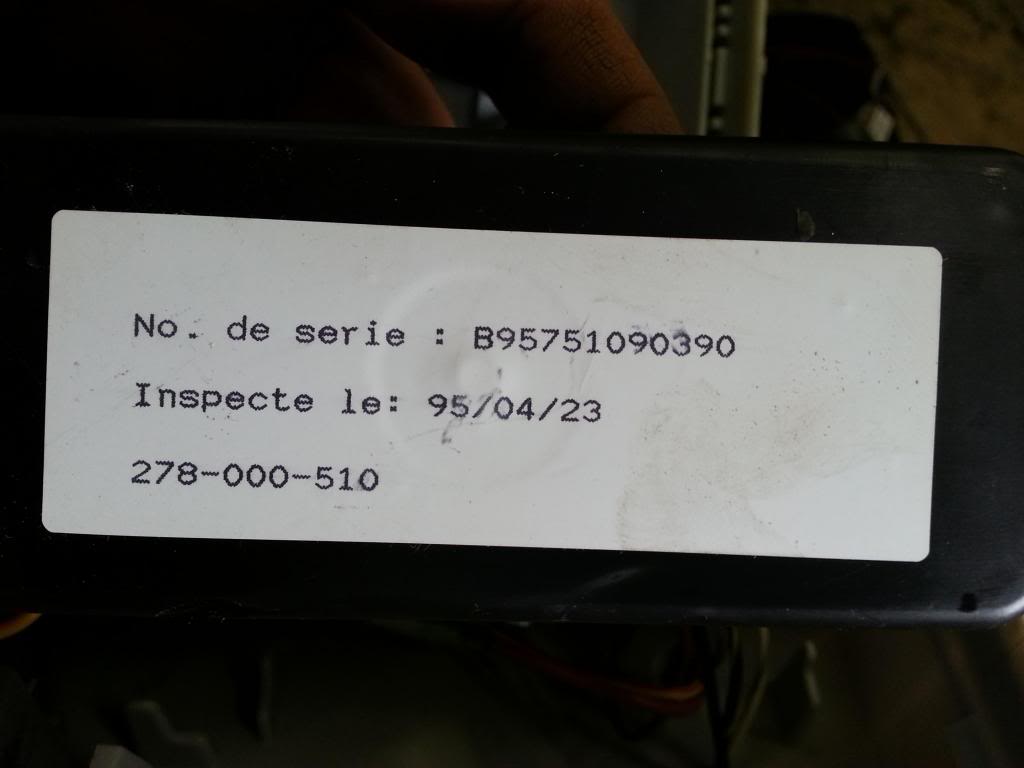

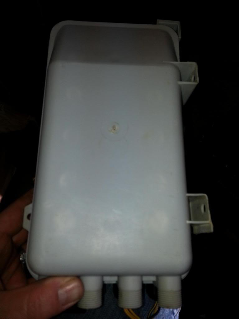

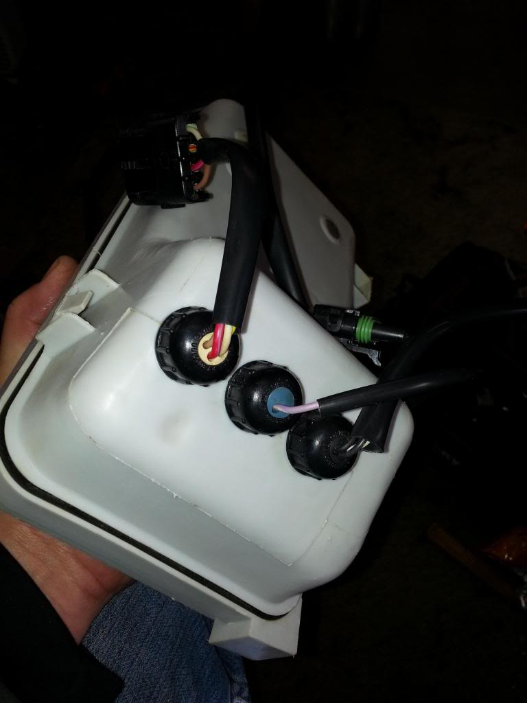

Front E-Box is minty fresh and is sporting the correct 95 MPEM, it was inspected just a few days after the hull.

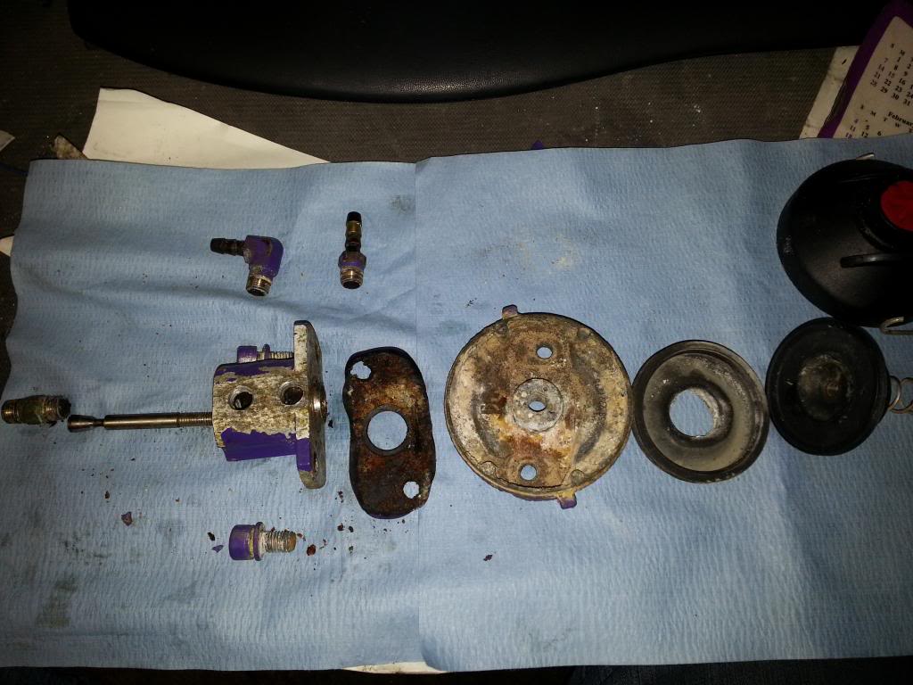

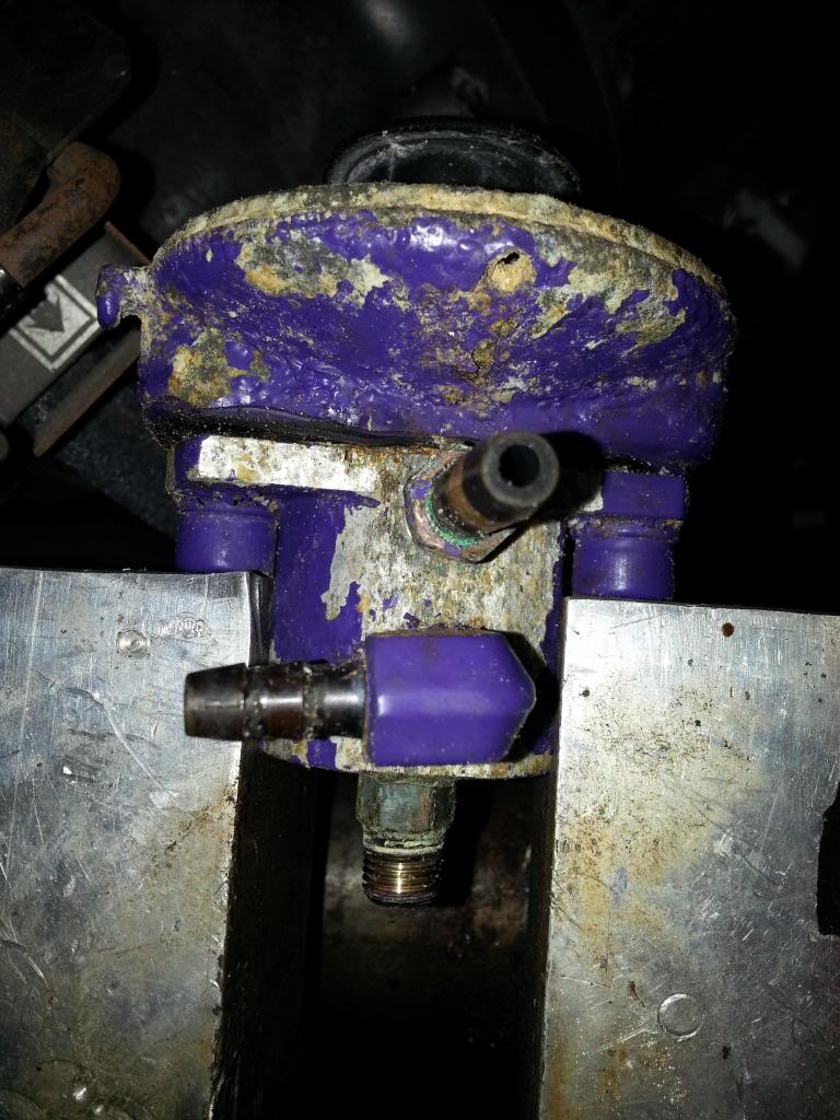

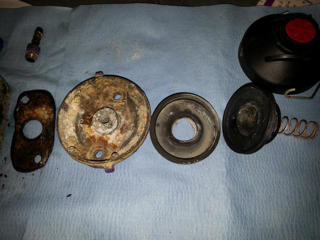

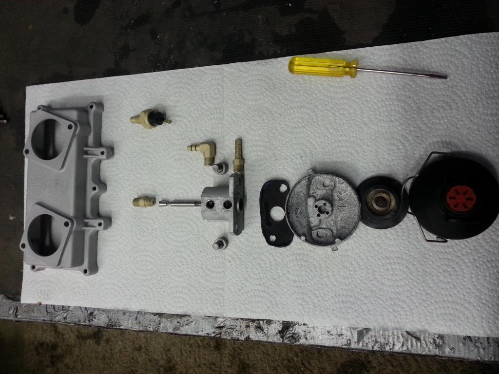

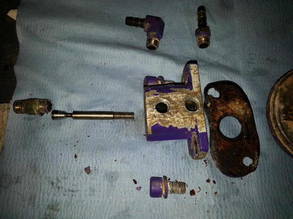

Here is the original style water control valve and was in amazing internal shape, the exterior leaves much to be desired. Pretty sure I'm going to use this one after a rehab. You actually have to remove the fitting that connects it to the water box so you can dismantle it.
That WR is quite the contraption compared to the others. Doesn't look like it was functional the last time it was used, a little bead blast, some filler and paint and like new again.

Oddly, if the rubber bellow wasn't rock hard the pin moved so smooth and the ports all worked correctly it probably would have worked. It's a pretty trick set-up, but so not cost effective to manufacture.

On the "rubber boots" I was referring to the green things under that clear glue inside the VTS. Those seal things they use on all the connectors.
Also...just to point out another 95 thing, the part number on the CDI in the 95 ends in 810, 96 is a 811.

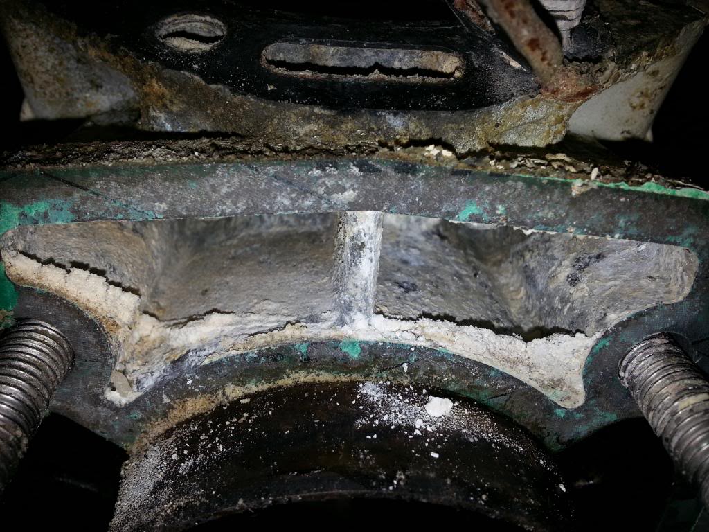

Did some bead blasting today which turned up nothing but crap parts. Head-Junk, Head cover-Junk, WCV-questionable, Flame arrestor housing-Mint, Temp sensor-Mint(if it works, but it looks nice!) Jugs-waiting to have the broken bolts drilled out. I love galvanic corrosion so much, it's like we were made for each other. I was going to cut the welch plugs off the head pipe and make new ones to get welded on but low and behold a previous repair looked like someone let a 3 year old loose with a right angle grinder. There are dice marks all over and they ground the casting finish off around the bungs and it looks like crap so I'll be taking that to the scrap yard for scrap value, along with some copper to make me feel like I got a decent penny for the pipe. I thought I had an extra head pipe but it looks like I have about 3 mint 720 complete pipes and 2 or 3 787 bottoms. I'll post some more pics later of some other stuff.....

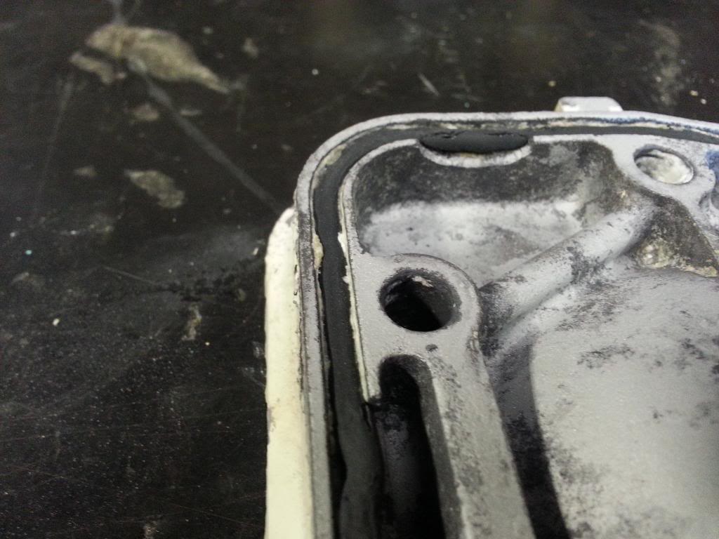

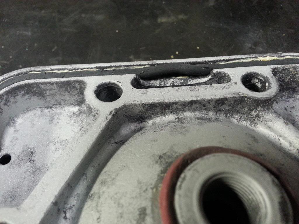

Head cover seal track is broke off in 3 places, darn shame the domes were mint. The corrosion was so bad between the o-ring that it puckered the thin walls right out

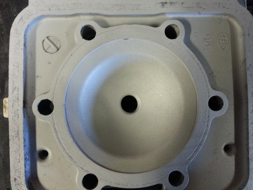

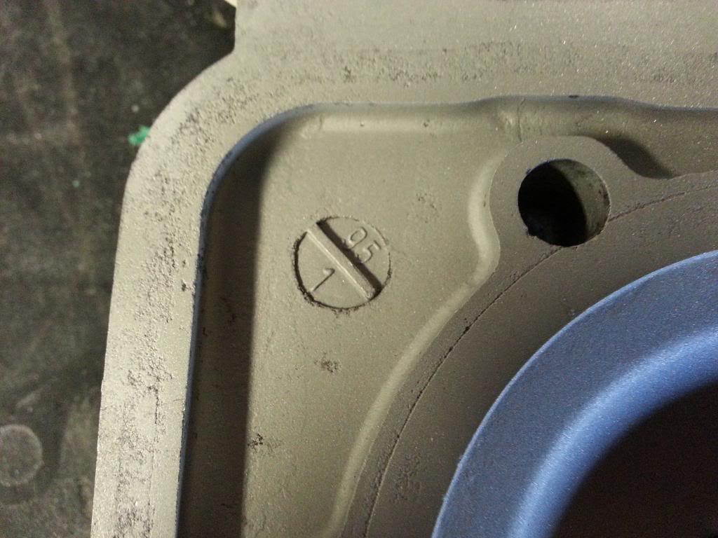

Head was manufactured January of 1995

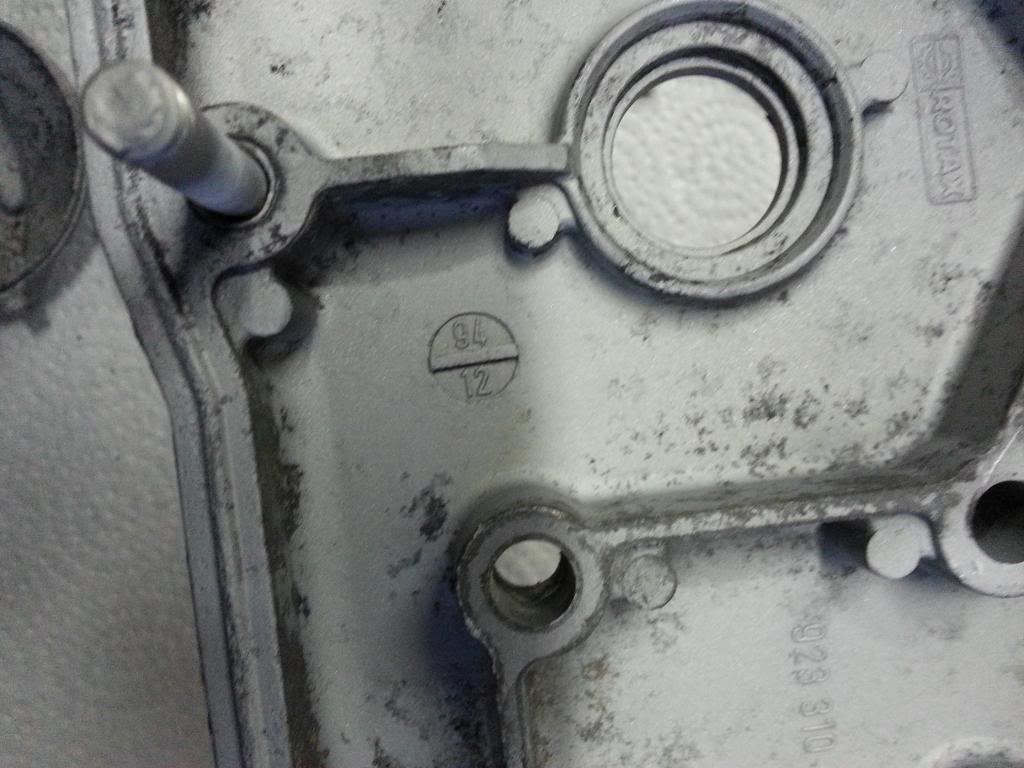

Head cover water outlet rotted. Head cover was manufactured in December of 1994

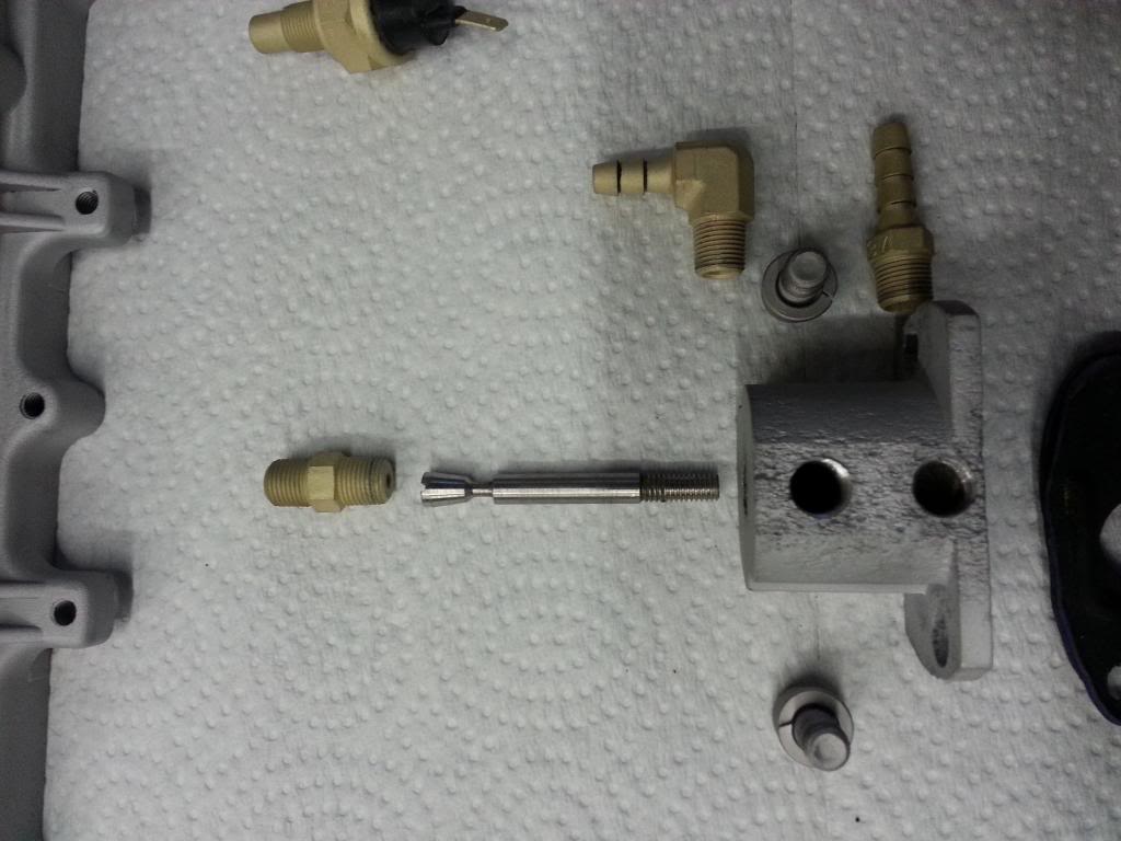

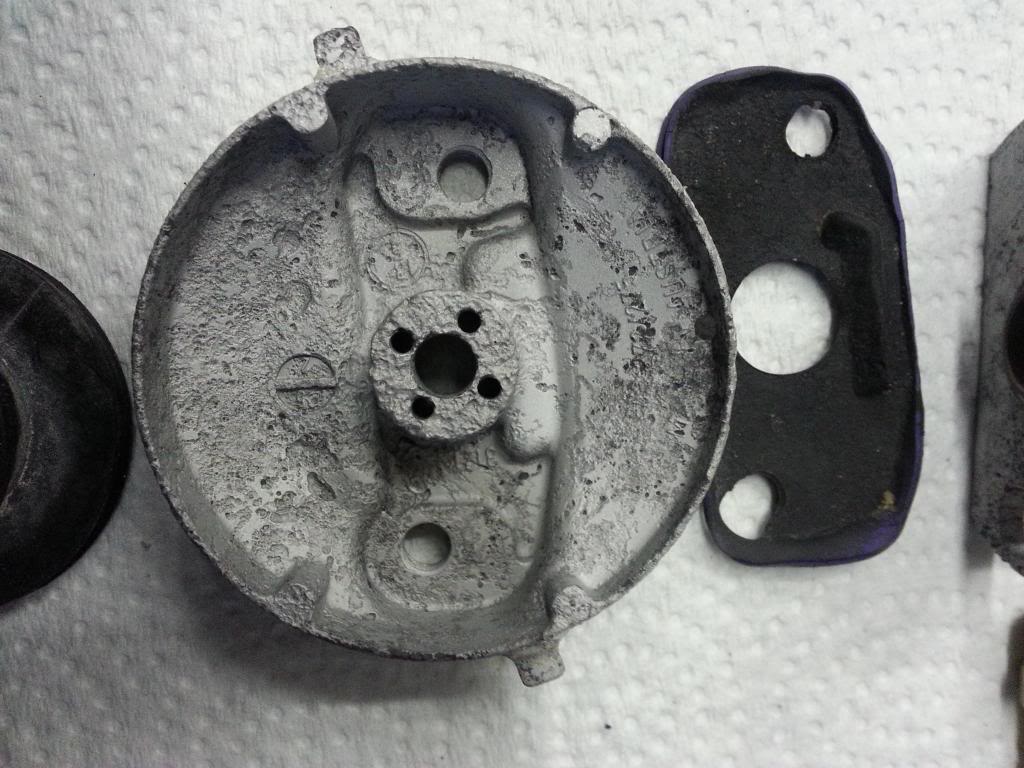

Blasted the water control valve and chased the threads on the lower mount. The upper half is the questionable part. Even bead blasted the black gasket

I have been looking over all my pics of the head (head is at the machine shop) and I'm taking it to the welders tomorrow to see if he can weld those 3 spots then I'll machine the o-ring groove back in. I have to figure out how SBT replaces the water nipples on their head covers, the one SBT I put in that guys Challenger had one replaced and they glued one in. There might just be enough meat for us to machine a new nipple and either thread the head but make it so zero threads show so it will be invisible to the eye or I might just have to glue it in with some body panel adhesive. Any chance you have a 95 head laying in you bins?
I'm not trying to be rude about the situation, but Dan I think you might literally be the only one in the world who would care enough about the stamped numbers on the head, even if you were trying to resell it. They're just aren't collectors on these skis who would care about that, maybe I'm wrong tho. Lol. I can understand the water regulator and the short hose on the waterbox and the engine and the intake ports, but there is a fine line between dedication and craziness :) I mean all the heads are the same...just my perspective and I know you want a brand new total OEM ski like it rolled out in 95

I agree with CR...I liked the concept of a all 95 parts 95...but seriously at this point I think you need to just keep it as 95 as you can, and keep everything you can see 95...but that head. F it. Put a 96 in.
Ha I know I'm new here, and I don't know a lot of y'all personally, but your saying this to a guy who I watched paint the edges of his new gaskets so that they would look like the were original from the factory painted motor.... So ya, lol I could see how much those stamped numbers can mean lol.... I just wish I had half of that determination to make it original, keep up the awesome work!!!

Trust me guys, I don't take any comments the wrong way so it's fine, I know I'm eccentric and I'm fine with it. This is what pushes me, I just won't give up easily. Restoring things takes an extreme amount of perseverance, I like to hunt for stuff. Yes, numbers might mean nothing to the next guy and I will be making concessions on this build. Most guys don't have the resources I have, I can probably get this welded for a 6 pack, the water outlet--free at my FIL machine shop. My investment--time. I don't like to throw money at problems if I don't have to. This stuff is fun for me, just be glad I didn't document my 58 Bug restoration like I do these skis, you would have put me in an insane assylum--I was searching for sheet metal that was stamped correctly, the interwebs were nothing like they are today trust me. Guys restoring cars search for correct date stamps on parts, this is where the date coding comes from on my end.

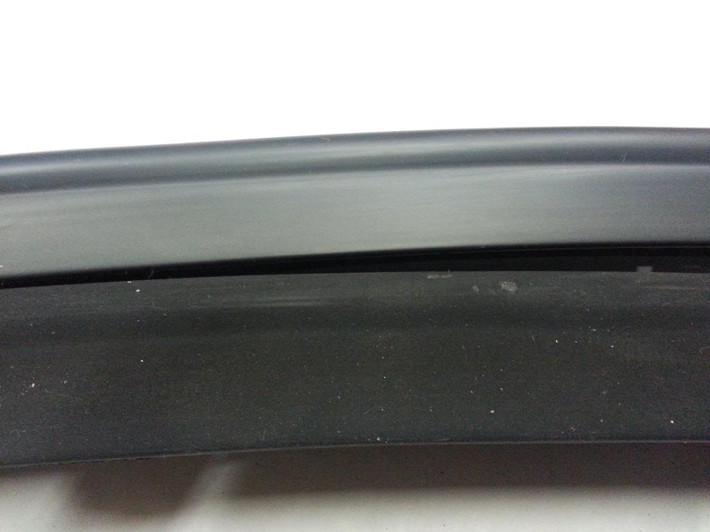

Here's the trim comparison. The one I wiped with the lacquer thinner the other is sun baked. I still need to polish up the rub rail but you can see the major difference. The bottom one is the sun baked rub rail.

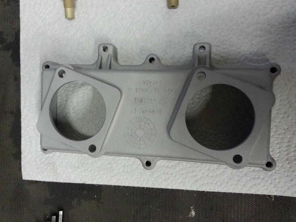

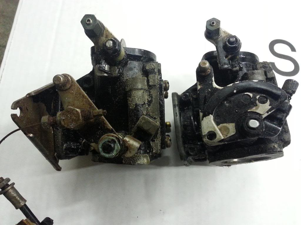

Another difference I noted on the 95 XP's was the carb has the old style linkage and the microfiche confirmed it.
