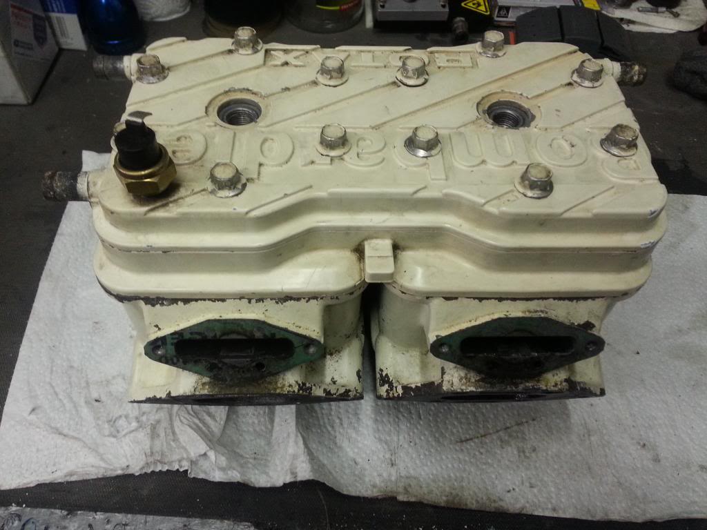

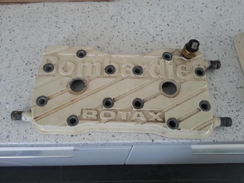

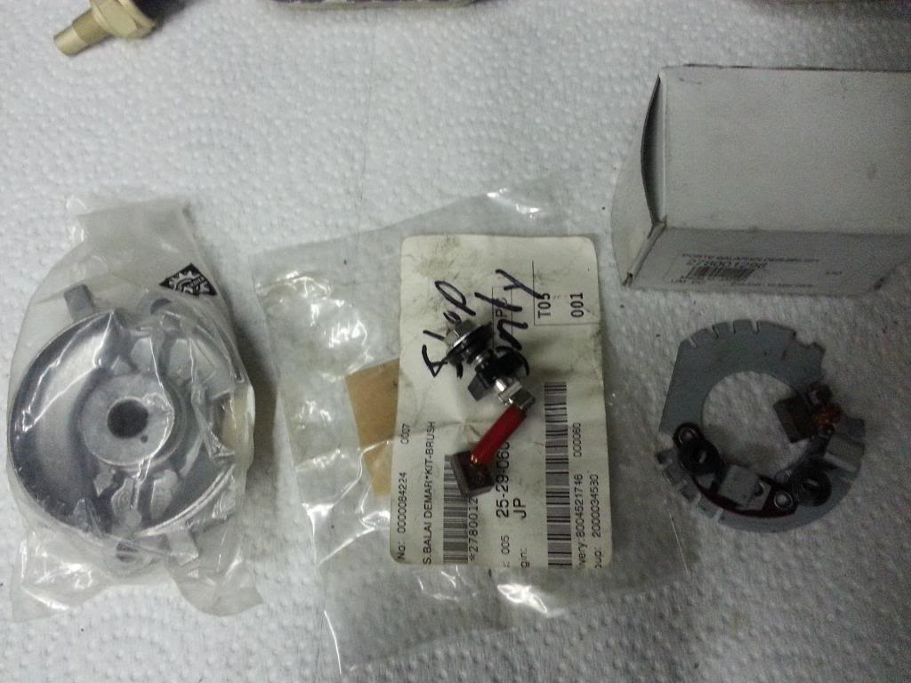

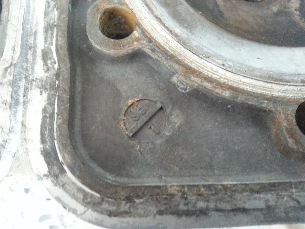

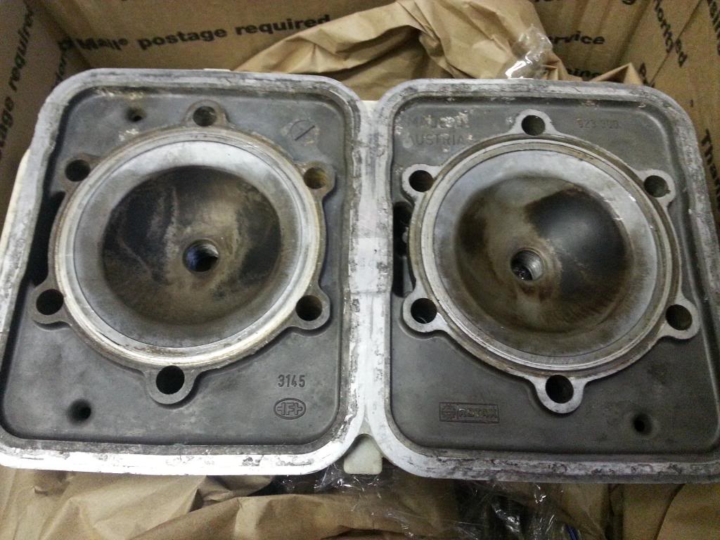

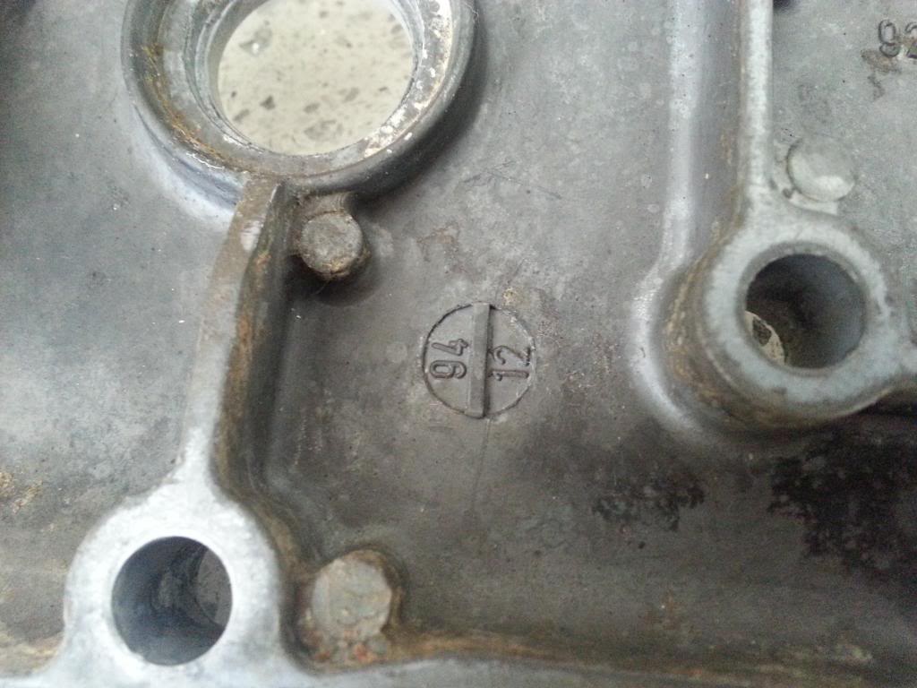

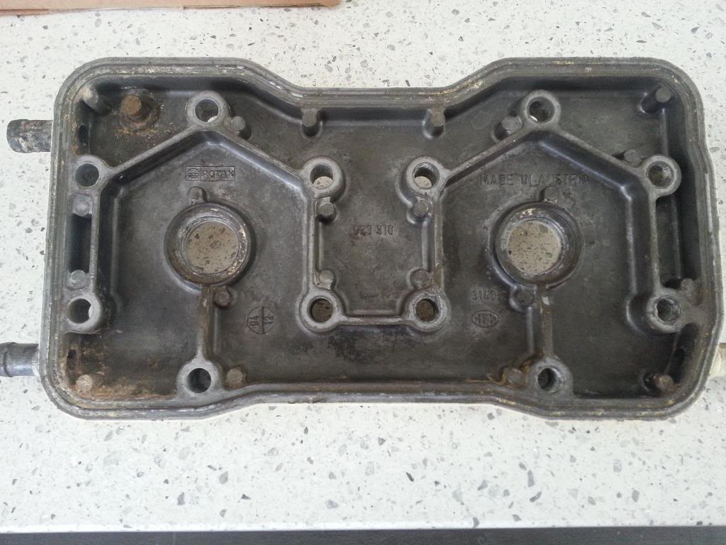

Well Gents here's the latest installation. As the only guy on earth to care if my date castings are correct, I just so happened to find an EXACT MATCH. I bought this head the day after I posted the original one was shot. I also have a batch of some new goodies that have been trickling in on the front door step.
Thanks for the goodies JSG!
12/94 casting date
1/95 casting date

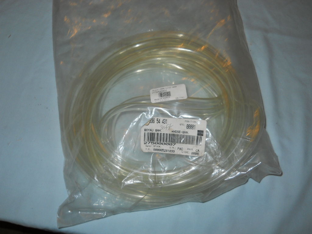

Brand new OEM water cooling lines and Bilge lines

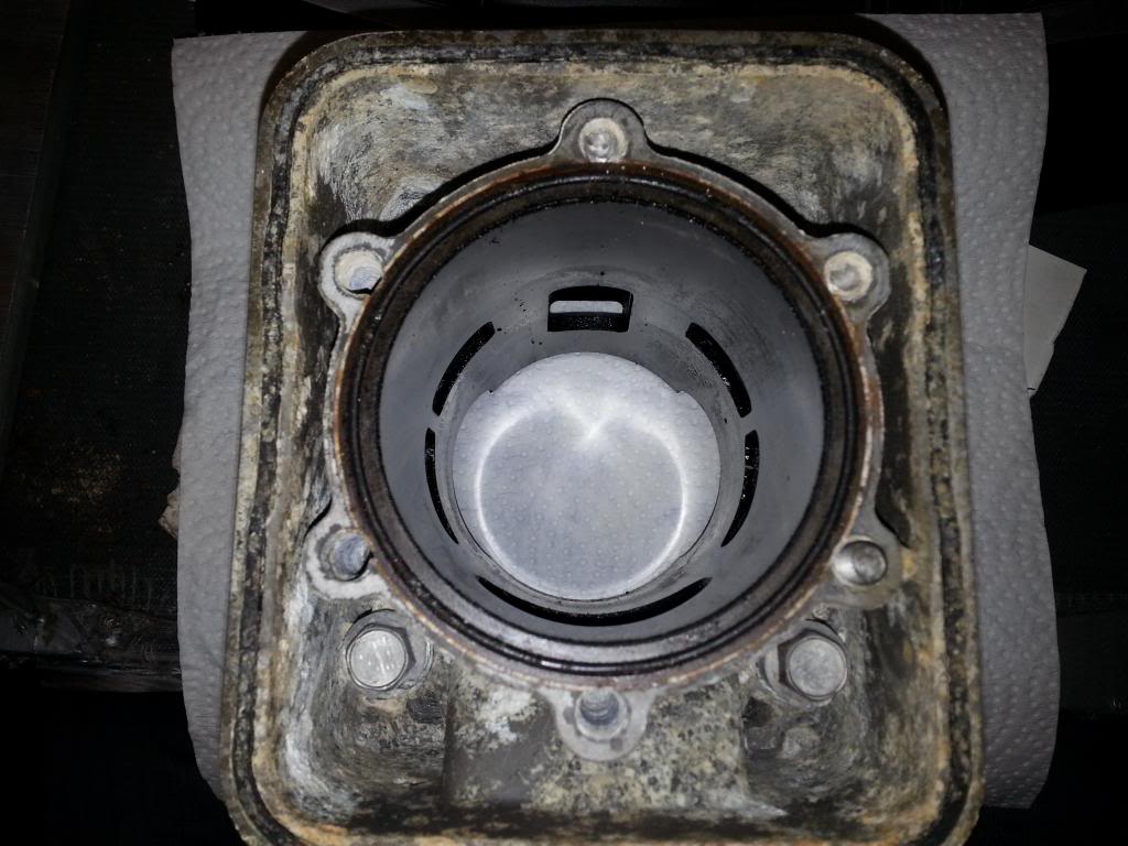

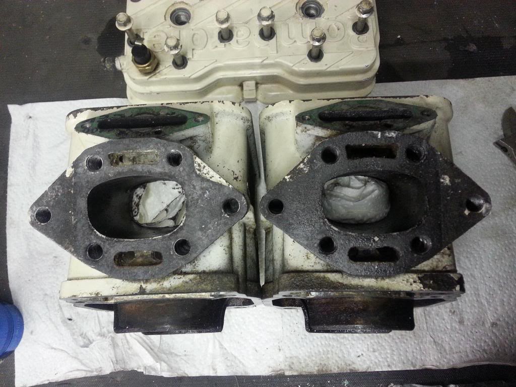

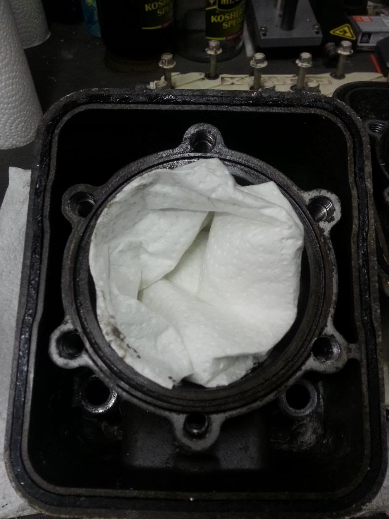

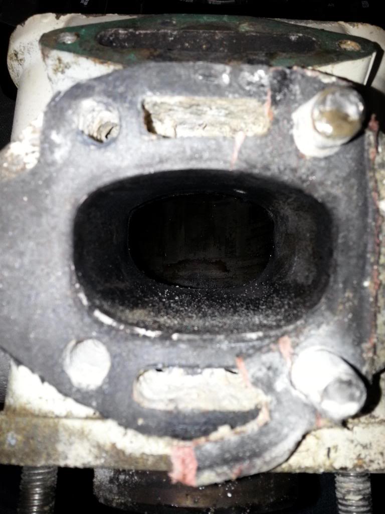

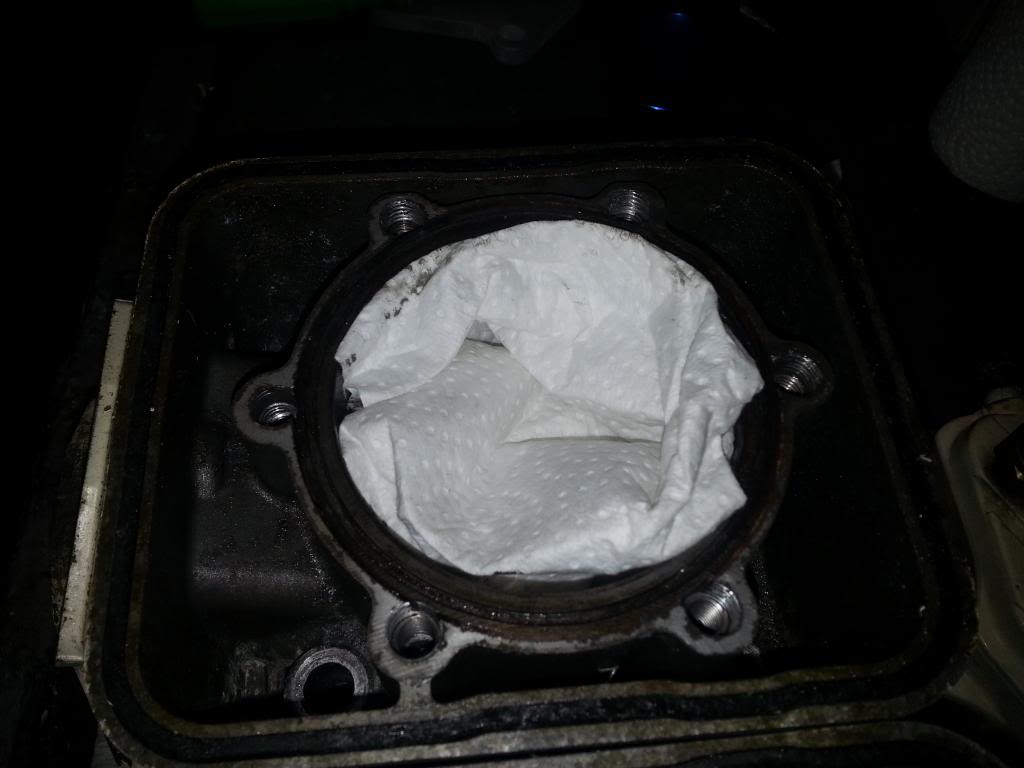

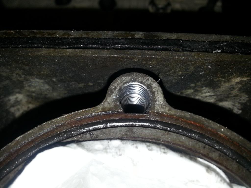

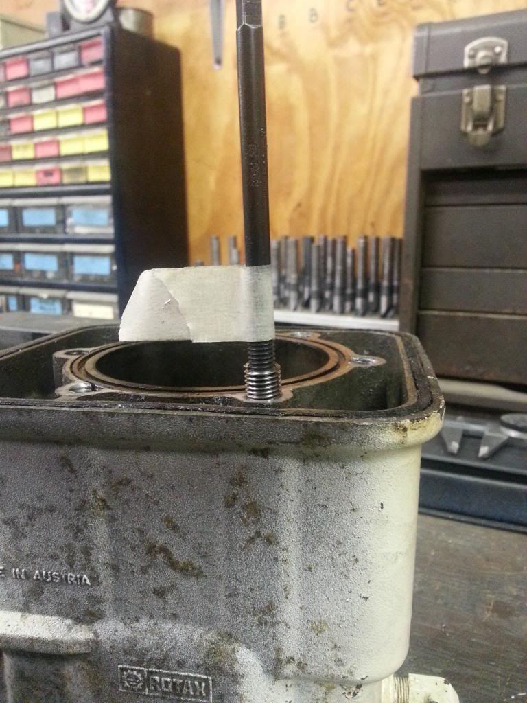

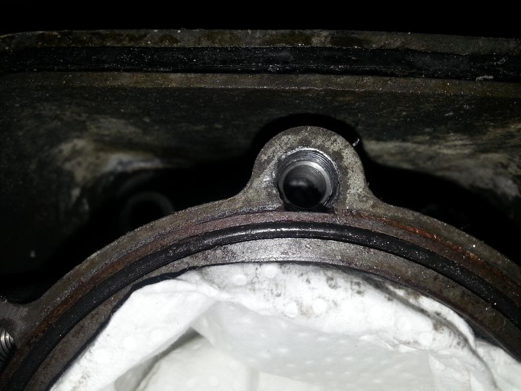

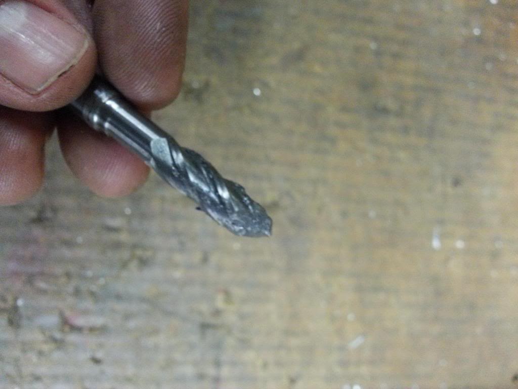

Thought I was gonna be in some serious trouble today. My father in law spent about 12 hours on this set, needless to say he was happy to see them leave the shop this afternoon. He said the bolt circle for the head was not correct about 4 out the 6 holes were correctly spaced but two were off on both, and not the same two either. So the stainless was a bear to drill, then he snapped a carbide endmill in one of the holes but managed to get it out---some how and I wasn't asking either. So he got them prepped up and I put in some helicoils in them, 5 out of 6 on one jug, and 4 out of 6 on the other. Now we're rock soild! Got the broke exhaust bolts out too. Saved two more from the scrap pile. I'll blast these clean later at build time.
Before:
Got my high tech depth gauge to set the helicoil at the same height as the original threads. There is JUST enough room to get a helicoil in there. The helicoil tap just lightly nicks the outside of the cylinder wall, BRP planned that one ahead of time I think.
Broken Carbide endmill
After:
You need to clarify for me. So the holes in the head were not lined up correctly with the bolt holes in the cylinders?? Is this because the heads and cylinders did not come as a set? I would think that they were all made within the same spec.
I am probably misreading it.
Basically they were not true from the factory. We assume who ever was running the machine that day wasn't on their A game. We had the correct numbers from a clean cylinder I had in there a while back, the numbers he came up with BEFORE he even turned the machine on were off, the two heads I have measured the same. He always checks the part he's about to machine--in case of irregularities which proved dividends on this go round. You NEVER assume anything. I forget the exact number it was off but there obviously is enough "wiggle" room in the head to line it up. There are a bunch of online bolt circle calculators but some how he has this info stuffed in his head from years of machining.
