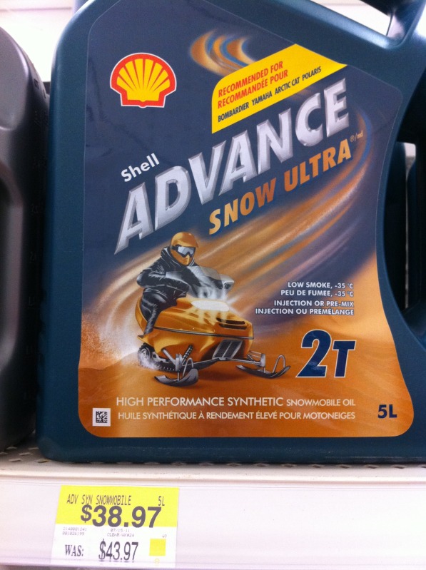

Anybody have any thoughts about this one? I didn't see a rating on it., but it explicitly says made for 'Seadoo'??
LOL...although I don't even remember if it said 2 cycle on the back. Doh.

As for the Shell I think the 2T stands for 2 cycle. Search for info on it, there is a chart somewhere on this site stating which oils are acceptable. The price is right if it is okay to use.

Next time you see that shell oil take a pic of the back. A lot of the snowmobile oils are api tc rated.
Yep... that's a API-TC oil You should be fine with it.
FYI... most snow mobile oils are OK since they don't run well on the TC-w3 stuff either. (it can't protect in the cold)
