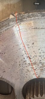

So i ran into some trouble. I tried bending 3 13mm wrenches to take the carbs off without touching the rotary valve cover, and it was unavoidable to take the rotary cover off.
I'm doing this on the beach and in sand and my knees slipped as i took the cover off, and I didnt notice the rotary valve coming with the cover... I was more worried about the rotary falling off after the cover comes off rather than it coming with the cover...
I'm fk'd. I don't have a timing tool and the engine is in the sea doo which is in the water on a sand bar. Are these timing marks on the engine, to the left of the red line??? Any tips? Really stressed and frustrated right now, with a long weekend coming up.

No you can’t use those timing marks.
You can print a degree wheel from the service manual. And use a screwdriver down the sparkplug hole to get tdc close. That’s about it.

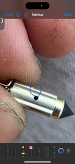

I'm almost ready to reinstall my carbs . However I'm having an issue with the needle valves on the sea doo sticking open after the popoff test. Basically it won't return down. I've been unable to reproduce it consistently but after about 10 or so popoff tests it's reproduced. It's almost as if the edges of the needle valve are catching. It is a new needle valve. Is this a common issue or is there a solution? I'm kind of dumbfounded.

It should not come out that far ever.
Are you using all genuine Mikuni parts?
Are you using WD-40 on the seat when checking pop-off?
I’m using gasoline because I ran out of wd. All genuine mikuni rebuild kit.
The needle valves are old stock bombardier. So genuine.
Could the issue be that I am pressurizing too quickly? I am using a large bicycle pump to test.
I’ve swapped the needle valves and it only occurs on one side. I am inclined to try and polish the four ridges on the needle valves or reuse the old one. After looking for weeks, all needle valves are 2-3 weeks out or OOS in Canada in the size I need
