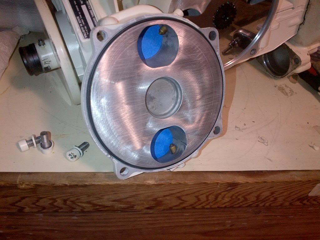

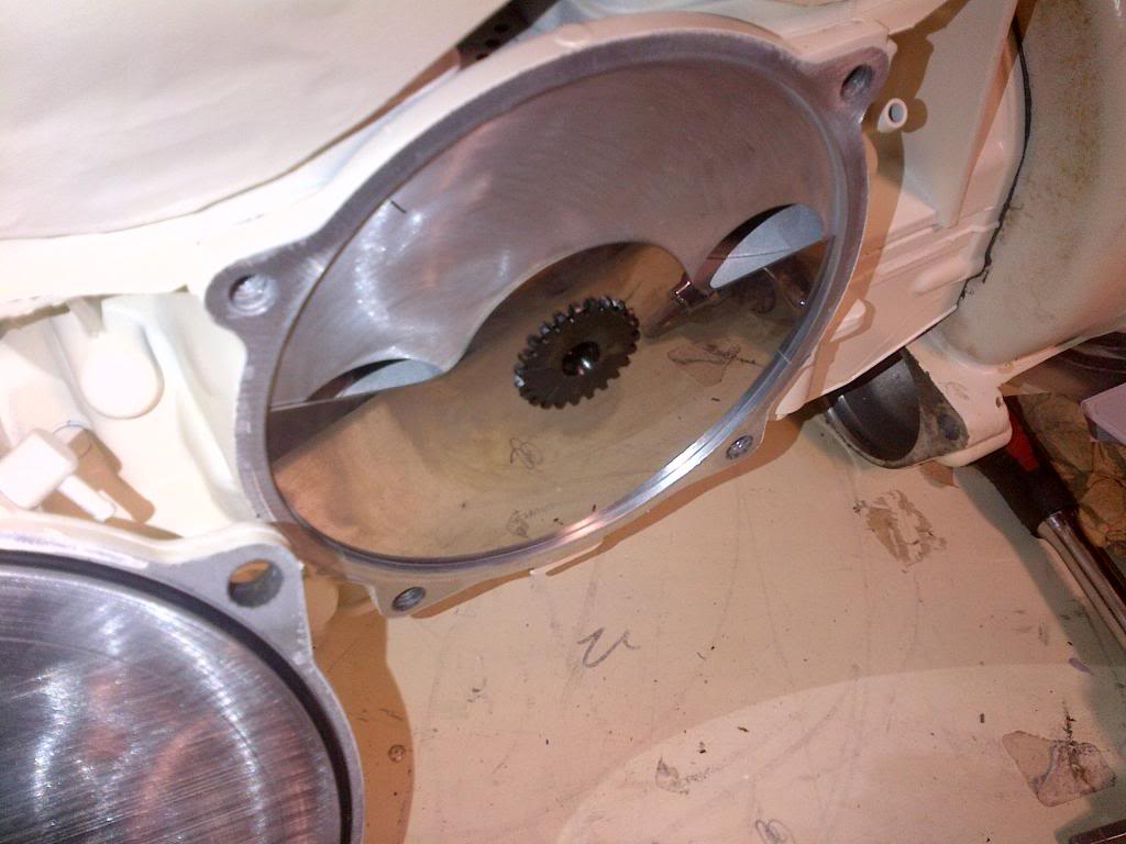

one thing i did notice when i went to put the rotary vavle cover/intake back on was the o-ring seemed large and didnt want to sit in the grove is that normal? or could it have been "pinched" creating a gap while it was on te motor witch allowed for an air leak?
A gap there would not be good, is there a kink in the O ring somewhere? Depending on how big of a gap there might have been, it could cause a lean/overheat situation. When doing a rebuild they should also check the RV clearance with the RV housing it should be 0.3mm-0.5mm of a gap.
This is what mine looked like when I installed it.
Any engine that has been apart should be checked for air leaks. It must be done. Did you check your' sfor air leaks?

so ive decided to run premix from now on once i rebuild the top end, so far ive removed the check valves and grub screwed the holes in the manifold and made a block off plate for the mag cover, the tank will be staying in the ski to lube the rotary valve.

ive removed the chokes from the carbys also and grub screw the holes left behind.
