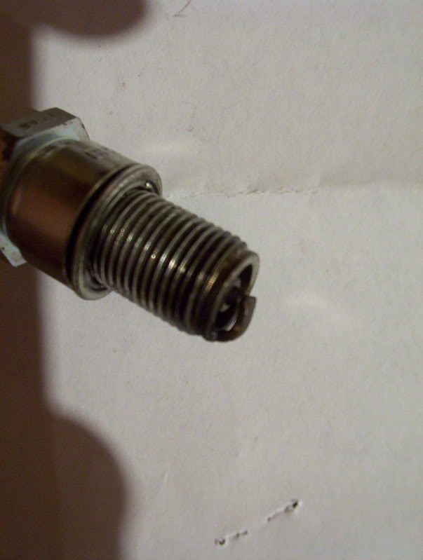

what can you tell about this spark plug?
raider352
i know its not the gratest picture but what can you tell about this BR8ES with low hours.
I can tell your right handed. that it's most likely a 951 engine, and that you took the photo above a piece of paper in your parent's basement.
and it almost looks like the piston hit it.
we need to see the ceramic
I can't tell a dam thing.
Bad angle, and blurry. BUT... as above... it looks crushed... but it could be the angle.
That plug looks hit!.Wrong plug.Engine heads shaved,Crank stroked.Rave valves gone loose.Broken ring piece.Some thing loose has hit it and maybe shot out the exhaust port

yheap its hit
so yea something did hit it but WHAT and WHY?? i saw 2 small marks on the arm there thats also making contact with the "electrode"? when i took the plug out.

Just judgeing the wash is somewhat white, indicating a rich mixture. IMO Threads/seal ring indicate it was not in torque spec.

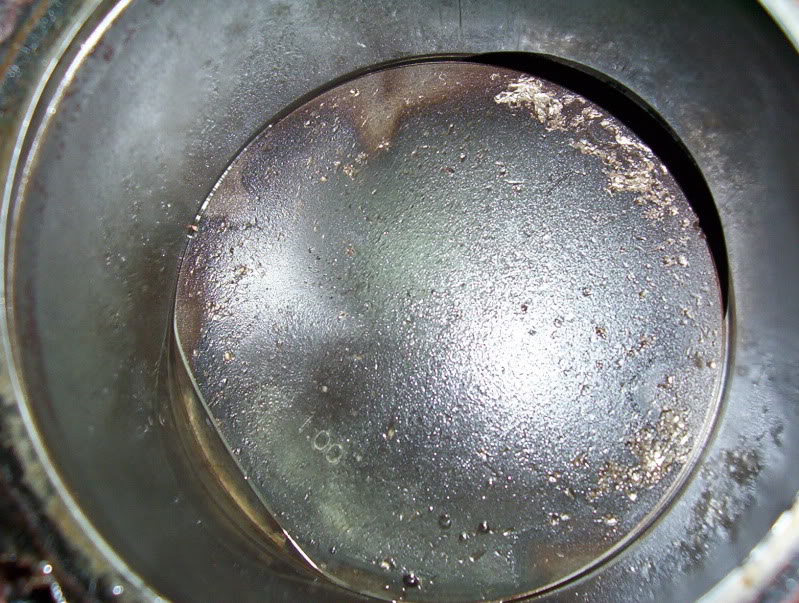

If it was hit while in the engine... it was a foreign part. The piston can't get that high. Even is you shaved the head... the piston would hit the squash band section of the head first.
If that came out of one of my engines... I would pull the head off, and check for other damage. If you cracked the piston crown at the rings.... you may have a ticking time bomb. Opening it up may save you a melt-down.

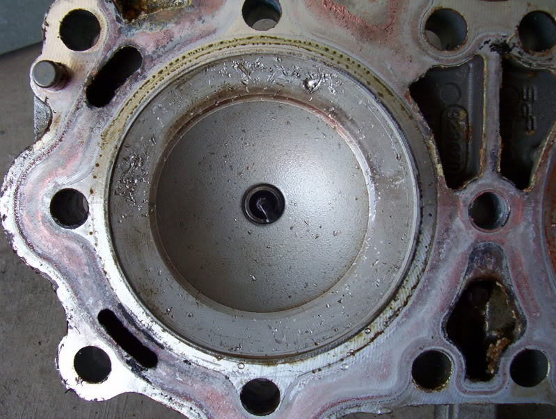

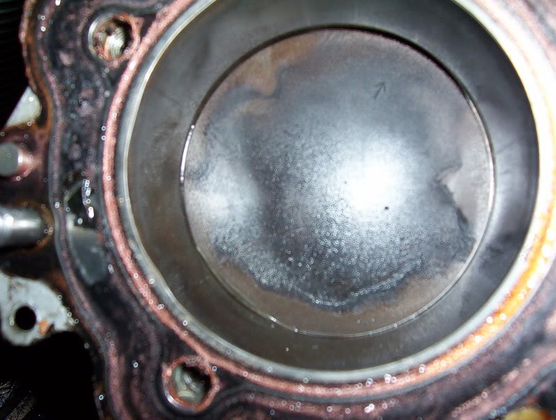

why is the damage so consentrated to that small area on the left side on both piston and head?? i got no idea what happened. something must have come loose from within the engine/exhaust/ intake at the end scince i had about 4 short runs before it stop firing in that cyl.
there seemed to be a little water on both cyl i dont understand why. and what about those irregular burn marks on top, is that normal?
would the dings and dents cause preignition and detonation so bad that it could self destruct if i ride like that?

I would pull the jugs and replace that piston. It could crack. The head is OK, unless it twisted.
