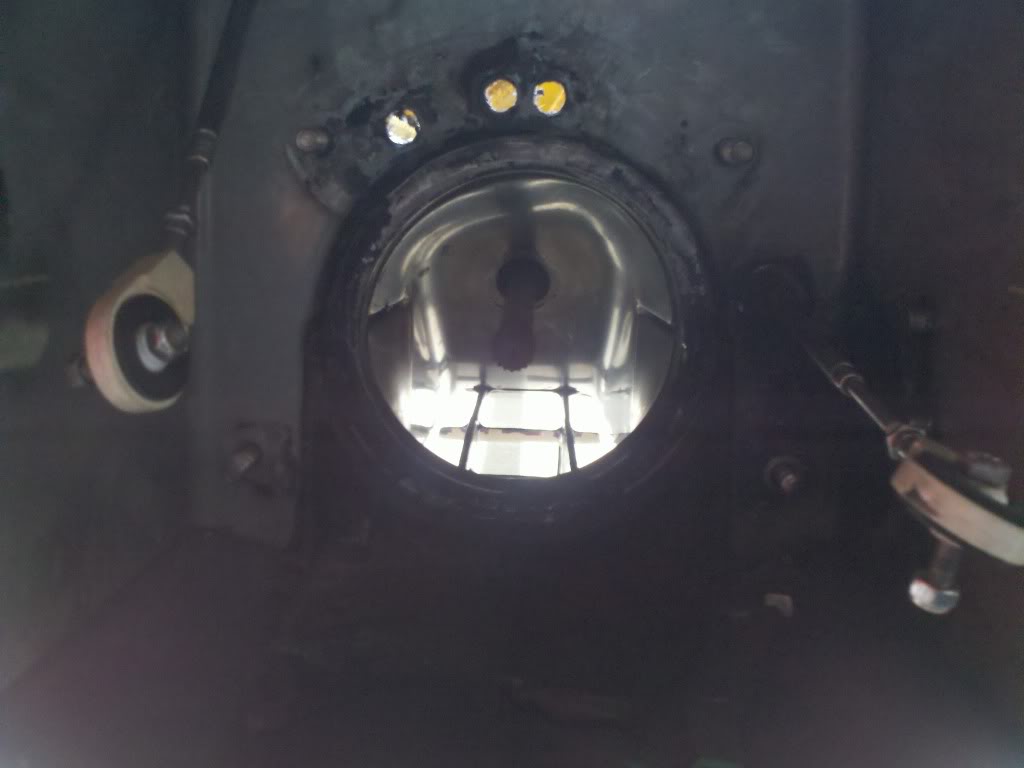

i am no genious but, i looked inside of the jet pump this evening and the wear ring had a VERY big gap between the ring and impeller. IIRC from some of my reading, there should be no more than .040" gap between the two. i can see with my naked eyes about .25" :banghead::banghead: it also looks like a small animal has been chewing on it a lil.
i rode the ski the past two weekends and it did seem slow to level out and take off with me (290lbs) and even slower with me and my fiance, i had to stand up and lean over the handlebars till we got up to speed. with just my fiance on it, she seemed to enjoy it just fine.
i have never owned a ski, and this is my first, this is also the first ski i have ever rode in my life. so, i assumed i just bought an underpowered ski and i needed to just get used to it.
its not as slow as i make it seem, it tops out fine (40-45mph) it was just a lil slow out the whole and bounced off the rev limiter alot taking off.
here are some pics. lemme know what you think.
please
i am obviously gonna change it. but seeing how bad it is, am i gonna see a noticable improvement after i fix it?
should i go ahead and buy the whole pump rebuild kit while i am at it?
i have heard mixed reviews about doing an aftermarket impeller and i dont know if it will be worth it.
does anybody know where there is a DETAILED how to on replacing this ring?

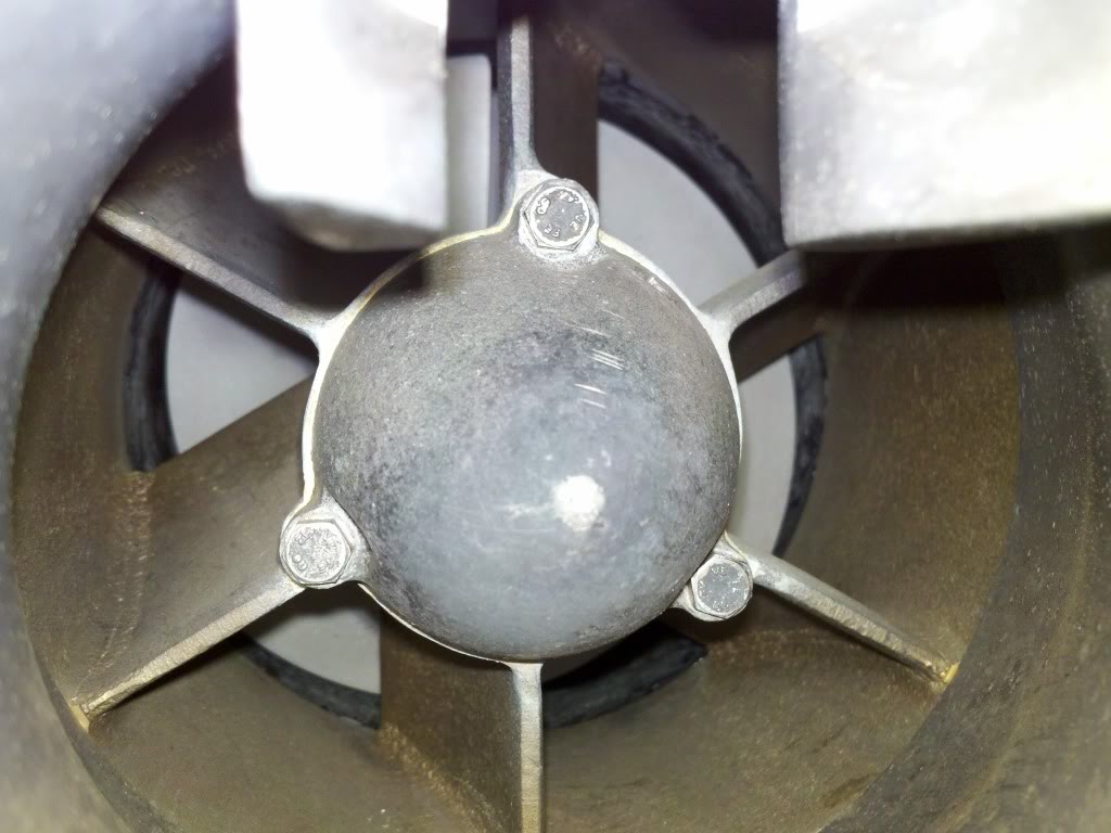

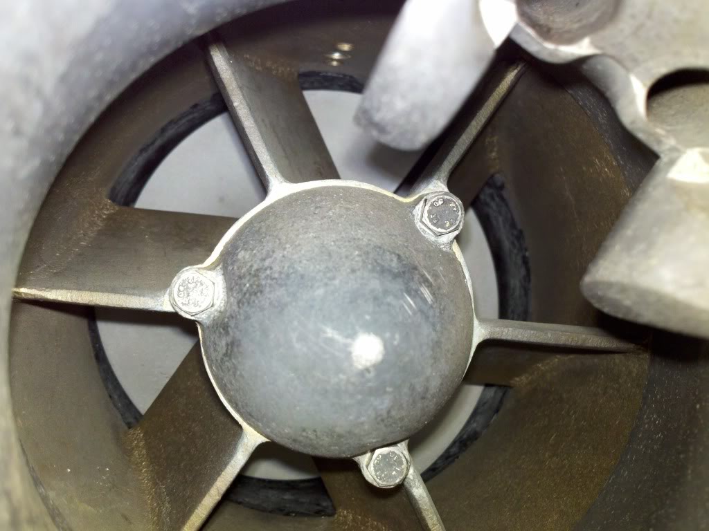

I would pull it and pop the cone off....if its just oil the bearings are usually fine. if it had water in it and/or rust its time for a full rebuild.
Make sure to order a new OEM O ring for the cone. I personally use Amsoil marine gear lube for its resistance to mixing with water and a quart costs less than a pint of the seadoo crap.
Just doing the wear ring will be a night and day difference, but a new aftermarket prop and a new wear ring?? Absolutely AWESOME feeling. Its like adding 1500 tires to your car. The hook up and acceleration are SICK! Even on your big old 580 machine...
yep thats what you need...and it a decent price for a brand now one. I cant remember, cut I think they may come with a prop tool too.

got some good news and some bad news. i got everything out and WOW that black silicone is a BIOTCH, i almost gave up trying to get the pump off cause it was stuck sooo bad.
when i did finally get the pump off the driveshaft came out with it. i carefully slid the driveshaft back into place and i hope i didnt mess anything up. i didnt think it was supposed to slide out like that. Did i mess it up??
so i popped the cone off and this is what i found
good and CLEAN, no rust and full of BLACK old oil
i think i will leave them alone and just replace the oil.

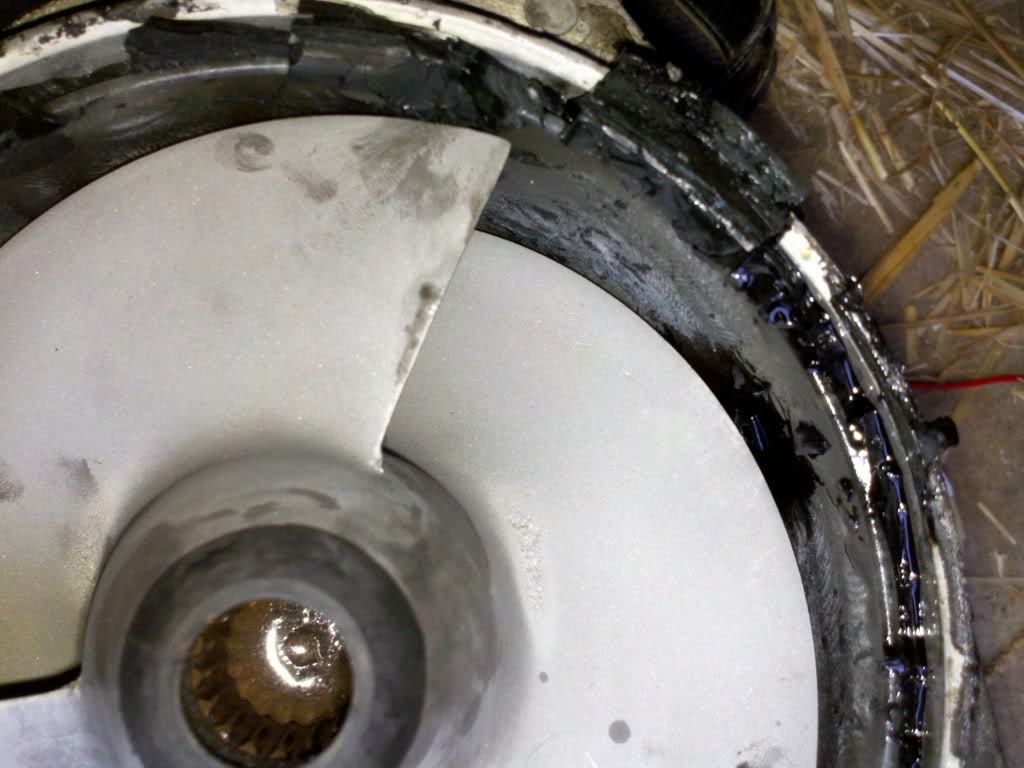

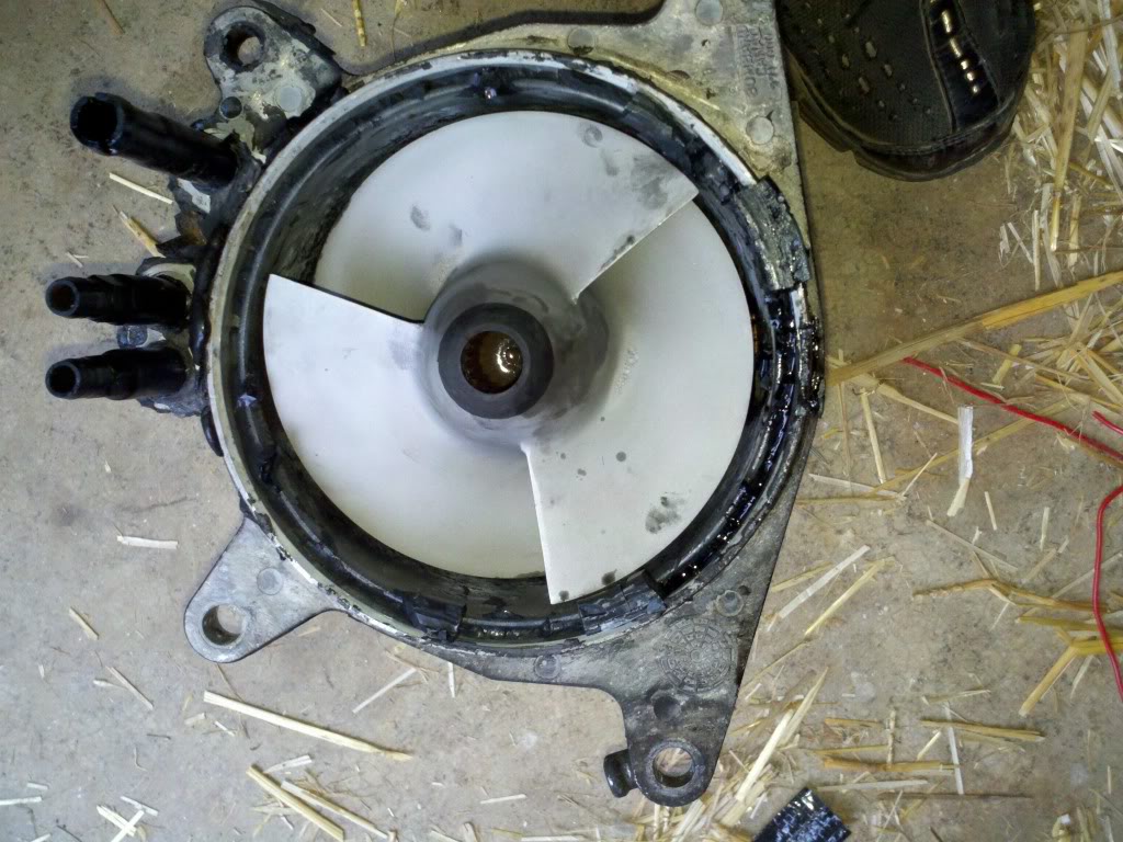

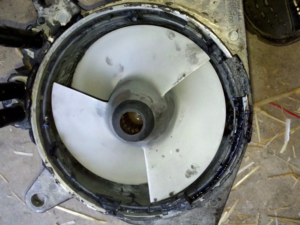

so after all the struggling. i finally got the damn pump off. look at all the silicone everywhere. that is all silicone and wear ring pieces, NOT OIL.
so i got the pump off and flipped it over. WHERE IN THE HELL IS THE WEAR RING????????? ITS GONE!
all that was left was the lil chips leftover that were stuck in the silicone. so what do you think? should i just leave the old ring in there? lol

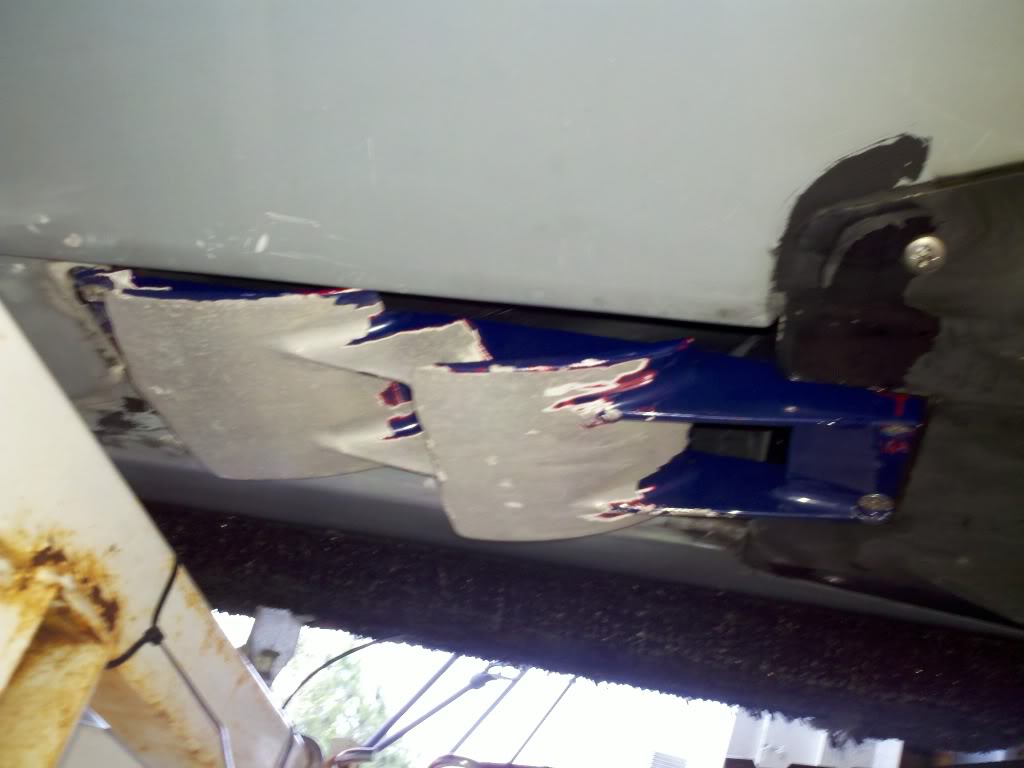

also, just for shits and giggles. i took a pic of the intake grate. it looks blue. does it look stock to you?

Nope thats an aggressive aftermarket intake grate...Old school worx.

On the Silicone jsut scrape it as clean as possible. On the circle part you will want to clean that all up and put a new neoprene seal on there. Seadoo quit making them, but aftermarket is available ( they kinda suck)
use black RTV and it only needs to be around the tubes....no where else.
On the driveshaft pull it out and inspect both ends for bad wear. Make sure you have two good rubber s on each end of the shaft.
I put a little grease in the nose of the prop before installing it.
did i screw anything up when the driveshaft came out?
also, is the marks on the inside of the pump a problem even though the wear ring will cover them up?
so finding out more and more about this ski. i will add the worx intake grate to the list.
ocean pro f.a., dual carbs, ocean pro head, decker stainless exhaust, worx intake grate, and now im adding the solas impeller + wear ring.

No, you did not hurt anything by marking up the inside of your pump casing. Like you said, the wearing ring will cover it. Just be careful not to make too deep a gouge.....
Actually looks pretty typical. Its hard to believe but that nasty oil could be the original from the factory, that's what they used. Be sure to use a new "O" ring on the cone when your reassemble, I also use 75w90 Mobile 1 LS gear oil.
I like the intake grate, I'll bet when you get back to the lake the ski is going to turn on a dime.

No you didnt screw up anything...in fact as I said take it out and inspect it..and make sure the rubber nubs are on each end of the driveshaft.
Luckily you already took it out so you know what it felt like before...You will not believe the night and day difference.
Now...once its all together...TAKE CARE OF IT!!!! Whenever you beach the ski, then pull it back out to ride MAKE SURE to lift and lower the back of the hull. It forces water in and out of the pump and will wash out most of the sand and stuff that opens up the clearance.
