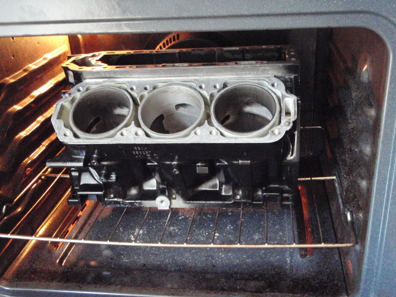

Why no shade-tree??? That's what this board is all about. Heck... I set the new cyl sleeve in my Merc, right in my kitchen oven.
I think you're going to need more than just a pair of Kleins and a set of nut drivers to do this job right, LOL. Nice oven, show us your maytag parts washer?
