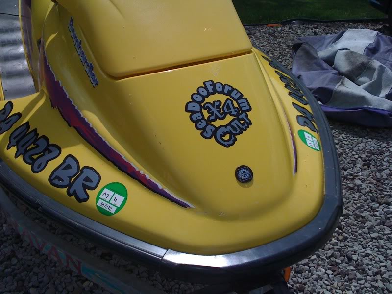

just a suggestion, may look kinda cool if you put that symbol that is between the sea doo on all the skis.
Huu? Not sure what you are asking. On mine... it's a dot.

I also made a few new decals. I scrapped off the old purple hull numbers, and replaced them with my own. I also gave the ski a name. Scurvy Dog 2.
Sorry for the bad pics... but the sun was bright, and it washes out my phone camera.
ya thats what i meant the little dot thing, but it would prob only look good i guess if the sea doo was had the a and the d how they have on the ski..... looks good tho man when are you taking your first ride? let us know how it goes.

I have Black, Silver, White, Yellow, and Teal sitting here. I can make the stickers in any color you want, but if it's a color, other than I listed... it will take me a few days to get a roll of vinyl. It's not a big deal... I just won't be able to ship it until Tuesday/Wed.
The 2 color stickers will be sent as 2 stickers. To install them, you will use the wet method, so it can be positioned correctly on your ski.
THE WET METHOD....
get a spray bottle, and put a few drops of dish soap in it, and top it off with water. (very little soap is needed) Spray the surface you are going to install the sticker. Gently place the sticker on the surface, and when you have it in position, use a squeegee, and smooth the sticker down. (this will also get rid of all the air bubbles) Once you've squeegee'ed out the extra water, remove the mask. A squeegee can be made out of an old Tupperware lid, or any flexible plastic.
To add the second color... wet everything again (including the mask of the second color) and lay it over top of the first color. You should see the fist color though the mask of the second. Line it up, and squeegee it down.
The wet method works very well, and allows you to position the stickers without it sticking to the hull.

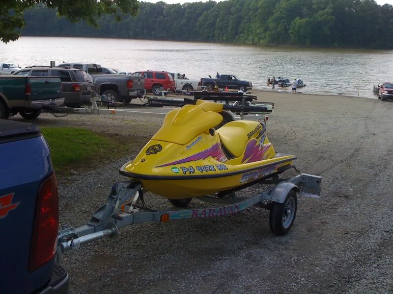

So... I gave the X4 a shake down today. I was only out for an hour or so... but it was a good time.
Since the ski had been sitting for years... I backed the trailer into the water, and fired it up, just to make sure the water was pumpping. Once I had water at the piss hole... I gave the throttle a blip... and it seemed to respond.... so, I took it off the trailer, and parked the truck.
Once I got back to the water... I pushed off, and gave the starter a go. It re-started instantly !! I idled out past the no wake zone... and eased onto the throttle. It reved up nicely... and after tooling around at 30 mph... I mashed the throttle down, and the 800 came to life.
That ski is very fun to ride. It wouldn't be worth a dam for a destination type ski... but for cutting a corner, jumping wakes... and general hooliganisums... it's a good time!!
